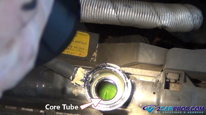

The second way a radiator can fail is to become plugged internally. To check for this condition, remove the radiator cap when the engine is cold look inside using a flashlight. You may need to drain some of the coolant out to see the ends of the radiator core tubes. In the example below the tubes appear clear with no corrosion around the end which is what you want. When a radiator plugs internally these tubes become clogged due to lack of maintenance (radiator flush) calcium will then stop the coolant flow which inhibits the radiator's cooling ability. This condition generally occurs gradually over time and will be more noticeable when climbing a grade or in warmer weather. The third way a radiator can fail is to leak. This will cause the system to lose coolant and cause overheating. In either case the radiator must be replaced.
radiator core tube
