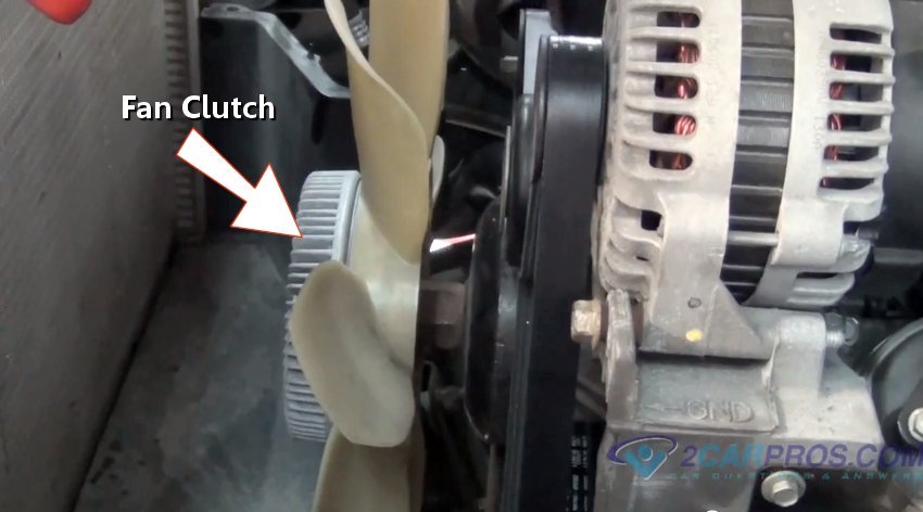

There are primarily two types of engine radiator cooling fan, electric and manual. A manual fan is connected to the engine drive pulleys and is controlled by a thermo fan clutch which senses radiator heat and engages when the engine is running at higher temperatures. These thermo reactive clutches are constructed to "freewheel" when not in use, and become connected using a silicone grease which expands when heated. This unit uses a set of shaft bearings and seal to retain lubricant and are normally bolted to the water pump of the engine. A clutch fan can fail one of two ways, it can either lock up causing poor mileage accompanied by a whirring sound, (like a small airplane is taking off.) Or the silicone grease can leak causing the fan to "freewheel" while failing to pull air through the radiator.
fan clutch
