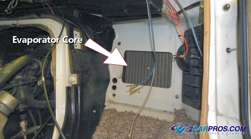

3. Evaporator: Located inside the HVAC plenum and is where the high pressure refrigerant is released to create the cold air. The blower motor forces air through the core and out through the air vents.
evaporator core
