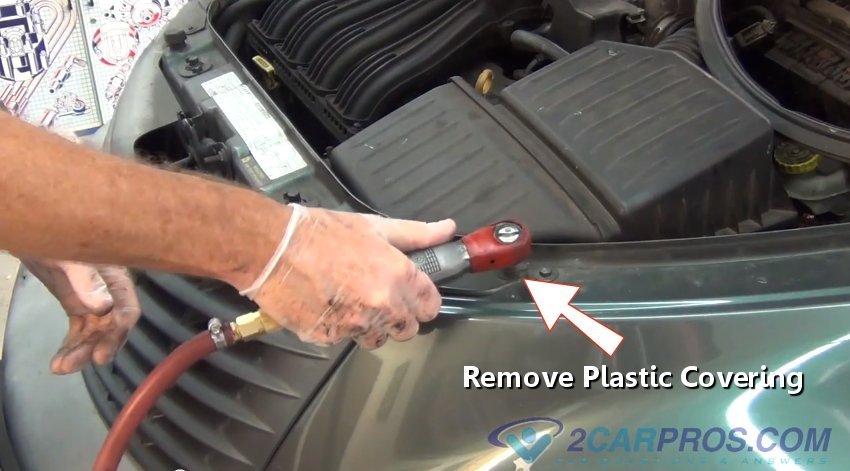

Loosen mounting bolts or clips to remove any plastic shielding that will inhibit the replacement of the cooling fan.
remove plastic covers

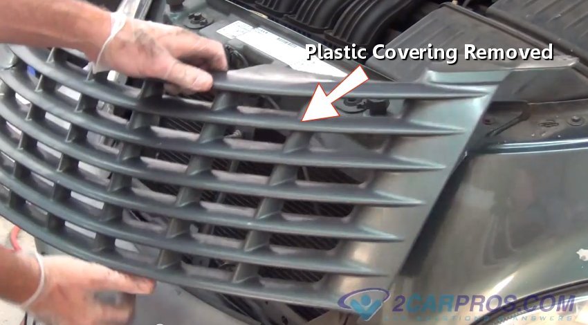

Once all mounting bolts have been removed, lift the plastic covering from the vehicle.
plastic cover removed
