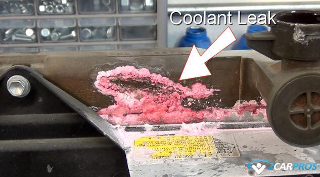

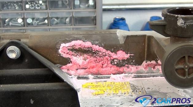

1. Radiator: The radiator is the number #1 item to have a leak due to it's surface area and construction. This unit is made of a thin aluminum tubing core with plastic collector tanks on either side which are prone to leakage, most of the time using a flashlight can detect a leak. When this problem occurs it will sometimes leave signs of dried coolant as in the image below:

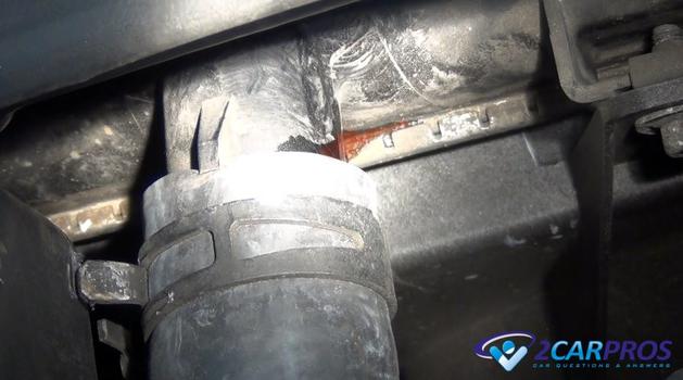

2. Hose Clamp: A hose clamp can break, become weak, or not be installed correctly which will cause a leak. Depending on the problem with the clamp it can be replaced or simply repositioned squarely on the hose. Also, sometimes a radiator hose will not seal well due is corrosion under the hose or the hose clamp being not positioned correctly.

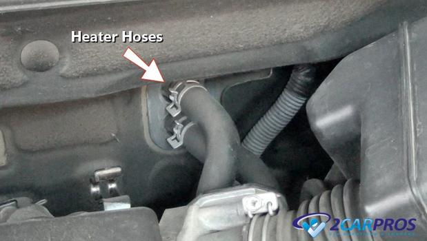

3. Coolant Hoses: Radiator and heater hoses have a high failure rate due to there operating conditions and construction. These rubber hoses are subject to heating and cooling cycles that can deteriorate the composition of the hose which will cause a rupture, this failure will be obvious and will require the coolant hose to be replaced.

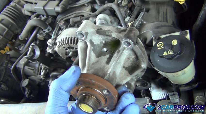

4. Coolant Pump: The cooling system water pump (coolant pump) is mounted to the engine block or timing chain cover and is designed to circulate coolant. This pump is designed with a main shaft seal which is used to prevent coolant from leaking from the pump housing, when it fails it allows a leak from the pump's weep hole which is seen in the image below. At this point the water pump must be replaced.
