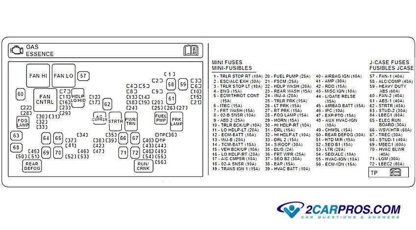

The lid or cover of the fuse panel will in most cases have the fuse and relay identification illustration depicting what the fuse controls and which amperage it should be replaced with if blown, or popped as some say. Here is what a typical fuse and relay legend looks like.
fuse panel diagram
