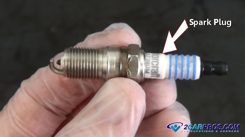

A spark plug must be properly gapped with a specific measurement from the electrode, a misadjusted air gap can result in a misfire.

Using a proper spark plug with a correct air gap will help ensure operation of the ignition system.

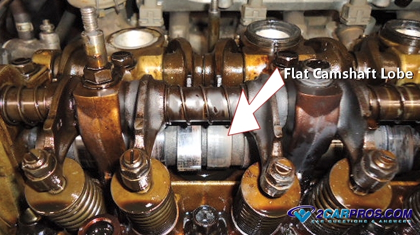

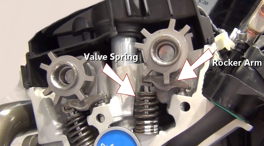

Each intake and exhaust valve utilizes a spring which will return the valve to its original position (closed). If a valve spring has broken or a cam lobe has worn down, it will cause the engine to misfire and run rough due to the loss of compression. These conditions don't always show up in a compression test, because a compression test is performed at engine cranking speed. If a camshaft lobe is halfway worn down, it will show up only when the engine is running and under load.
flat camshaft lobe
 In some conditions a broken valve spring can effect different aspects of engine performance for example: If just a small part of a coil breaks off, the spring can still close the valve but only at low RPM's, causing a high RPM misfire. If the spring breaks somewhere in the middle it will affect both idle and power conditions. To test for this condition, remove ignition coil connector or ignition system or fuel pump fuse to disable the engine from starting. Remove valve cover(s) to gain access to visually inspect the valve train. Inspect the condition of the valve springs, use a flashlight and small mirror to aid in the inspection. Have a helper crank the engine over while observing rocker arms and cam lobes, confirming full movement, if one or more lobes are traveling less than the others the camshaft has a flattened lobe and replacement is required.
