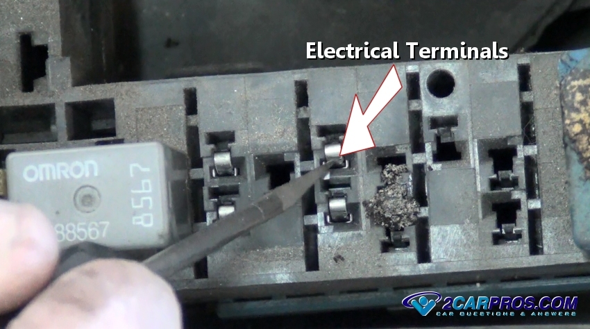

Once the relay has been removed, inspect the relay terminals for signs of extreme heat or corrosion.
inspecting relay terminals
The relay is mounted in four electrical terminals housed in plastic and when overheated (due to overload or resistance caused by a poor connection) can distort and melt.
inspecting terminals

Use as small metal scribe or tool to scrape clean any corrosion to ensure a good connection once the new relay is installed.
clean terminals
