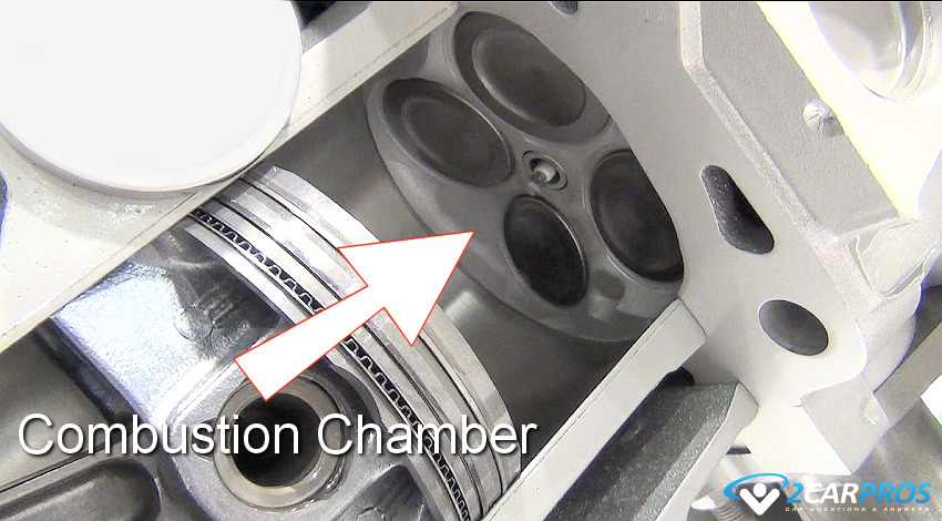

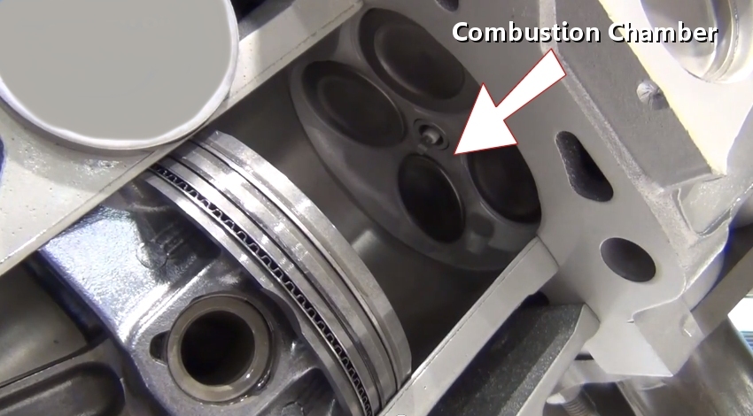

1. Combustion Chamber
The combustion chamber is where the magic happens and is the "end game" of the cylinder heads purpose. This is where the fuel air mixture is combusted to converter the kinetic energy into linear motion via the engine piston and crankshaft.
automotive engine cylinder head combustion chamber

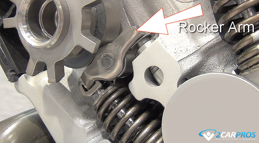

2. Cylinder Head Rocker Arm
A rocker arm is used to open and close the intake and exhaust valves, in most overhead camshaft, and in all in-block camshaft configurations. You can see the valve lifter and valve spring as well, (positioned at opposite sides) with the camshaft above the rocker.

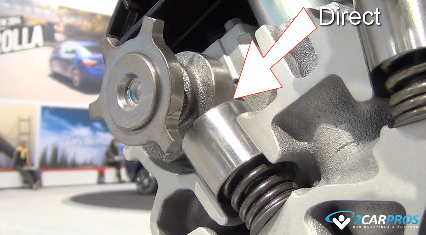

4. Direct Valve Configuration
This is what it looks like when the valve is placed directly under the camshaft with no valve train. The valves are placed directly under the camshaft to minimize moving parts and achieve higher engine RPM's.

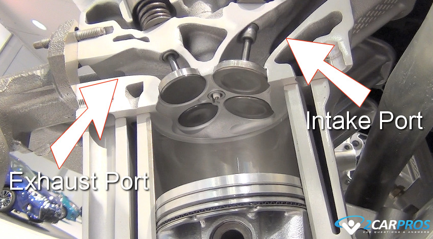

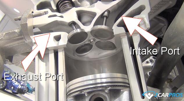

5. Intake and Exhaust Valves/Ports
Intake and exhaust valves and ports are designed into the cylinder head to help allow the intake charge enter the combustion chamber, and post combustion, for the exhaust gasses to exit the engine.
automotive engine cylinder head intake exhaust ports

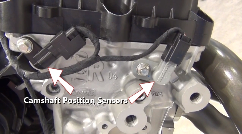

8. Cylinder Head Accessories
A cylinder head also supports a host of accessories such as:
  • Fuel injectors
  • Temperature sensors
  • Camshaft position sensors

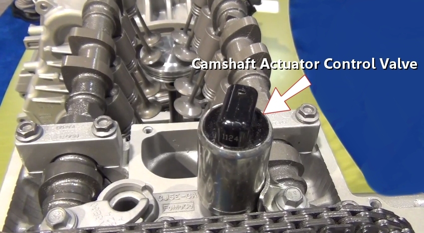

  • Camshaft actuators
  • Ignition coils

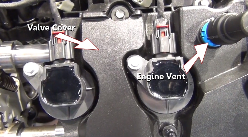

A valve cover is bolted to the cylinder head and is used to control oil leaks and internal crankcase pressures. This cover is sealed to the cylinder head using a valve cover gasket, a crankcase vent is also located on or near the cylinder head.
