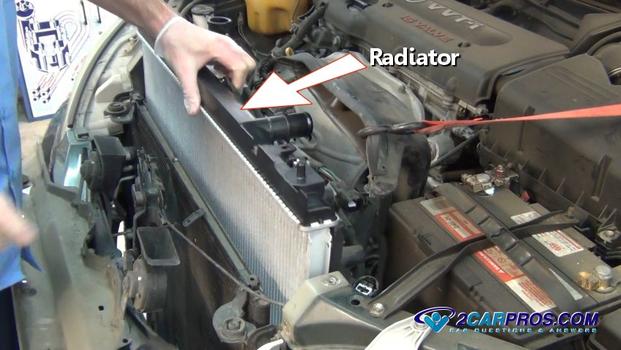

An automotive radiator is at the heart of a vehicles cooling system and keep an internal combustion engine from overheating avoiding catastrophic failure. Radiators are manufactured in all shapes and sizes, depending on the space constraints and requirements of the vehicle's design. A large vehicle such as a truck will have a multiple-row high capacity radiator while a small vehicle will have a much smaller radiator with less capacity.
radiator
There are two different styles of radiators used in the automotive industry; cross or top flow. A top flow radiator takes hot coolant and cools it as it flows downward. All radiators have small coolant tubes which have fins attached to them that act as heat syncs and dissipate heat through convection and air flow through the front of the vehicle or a fan pulling air through the radiator. The more fins per square inch, the more efficient the radiator is at dissipating the heat and keeping the engine cool.
top flow radiator

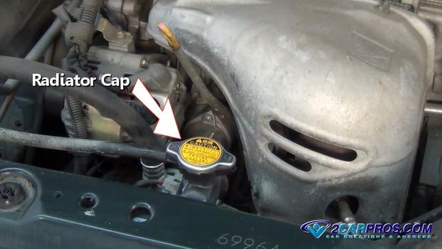

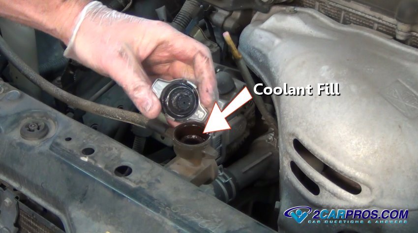

A radiator cap is used to add coolant to the system and it provides an inspection port for maintenance purposes.
coolant fill port

When adding coolant use a small funnel to avoid spillage. (Note: Always check coolant levels when the engine is cold.)
adding coolant
A pressure cap is used to maintain between 16 and 18 psi within the system to further aid the cooling systems performance. For every two pounds of pressure inside the system the boiling point of the coolant raises one degree.
radiator cap

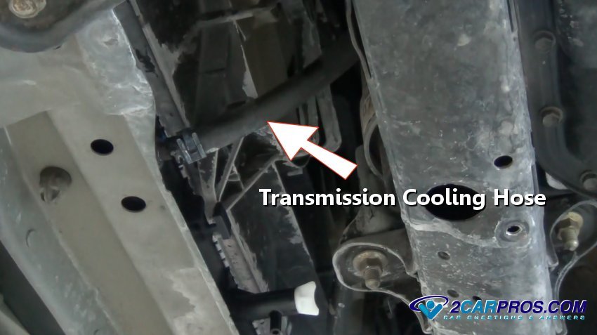

Vehicles equipped with an automatic transmission use transmission fluid cooling hoses (inbound - outbound) that connect to the fluid cooler built inside of the radiator.
transmission cooling hose
