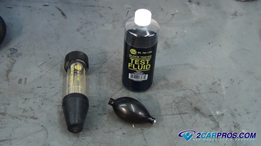

6. Chemical Test
1. Reinstall the spark plugs, for this test you will need a head gasket chemical tester which you can get from Amazon or the local parts store. This test will help measure the amount of exhaust gases inside the cooling system. Remove the radiator cap and then drain a small amount of coolant from the as to not contaminate the test fluid, (about 2 inches from the top of the radiator). This can be done by using an exhaust gas analyzer as well by detecting the presence of hydrocarbons (HC) in the coolant, indicating a blown head gasket.
exhaust gases chemical tester
2. Once the coolant has been drained down slightly, insert the test tube into the radiator filler neck, then add test fluid to the full line on the side of the tube.
chemical tester installed
3. Start the engine, while using the hand pump draw air inside the radiator into the tester, repeat this action about 10 times.
hand pump chemical tester
4. If the test fluid turns yellow exhaust gases are present and the head gasket is blown. If the fluid remains blue the system is most likely okay.
