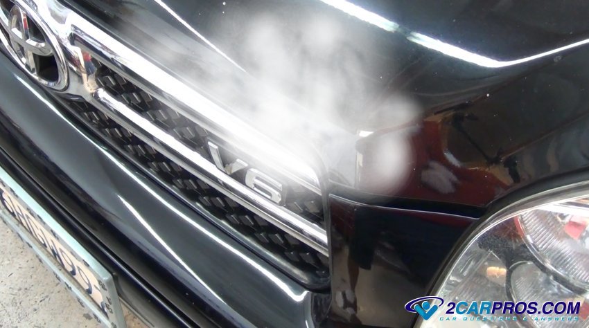

2. Steam will bellow out from under the hood, body line or grill at various times when the engine is hot.
steam coming from car hood

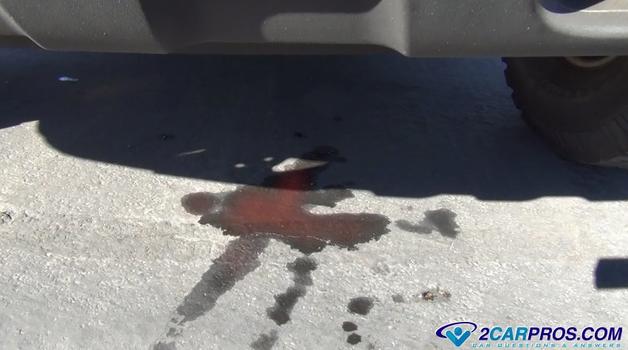

3. One of the most obvious signs of a coolant leak is a puddle of bright-colored liquid (green, orange, pink, or yellow) under your car.
