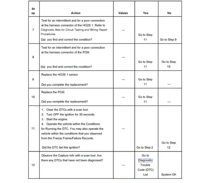

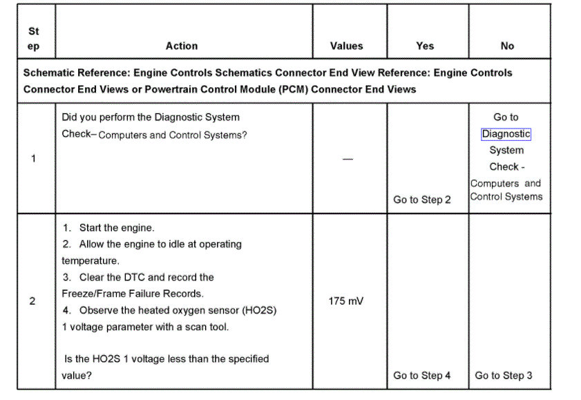

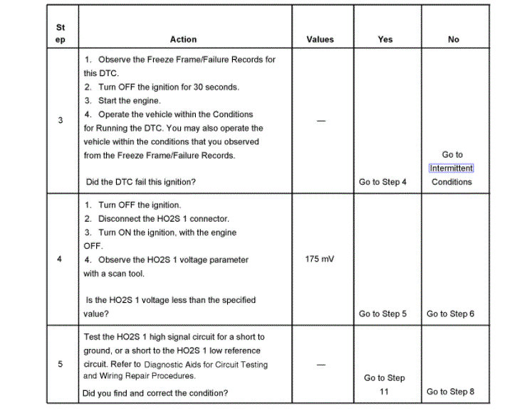

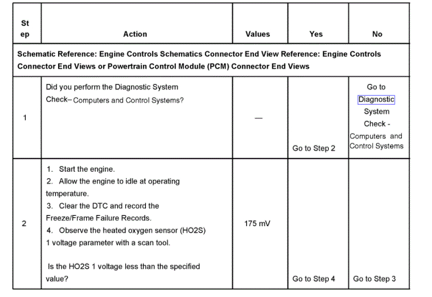

131 flow chart is below for you to follow.
Let me know the results of the testing.

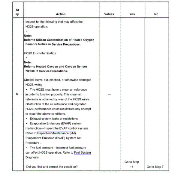

CIRCUIT DESCRIPTION
Heated oxygen sensors (HO2S) are used for fuel control and post catalyst monitoring. Each HO2S compares the oxygen content of the surrounding air with the oxygen content of the exhaust stream. When the vehicle is first started, the power-train control module (PCM) operates in an Open Loop mode, ignoring the HO2S signal voltage when calculating the air-to-fuel ratio. The PCM supplies the HO2S with a reference, or bias, voltage of about 450 mV. The HO2S generates a voltage within a range of 0-1,000 mV that fluctuates above and below bias voltage once in Closed Loop. A high HO2S voltage output indicates a rich fuel mixture. A low HO2S voltage output indicates a lean mixture. Heating elements inside the HO2S minimize the time required for the sensors to reach operating temperature, and to provide an accurate voltage signal. If the PCM detects that the HO2S 1 voltage remains below a calibrated amount for an excessive amount of time, DTC P0131 will set.
Each HO2S 1 has the following circuits:
A HO2S 1 high signal circuit
A HO2S 1 low reference circuit
A HO2S 1 heater ignition voltage circuit
A HO2S 1 heater low control circuit
A low reference loop circuit
CONDITIONS FOR RUNNING THE DTC
DTCs P0101, P0102, P0103, P0107, P0108, P0112, P0113, P0116, P0117, P0118, P0121, P0122, P0123, P0125, P0128, P0410, P0440, P0442, P0443, P0446, P0449, P1441 are not set.
The Air Fuel Ratio parameter is between 12:1-16.5:1.
The TP sensor parameter is between 3-35 percent.
The system voltage is between 9-18 volts.
CONDITIONS FOR SETTING THE DTC
The PCM detects that the HO2S 1 voltage is less than 140 mV for more than 30 seconds.
OR
The PCM detects that the HO2S 1 voltage is less than 600 mV during power enrichment (PE) mode for more than 10 seconds.
ACTION TAKEN WHEN THE DTC SETS
The control module illuminates the malfunction indicator lamp (MIL) on the second consecutive ignition cycle that the diagnostic runs and fails.

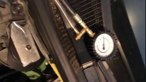

I measured fuel rail pressure on the fuel pressure test port, and image result is attached: when turn key on the ignition without turn on engine indicated about 40 PSI, and when turned key on start engine at idle was more than 55 PSI, and then decreased to 50 psi and reached to 48 PSI. After stopped engine pressure decreased to 0 PSI. What is standard fuel line pressure on the vehicle listed above? And RPM increased 2,000 rpm's to 3,000 rpm's and down to 1,500 rpm's. I do not know standard fuel line PSI. If the EGR system is not able to recycle the engine gasses right, that caused too much gas injected to engine and cause multiple misfire and created P0300? If ERG valve works normal can decrease the RPM?
I replaced throttle body sensor, idle control valve, but did not replaced ERG valve. I want to clean ERG valve first and test run, if not work buy new one.

The fuel spec is 52-59 with the engine running.
The fact it drops to 48 pounds tells me the fuel pump is the issue with misfire code.
https://www.2carpros.com/articles/how-to-replace-an-electric-fuel-pump
The 131 code may be related to the low fuel pressure. It could not adjust the fuel mapping so it coded for it.

Correction: After bleed air the pressure decreased zero, but not when stopped to zero, and bleed line did not got gas, gauge adapt line got gas when released adaptor from pressure test port.

I tested again for fuel line pressure: when turned key on ignition without start was 45 psi; turned on to ignition and start engine, was between 58-59 psi about 10 seconds, then decreased to 55-54 psi, and became 53 psi, and then kept on 52 psi on idle state without running, and the rpm was 1,500 rpm's, and decreased 1,950 to 1,000 rpm's, then decreased to 500-650 rpm's. So, fuel pressure looks normal. Engine vibration is decreased but still vibrates but didn’t get engine service soon light.

What is the pressure at idle with the engine running? You did not state that pressure, just with the engine off.

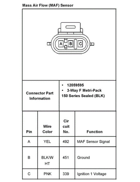

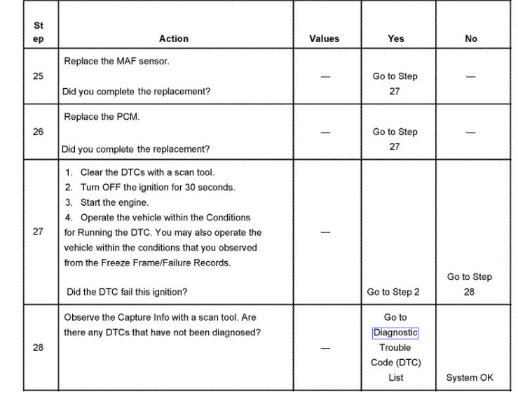

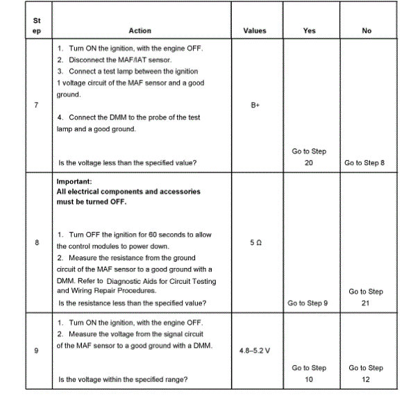

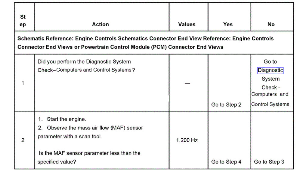

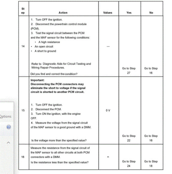

Idle state fuel line pressure was 52 psi. There was change engine oil light turned on while there was 19% oil life still remained before. I changed oil, and I started engine and road test. And got code p0300 and p0101. I replaced MAF sensor, after erase DTCs and just slowly running around 30 mph, and p0300 and p0101 both gone, but caused p0102 (FSC/Current) (MAF sensor circuit low frequency). After erase code p0102 the idle rpm increased from 1,500 rpm's to 2,000 rpm's at idle. When change gear to R or D, RPM decreased to 1, 400 to 1,500 rpm's. I erased code, and run again and caused p0102 code. Now P0300 and p0131 was cleared. The tow code was cleared by replace MAF sensor. But how p0101 changed to p0102? Thanks for your review and instruction!
Friday, September 4th, 2020 AT 11:21 AM

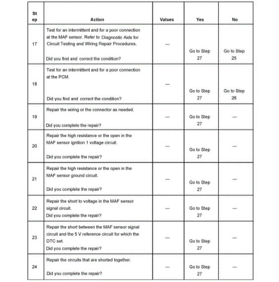

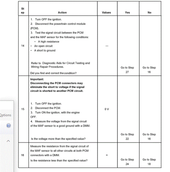

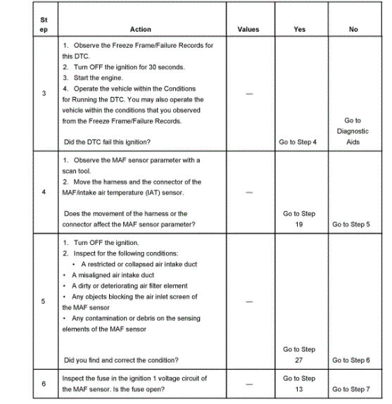

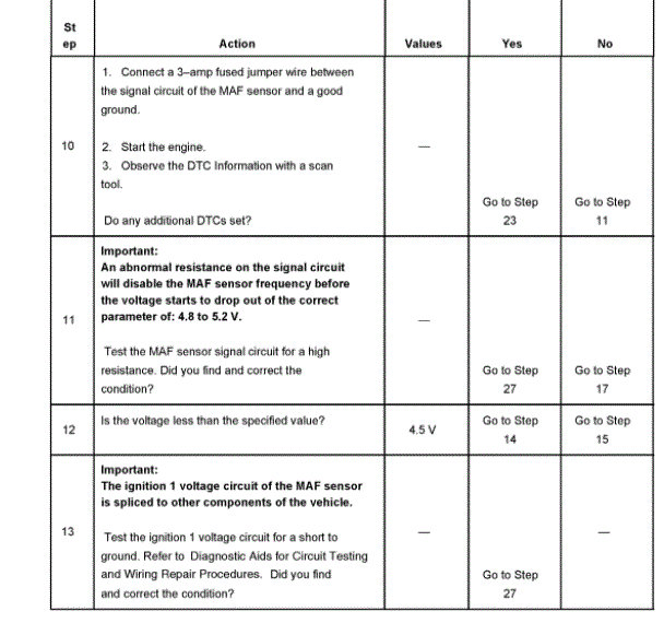

Okay, first, why are you erasing codes? That does nothing at all.
Check the hose from the mass air flow to the throttle body and make sure it does not have any rips or tears.
https://www.2carpros.com/articles/how-to-replace-a-mass-air-flow-sensor-maf
I attached the flow chart for you as well. Let me know what you find.
I also attached the connector diagram for you as well. Verify voltages to the connector.
The connector is a common failure.
The other codes will most likely return as clearing will not work until diagnostics and repairs are made.
