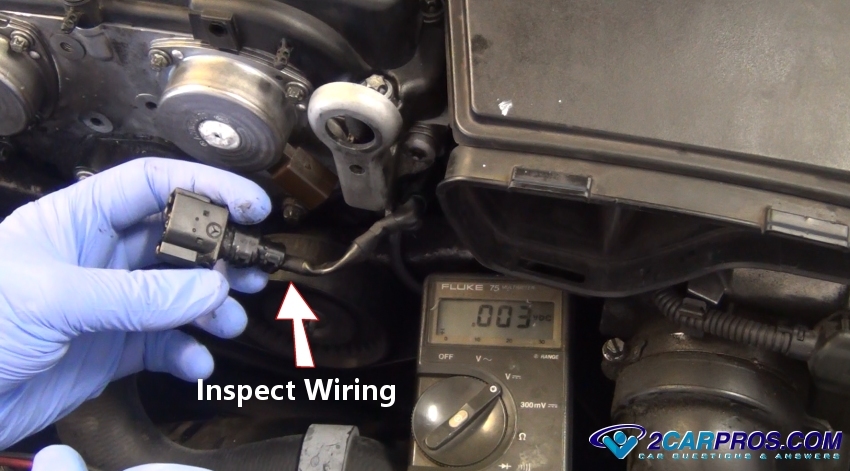

We are using a camshaft position sensor problem for this example, the sensor has already been replaced but the "circuit open" code returns. Remember, this guide can be applied to any part of the electrical system. The image below shows the sensor and connector with the voltmeter ready for testing. Disconnect the connector from the sensor and check the wiring at the base of the connector, this is a popular place for the wiring to break. Also, look for corrosion or damaged pins as well.
inspecting wiring
Most sensors or devices such as fuel injectors in a computer system are supplied power from the computer called reference or supply voltage which is between 5 to 12 volts in most cases. Turn the key on and ready the voltmeter (how to use a voltmeter). With the ignition key on, switch a voltmeter to DC voltage. Then touch the negative lead to a good ground source. Use the positive lead to probe the connector terminals, you should be able to find system voltage (This can also help see if the computer system itself has power). If no voltage is observed you may have a simple problem such as a blown fuse. If voltage is present that part of the system is working.

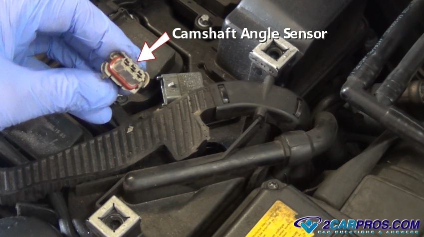

For this step it helps to have a wiring diagram but it is not needed. All computer wiring is identified by specific wiring color code such as, yellow and green yl/gn which means yellow with a green stripe. The color mentioned first is the main color of the wire followed by the tracer color which will be a small line on the wire. This color code will be the same from the sensor to the computer. In this example we will use the camshaft angle/position sensor. This is a three wiring sensor, one wire is used for sensor power, the other two go directly into the computer for sensing purposes. Once system power is confirmed with the key on, the next step is to test the connection between the sensor and the computer which will find broken wires.
camshaft angle sensor connector
Identify the connector wiring colors, you may need to strip the wiring cover back to see the individual colors. These are the wires you will be looking for at the computer ECU (engine control unit).

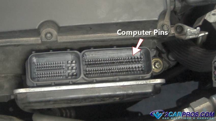

This will expose the connector pins which will be used for testing purposes. While the connector is off check for the presence of engine oil which sounds kind of weird but it has been known on high mileage engines that oil will seep from the sensors, down the wiring and into the computer itself, like little rivers of oil. If enough oil has been pushed into the computer it can short out the internal components, even though oil doesn't conduct electricity it will saturate compounds which make up the chips, resistors, capacitors and diodes causing them to fail. These connections must be clean and free from dirt, oil, rust and corrosion.
computer connector pins
Computer's connect to the wiring harness using pins which attach to the various components and to the motherboard inside the computer. Once the main connectors have been removed check the pins for rust or corrosion and clean as necessary. It's a good idea to spray electrical cleaner across the terminals and on the connectors.

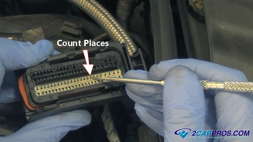

To make sure you are testing the correct wire count the places in the connector from one end or the other, in this case it is 8 places. This is so when you turn the connector over you know which terminal to test from.

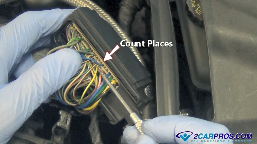

Now turn the connector over and count from the end that you referenced. This will be the terminal used for testing.

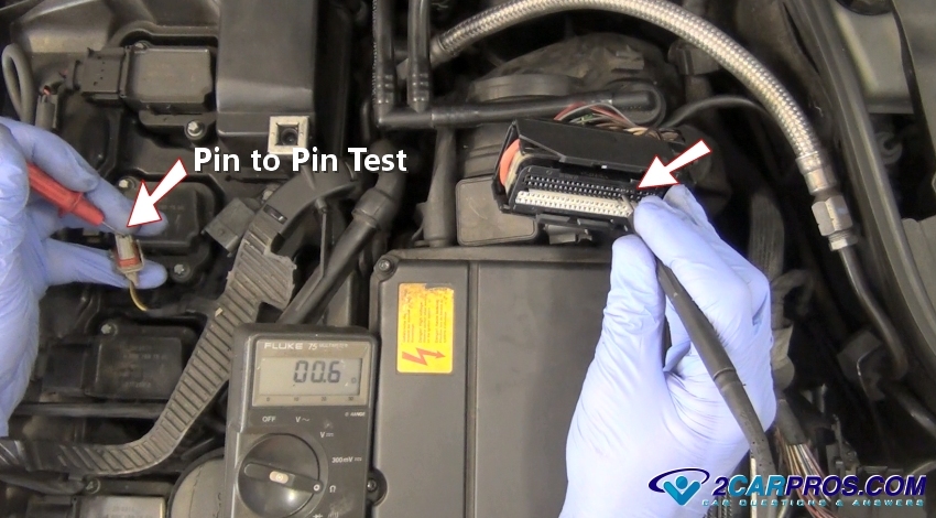

Now, take your voltmeter and switch it to ohms. This will test the resistance in the wire if any, the idea is to have 0. Connect the probes to either end of the wiring connectors, the meter will show the resistance in the connection. In this case the reading is .6 which is next to nothing and acceptable so the wire is okay. (When testing roll "twist" the test leads in the terminal to ensure proper connection for a correct reading). If the ohms reading is above 1.5 there is a problem with the wire and it needs replacement. This is called a pin to pin test. When testing try and wiggle the wires around while holding the test leads steady, this will simulate engine vibrating which can help find intermittent shorts, you might need a helper for this. (While performing this test one of the wires in the circuit was found to be bad, replacement of the wire fixed the problem). pin to pin test
