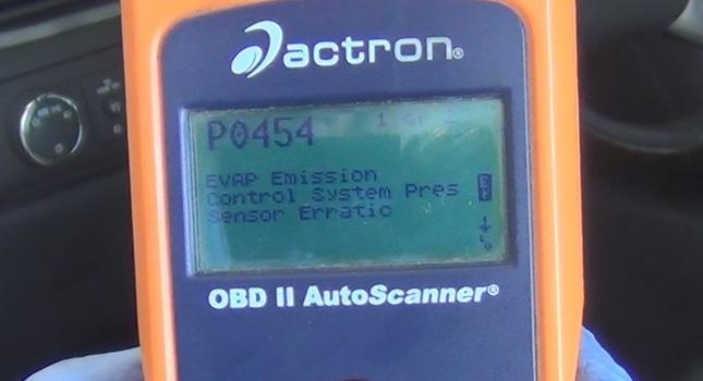

When any part of the system becomes compromised by a torn vacuum line or shorted control solenoid the PCM detects a problem and delivers a trouble code that pertains to the section or system part having the issue. A code reader scan tool is used to access the computer memory and deliver the code such as a P0454 which is the case in the video below. Gas caps have a high failure rate due to usage and can be the culprit as it completes the seal each time you fill up.
