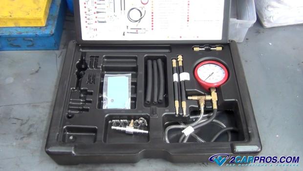

Remove the fuel pressure test gauge from the kit. Most gauges have a quick disconnect coupler that will allow several different adaptors for various manufacturers. The kit should have them labeled but if not look for the hose connector or fitting that will work for your car.
fuel pressure gauge
