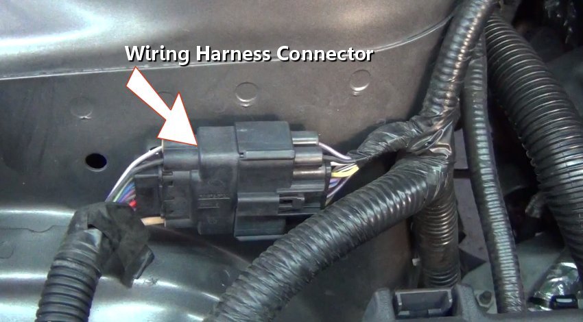

A wiring harness has many connectors that can serve as an extension to the main harness which allows routing to devices which are located beyond the reach of the main harness.
wiring harness connector

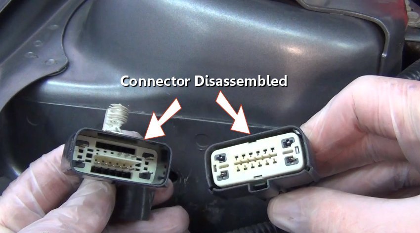

Connectors are disconnected by depressing a small tab on the side of the connector. Once apart the male side of the connector is designed with terminals that protrude outward which fit into sockets on the female side. Electrical or wire connectors can vary from a single terminal to many terminal depending on the application. Wire and connectors vary in size due to different amperage loads for each circuit.
connector disassembled

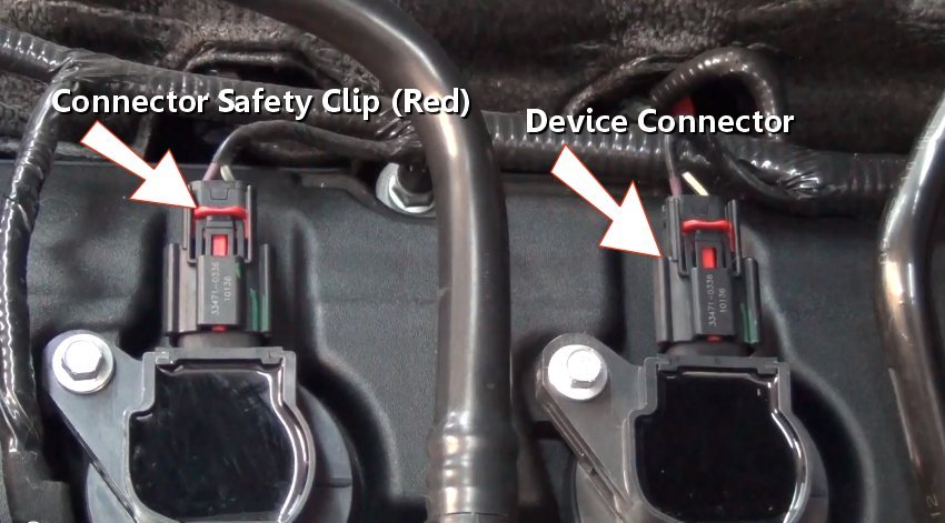

A device connector is used to connect to a particular item in the electrical system such as ignition coils which are shown in the image below. A safety is used to securely attach the connector to a device which adds an extra layer of protection from accidental disconnection. This safety clip must be removed before the connector can be released.
device connector safety

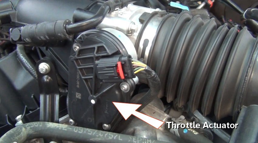

An electronic throttle control actuator is responsible for metering air flow into the engine which controls engine speed. A throttle control sensor located near the foot pedal supplies feedback data to the computer which activates the actuator. The throttle control system is integrated into the ABS, cruise control and traction control systems. In older vehicles throttle action was performed by a manually controlled throttle cable which is actuated by the driver's right foot.
throttle actuator

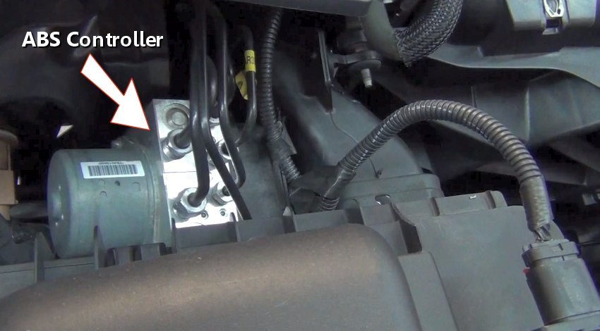

The anti-lock brake system controller is an electronic system that helps prevent the wheels from skidding in panic stop and is integrated into the traction control system.
abs controller

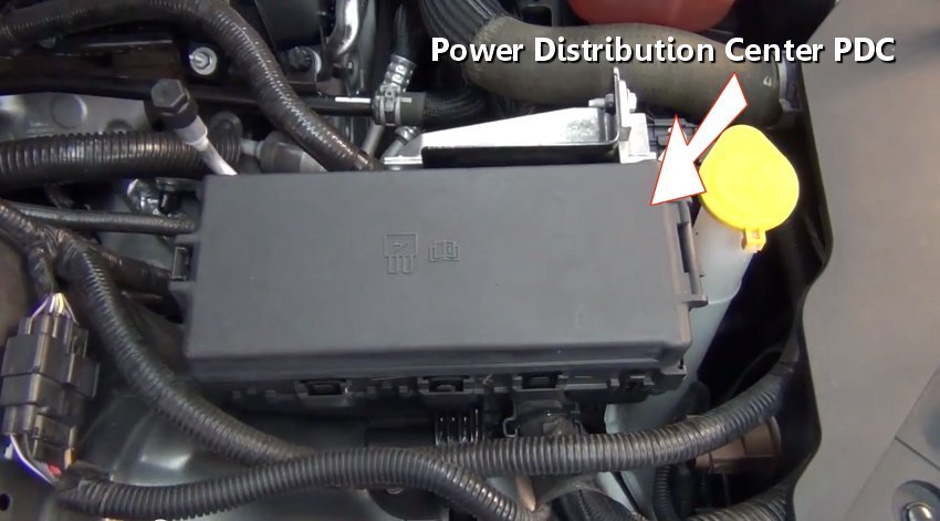

A power distribution center is used to route positive battery power throughout the vehicle using relays and fuses. This center is powered directly off of the positive post of the battery using a positive battery cable.

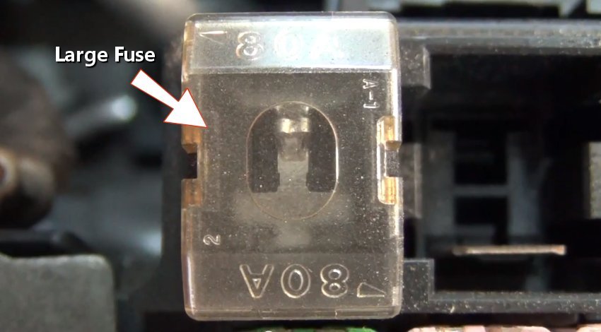

A set of large amperage fuses protect high amperage circuits such as the cooling fan, starter solenoid and headlights. A observation window is provided to inspect the fuse's condition.
large amp fuse

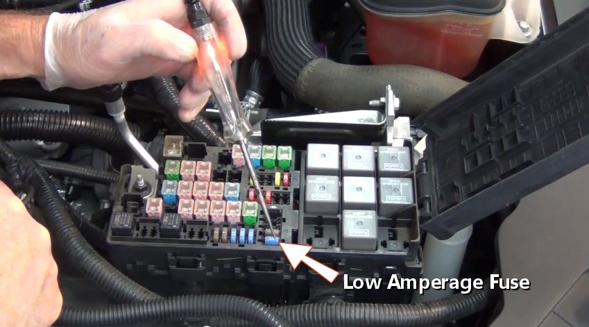

Finally low amperage fuses are used to protect smaller amperage circuits such as tail lights and interior lighting. These fuses are easily checked using a test light.
low amp fuse

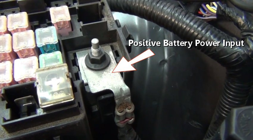

The battery supplies both positive and ground circuits which complete the electron cycle. The positive side of the system circuit starts at the PDC provided by the battery.
positive battery power input

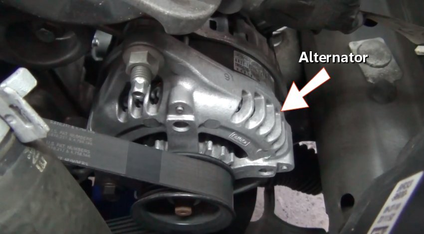

Thealternator is powered by the engine connected by a serpentine belt. This unit creates electrical power by utilizing a magnetized armature and outer copper windings which are connected to the battery using brushes. While in operation (engine running) this unit supplies electrical power for the vehicle while charging the battery at the same time.
alternator

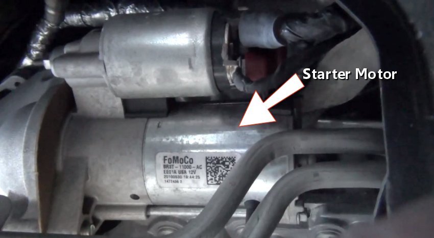

The engine starter motor is designed to turn the engine over when the ignition switch is activated. This device pulls the most amperage of all components encompassed within a vehicle except in hybrid and electric vehicles.
starter motor

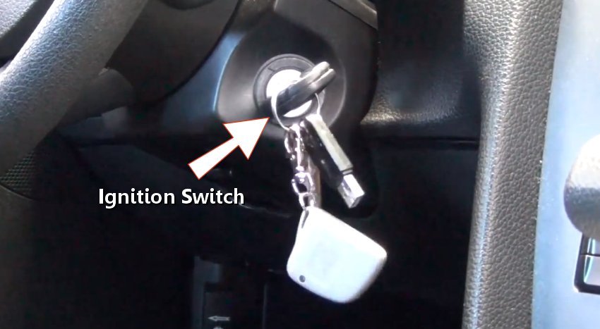

The ignition switch is what controls the electrical system within a locking mechanism that utilizes a key for security. These keys possess a frequency chip as an added theft deterrent.
ignition switch

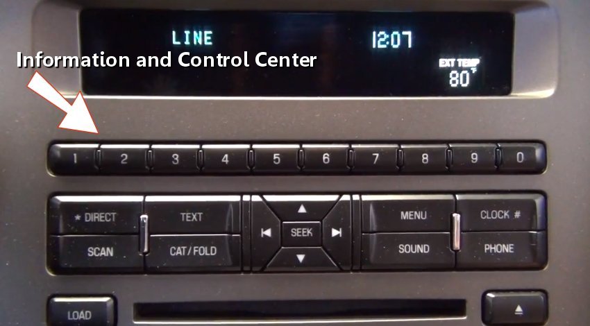

An information control center is used for interior controls such cell phone, GPS and audio system adjustments.

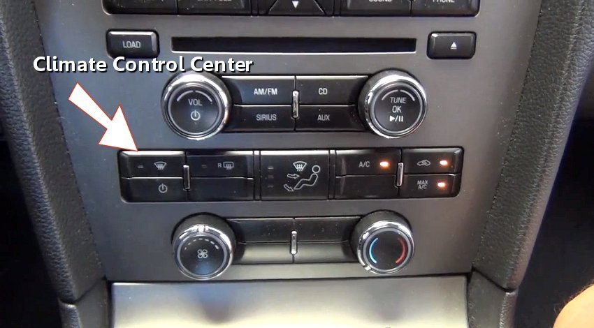

Electronic climate controls enable the driver and passenger to adjust temperature in a particular section of the vehicle such as engaging the air conditioner or heater.
climate control center

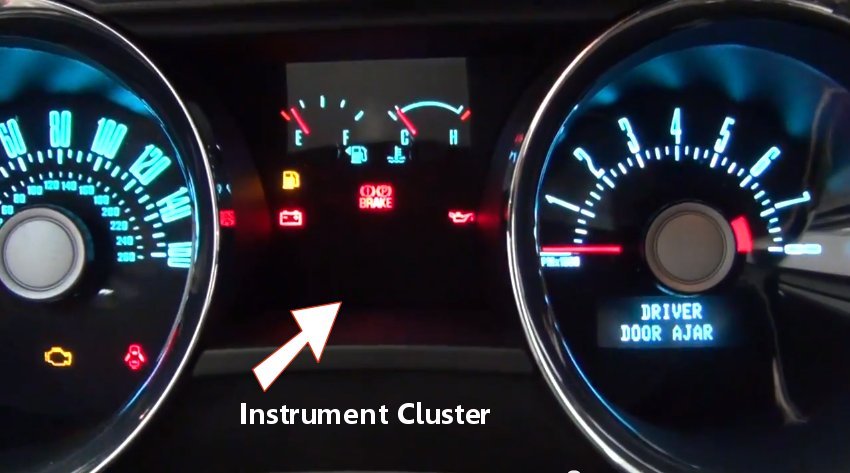

The car's instrument cluster is used to monitor engine and others system by using gauges and warning lights.
instrument cluster

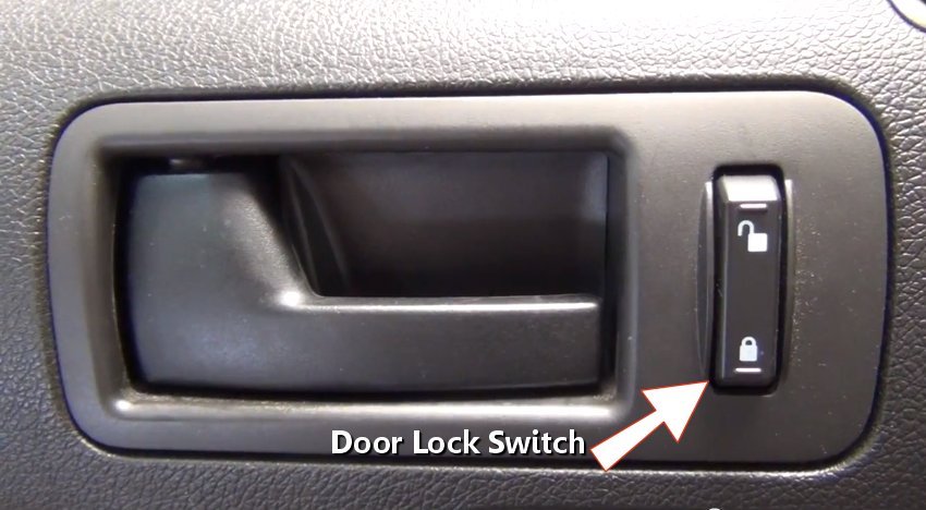

There and many switches that are used to control various items such as door locks and headlights. These switches are user controlled and can be overridden by the main computer.
door lock switch

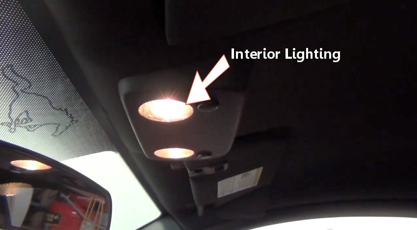

Interior lighting controls are automatically illuminated by the BCM computer. They can also be controlled by the driver or passenger.
interior lighting

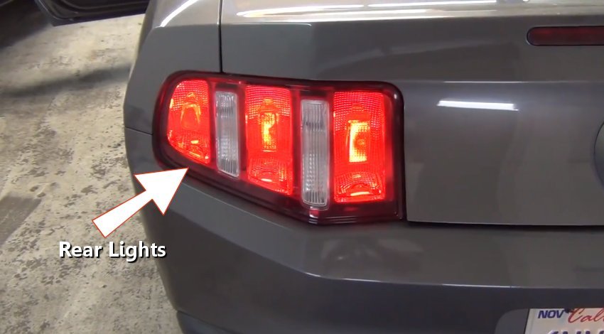

The lighting system is used to illuminate the vehicle for safety and for convenience. The rear lights include, tail, brake, reverse and license plate bulbs.
rear lights

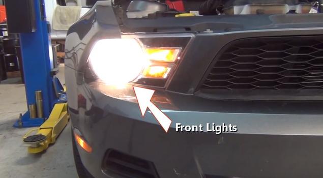

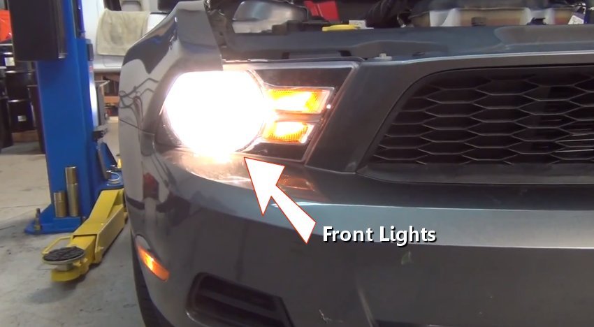

The front of a vehicle is designed with headlights, front running, side marker and blinker bulbs.
front lights
