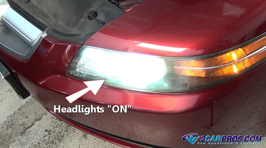

1. Turn the headlights on, and leave them on for about 15 minutes (do not start the engine), they should remain bright much like when the car is running.
bright head light

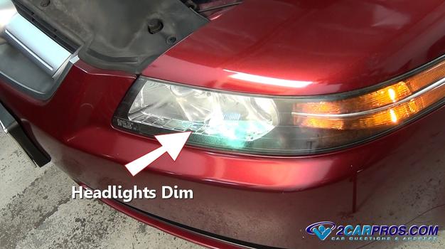

2. After the fifteen minutes is up and while the headlights are still on, try to crank the engine over while observing the headlight bulb brightness. The lights should only dim slightly when using the starter. If the headlights dim way down and go out, or you notice the engine is cranked over slowly followed by a ratcheting style of clicking noise the battery has failed and it must be replaced.
dim head light
