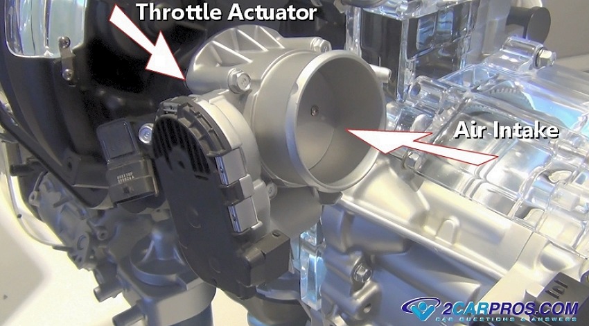

Here is a what a throttle actuator looks like on a 2019 vehicle which shows the air intake path, you can see the butterfly is closed, normally you cannot see this part when the air intake tube is installed.
throttle actuator

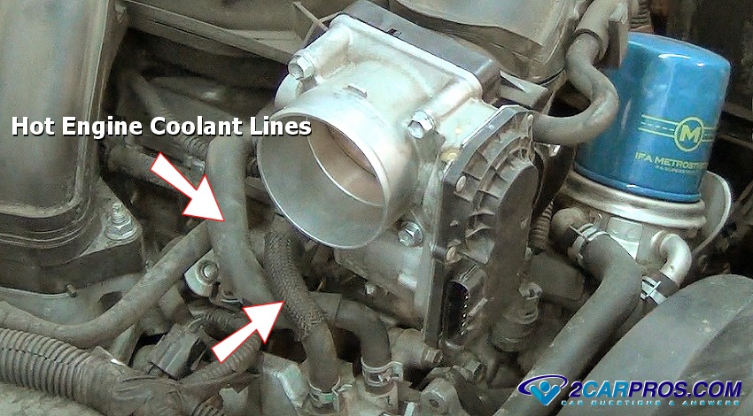

Manufacturers will sometimes run hot engine coolant through the throttle bore to help heat up the intake air to improve fuel economy.
hot coolant lines

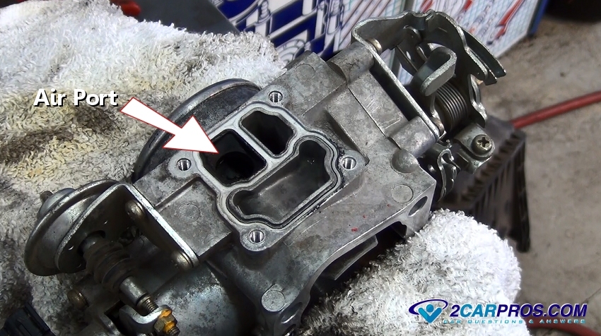

Air bypass ports are designed onto the throttle bore (idle air valve removed) which facilitate engine idle speed adjustments from the computer.
throttle bore air ports
