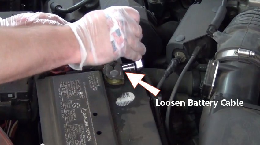

2. Remove Cable for Cleaning: With the ignition key, off use a 8mm or 10mm socket or wrench to loosen the cable by turning it counterclockwise.
loosen battery cable

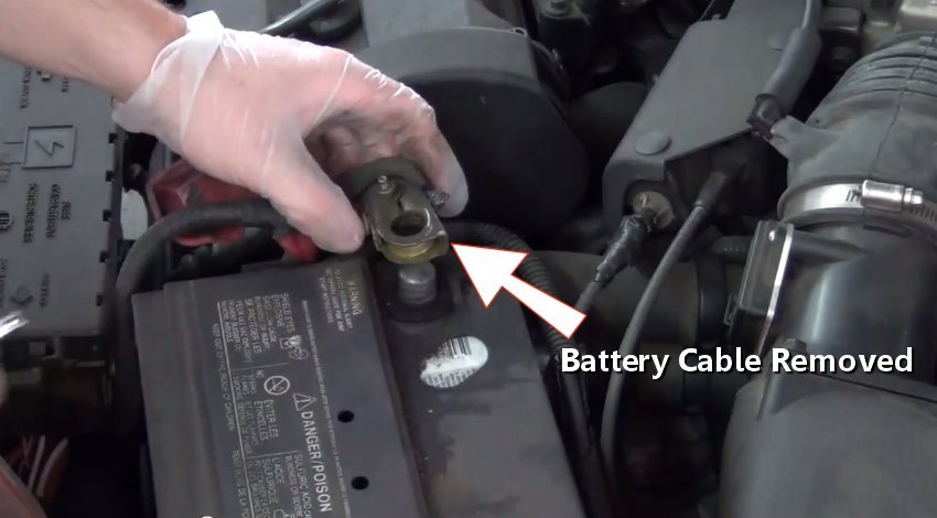

3. Twist and lift the cable end from the battery, there might be a small spark which is normal.
battery cable removed

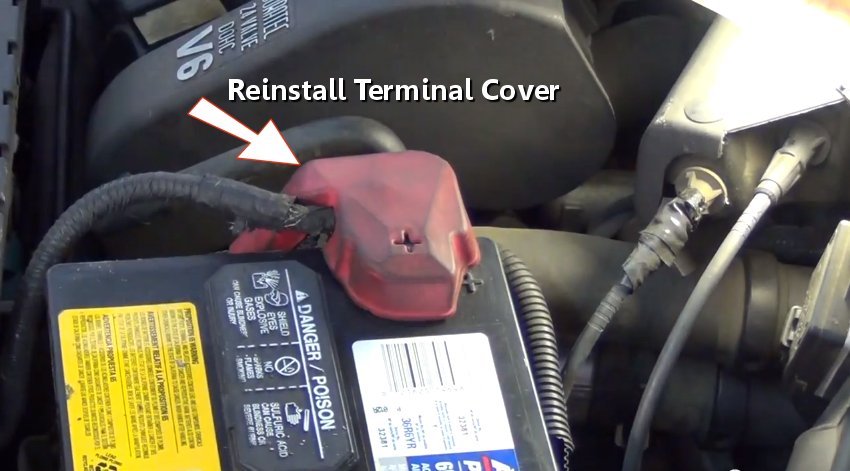

5. Reinstall the battery cable by pushing downward while tightening the nut. Do not over tighten the nut to avoid stripping.
tighten battery cable
6. Once tightened grasp the cable end and check it for tightness to the battery terminal then reinstall the terminal cover and you are all set.
