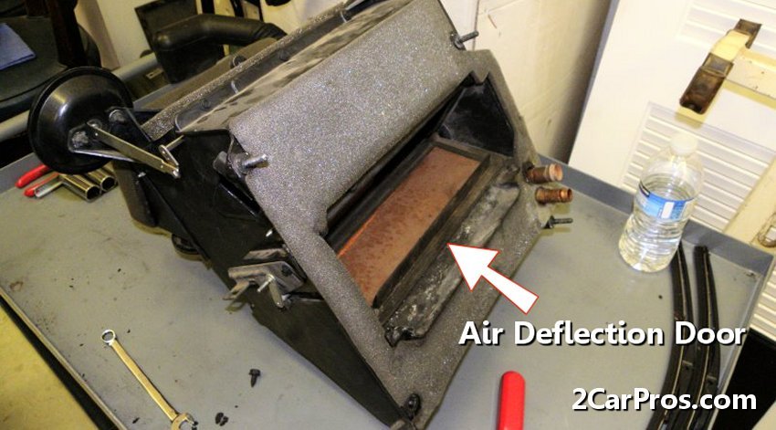

The heater core and air conditioner evaporator are housed in the same unit called a heater box or plenum. This unit is where several air blend doors and ducts are located which divert air to various vents, floor, midway and upper (defrost).
removing heater box plenum
In this illustration the heater box has been removed to show the air flow blend door which swings from one opening to the next mixing or stopping the air flow from one vent system to another.
air deflection door

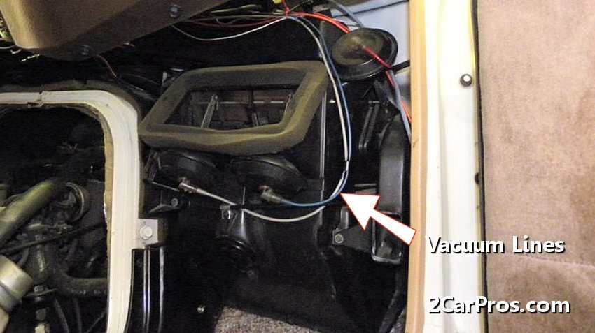

Air control doors are actuated by cable, vacuum or electrical servo motors which can be maneuvered using a manual lever or automatically from the HVAC system controls.
vacuum lines

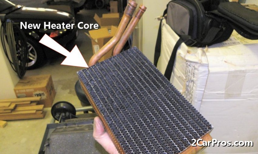

The heater core itself looks much like a small radiator and acts much in the same way by running hot engine coolant into the core and forcing air through it which delivers the heated air. When a heater core fails a coolant residue may be observed upon the passenger side floorboard this will typically be accompanied by a sweet, pungent odor which can come from the vents. Some vehicles utilize a heater control valve which is used to stop the coolant from flowing into the heater core when the heater system is not being used. If an audible bubbling noise is heard from the heater core area (like a fish tank) it's is due to air being trapped inside the heater core, in time the air should dissipate to silence the noise.
heater core

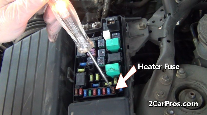

A fuse is used to protect the heater system which is located in the power distribution center and can be checked by using a test light.
heater fuse

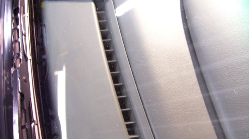

Warm air is pushed through the upper vents which are located at the front of the dashboard near the windshield. These vents are used to remove moisture from the inside of the windshield which helps improve visibility.
defroster vent

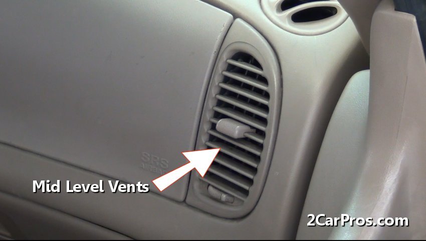

The mid level vents are primarily used for direct passenger comfort and have the ability to control and direct the airflow.
mid level vents
