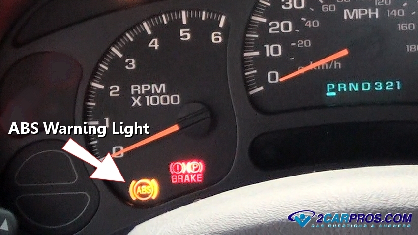

Most ABS brake systems are a "real time system", so when a trouble code is triggered, and the repairs made, the code will clear itself within a few yards of driving.
During an ABS or Traction control event the brake pedal will vibrate as the system kicks into action, this is normal.
abs and traction control warning lights

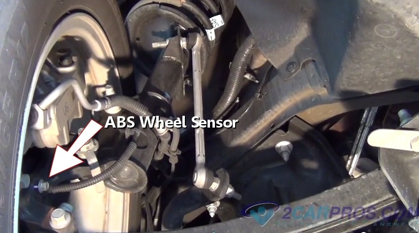

Wheel rotational speed sensors are used at each wheel, though some systems only use one rear wheel sensor that is mounted to the center of the rear differential. These sensors are located near the center of the rotating mass to give feedback data to the ABS/Traction Control module. Also, these sensors can be integrated into the wheel bearing hubs, when these bearing go out it can cause an ABS/Traction Control warning light.
abs wheel speed sensor
