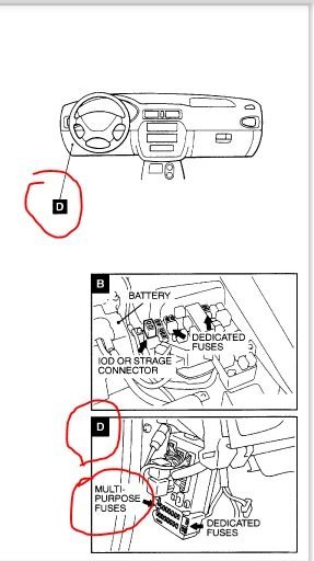

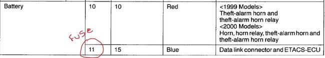

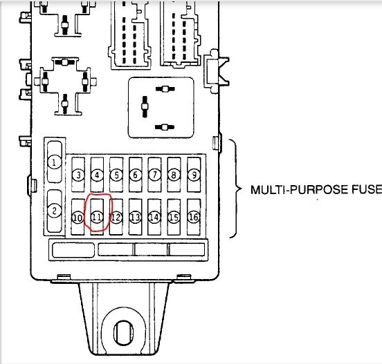

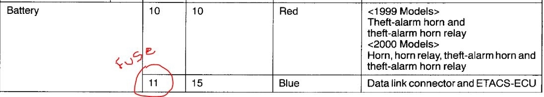

Welcome back, Linda:
First, you are very welcome. Okay, if the scanner won't connect, I need you to check fuse 11 in the fuse box under the dash. That fuse powers the DLC (where your scanner plugs into and the ECU). I attached three pictures to help identify it for you.
Next, pin number 16 on the DLC (data link connector) should always have 12v regardless of the key. Check that too. You can do it with a test light or volt meter.

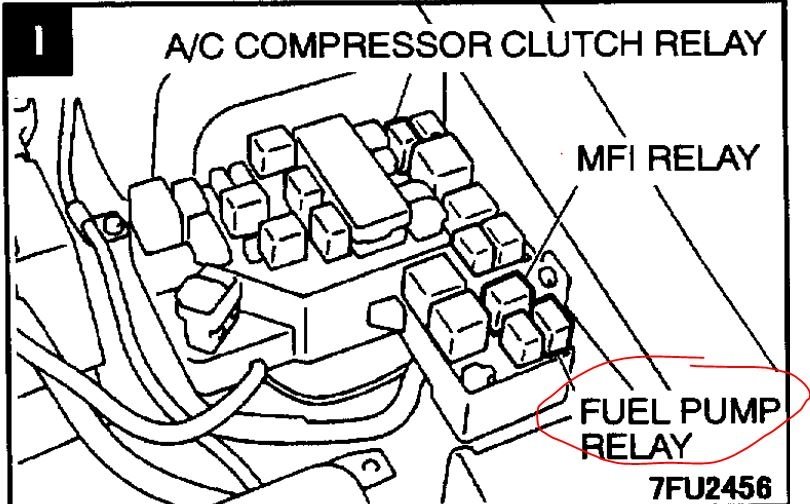

Also, I want you to check the fuel pump relay. Picture 4 shows its location. You can switch it with a different relay in the box with the same part number and try it, or here is a link that explains how to test one:

Under the not under beside the door? There is no #11 on mine in the book.

Welcome back:
That is what my manual shows. Check and let me know what you find. The pictures I sent are right from Alldata, so they should be correct. However, anything is possible.
