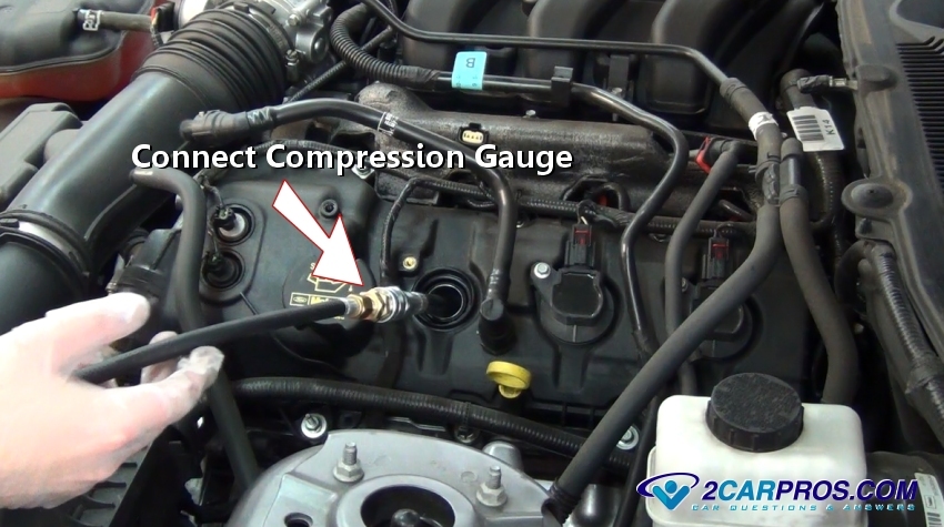

3. Insert Compression Gauge Hose: The compression gauge will have a rubber hose attached to a metal fitting which has threads that match the sparkplug. This will enable the hose to thread into the sparkplug hole. Tighten the hose by hand until it seals against the O ring on the gauge hose.
4. Attach the Compression Gauge: The gauge will be fitted with a connector that will attach to the compression gauge hose. Lift the connector ring and push downward onto the hose. You should feel a solid connection between the gauge hose and the sparkplug hose. Some gauges do not have a separate hose and will directly screw into the sparkplug hole.

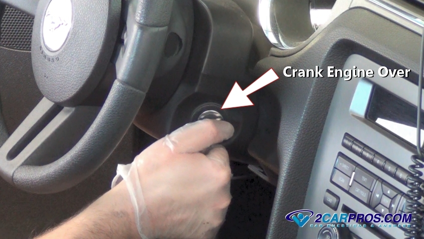

5. Crank the Engine Over: If you are just testing one cylinder be sure to pull out the fuel pump fuse so the engine does not start. On older engines you can pull off the coil wire. All compression tests need to be done at a regular engine cranking speed. Insert the ignition key and crank the engine over for about 10 seconds. This should give the gauge enough time to gather the correct cylinder combustion pressure.

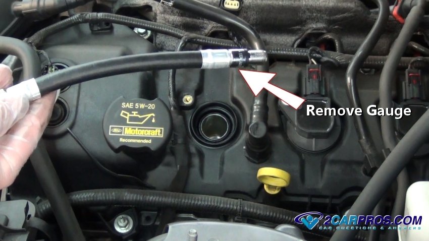

7. Remove the Compression Gauge: Once the test has been performed remove the compression gauge by unscrewing the test lead from the cylinder.
