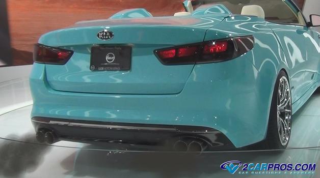

How to Repair Black Smoke From Tailpipe
black smoke tail pipe exhaust
Black smoke being produced from the exhaust system of is a sign of too much fuel being processed by the engine.
