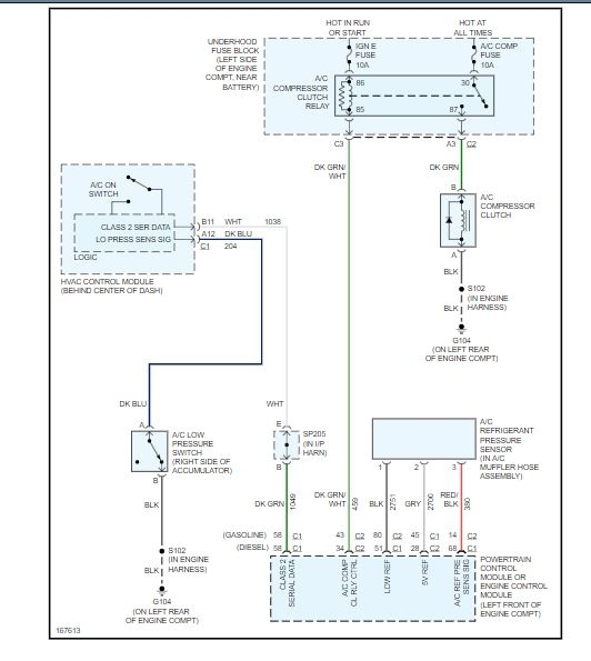

Good afternoon.

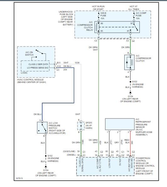

Do you have a set of gauges that can give me the high side and low side readings of the system? I need to see those readings in order to be sure the pressures are correct.
Is the compressor clutch engaging?
As far as the blend door, can you hear it move when you command cool to hot?
I attached a wiring diagram in case the compressor is not working.

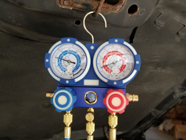

Good evening! I received my gauges this evening and completed the following:
1. Tested, 0 psi on both blue and red.
2. Vacuumed system for 30 minutes.
3. Let system rest for 30 mins, gauges held at -30.
4. Attached gauges and attempted to add Freon which would not take.
5. Started truck.
6. Removed blue adapter from low side, attached hose that came with the refill bottle, added Freon up to approximately 50 psi.
7. Low side line into firewall got cold.
8. Compressor did not cycle on.
9. Reattached blue adapter to low side.
10. Some Freon escaped, quickly closed valves.
11. Observed blue gauges decline to approximately 20-25 psi, estimate this occurred because the compressor did not turn on and pressurize system.
12. Red gauge held at approximately 20-25 psi.
Please advise as to the next step. Thank you for your time and advice.

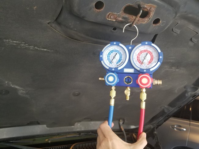

Jul 16, 2020 at 7:43 PM
  • CAR REPAIR CONTRIBUTOR
Okay, the compressor did not kick in because the pressure is too low. 20 pounds on the low side and the low pressure switch will not close and turn on the compressor.
You need more Freon for the compressor to come on line.
I am concerned you had 0 pressure when you started. Did you check for a leak?
https://www.2carpros.com/articles/air-conditioner-leak-detection

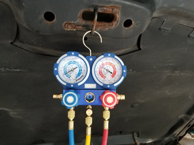

Jul 16, 2020 at 7:51 PM
BWILKINSON05
  • 68 POSTS
Roy,
That's what I thought regarding the compressor but the low side gauge read 60 psi after filling from the can which was more than the acceptable range provided. I was concerned about overcharging even though I have only used 11 oz from the can. Should I add the remaining 9 ounces and see if the compressor kicks on?
I read the check for leaks after vacuuming is confirming the gauge holds at -30 which the system did. How do I check for leaks?
This morning we tested the system again and attached a picture for your reference.
Best regards,
Bret
Jul 17, 2020 at 7:59 AM
The gauges are showing 0. The compressor will not come on until there is pressure.
The system holds 1.6 pounds.

With the engine off and fully charged, the high and low side should read the same pressure. That pressure will be close to the ambient temperature of where you live.
Start by charging the system.
As far as a leak, I attached the guide for checking the leak with either a UV light or a bright LED light.

Okay, first, no to the reset. There is no reset.
Go to the diagram I posted in the beginning. See the ac clutch relay. Check for 2 power with the key on. There should be 2 terminals with power.
If there is, then you need to test for power to the pressure switches as well.
Check those and let me know.

Okay, did you test the 2 wire sensor or 2 wire? The 2 wire is a low pressure switch. It should have 12 volts with the key on.
the 3 wire sensor run on 5 volts. The reference and signal wires should both have 5 volts. The remaining wire is the return wire to the module.

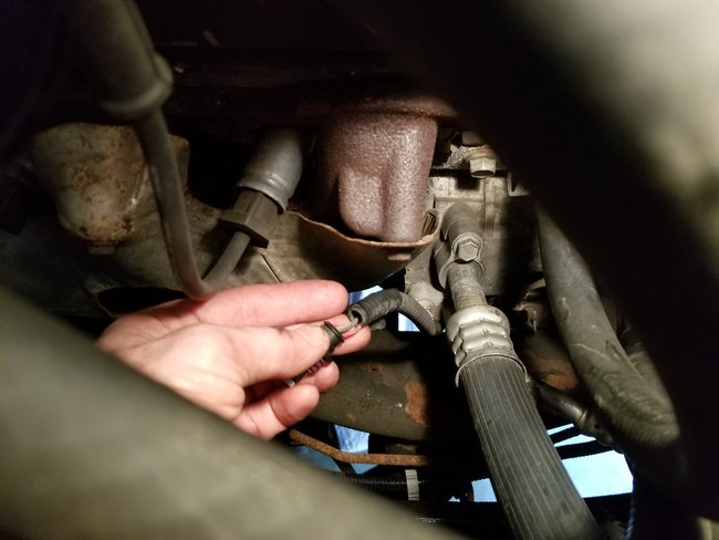

We tested the pressure sensor near the fire wall which I believe is the low side pressure sensor. It has two ports and read 4.8V with the key on. Where is the 3 wire sensor?
Bret
Jul 18, 2020 at 8:04 AM

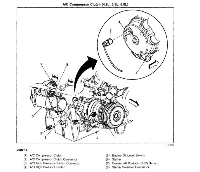

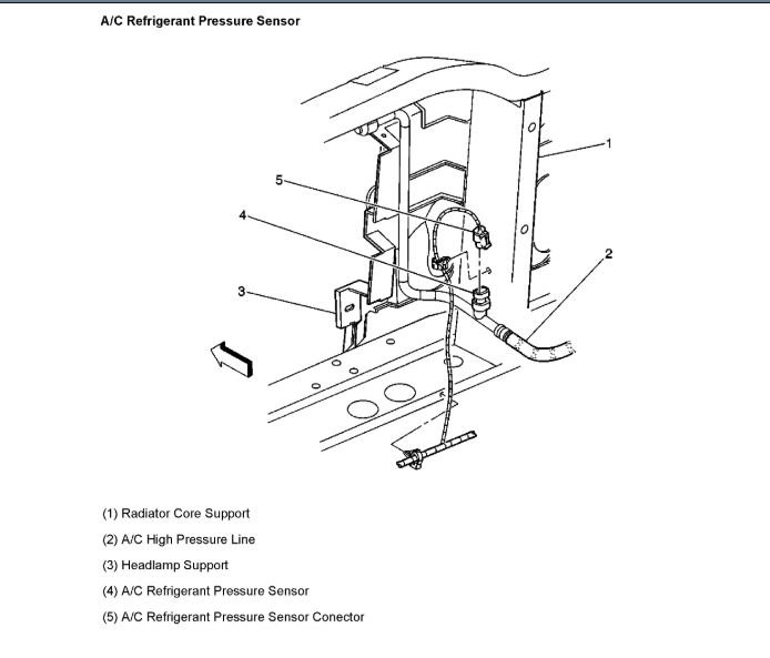

Okay, I stand corrected. The 2 wire you checked should be 5 volts. Jump the terminals together and see if the compressor runs.
The 3 wire is at the compressor. It should be on the high side line. It could also be at the front as well. I attached pictures for you.That will have 2 5 volt feeds.

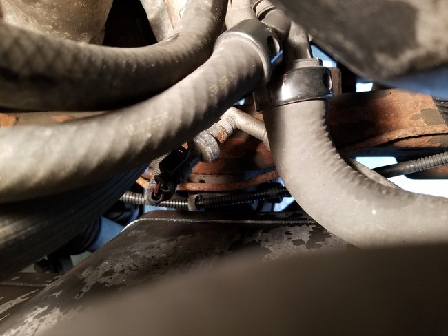

We double checked and confirmed the high side connector was two pins. When we jumped I notice a slight draw on the motor but the clutch did not turn on.
I test the three pin connector near the compressor, see attached picture and it read 5V. i also noticed but did not test a connector on the compressor.
Bret
Jul 18, 2020 at 8:28 AM

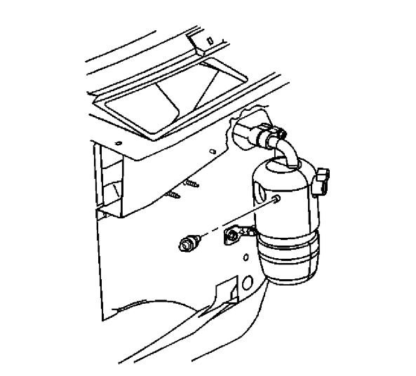

Okay, did you jump the 2 wire on the low side? It should be by the dryer assembly.
Were there 2 5 volt feeds a the pressure sensor?
Jul 18, 2020 at 8:38 AM

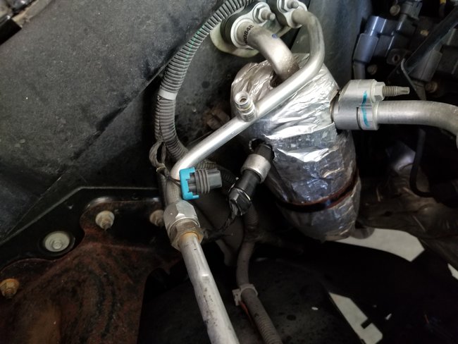

We jumped the low side pressure sensor connector in the attached picture, I noticed a slight draw on the motor but the clutch did not kick-on. There is a second connector near the low side sensor, see blue connector in picture but I do not see a place to plug in.
Bret
Jul 18, 2020 at 8:45 AM
Okay, that connector is for another option.
Did you verify both powers to the other sensor?
Jul 18, 2020 at 8:49 AM

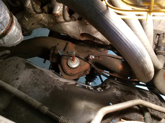

I just tested the blue connector in the picture and it read 0V. I just noticed it this morning, not sure why it's there.
Which other sensor are you referring to?

LIke I said, forget about that connector.

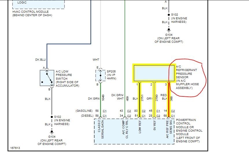

The 3 wire sensor on the high side line by the condenser in the picture I posted.

We tested the high side pressure connector which read 5V, see picture which I believe matches the location #4 and #5 in the #3 diagram you sent at 8:22 this morning.
Please advise.
Bret
Jul 18, 2020 at 10:04 AM
The picture is dark.
How many wires in the connector?
Jul 18, 2020 at 10:06 AM
BWILKINSON05
  • 68 POSTS
Roy,
I have attached a close up of the wires on the high side connector. I see red, grey and white.
Bret
Jul 18, 2020 at 10:15 AM
Okay, that matches the diagram.
Do you have 2 wires that show 5 volts with the key on?
Jul 18, 2020 at 10:36 AM
BWILKINSON05
  • 68 POSTS
Roy,
Yes, we tested with two paper clips and it read 5V.

Please, I asked you for the voltages at the 3 wire sensor. Do you have 2 5 volt wires?
I know you are stuck on the module but we are not there yet.

I tested the high side connector with 3 wires. I show 5V from one point and 0V from the other two.

Roy,
We ran another test to check the compressor. we jumped the relay with a paper clip and the compressor clicked. With the jumper in place the clutch also engaged while the vehicle was on.
Bret
Jul 18, 2020 at 2:12 PM
BWILKINSON05
  • 68 POSTS
Roy,
Here is the latest update:
1. I jumped the compressor relay with the paperclip
2. The Freon had run low so I added a new can 12 oz and the remainder of the A/C Pro can, approx 6-8 oz.
3. Allowed the system to run for awhile, please see charge levels which I believe are spot on per the gauge manual.
4. As a test, I removed the paperclip and the compressor clutch stopped, kept jumper clip installed.
5. The air in the cab was cool but not extremely cold at the lowest setting of 60 F
6. I believe this rules out the climate control module and indicates a switch is bad, I guess I would start with the low side.
7. Is it a fair estimate the relay is okay, if I switched with the horn relay and the horn works with both?
Thank you for your comments.
