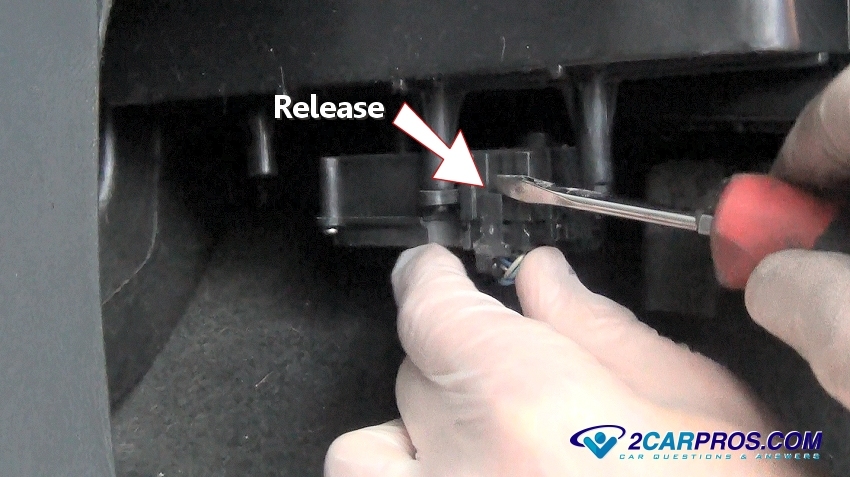

5. Begin by using a small screwdriver to release the wiring safety clip on the harness for the actuator. These clips can be brittle and break so be gentle.
bend door actuator

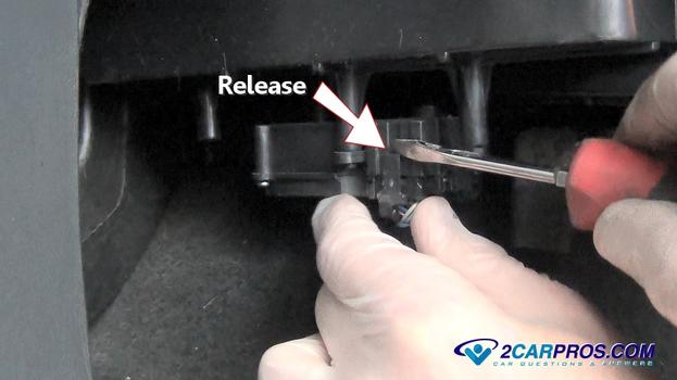

6. Once released gently pull down on the wiring connector and remove it from the blend door actuator. Inspect the connector for rust or corrosion and clean as needed.
remove blend door actuator wiring conenctor

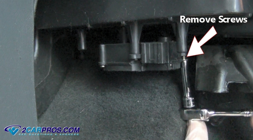

7. Locate and remove the actuator mounting screws. There should be two or three screws holding it in place. A small universal might be needed to help remove the screws in awkward places. Once removed place the screws into a small container so they don't get lost.
remove actuator screws

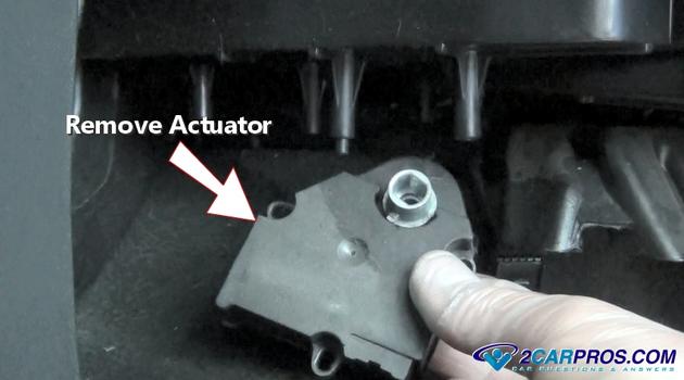

8. Once all of the mounting screws have been removed the actuator should become loose. Grasp the actuator and pull it from its mount to remove.

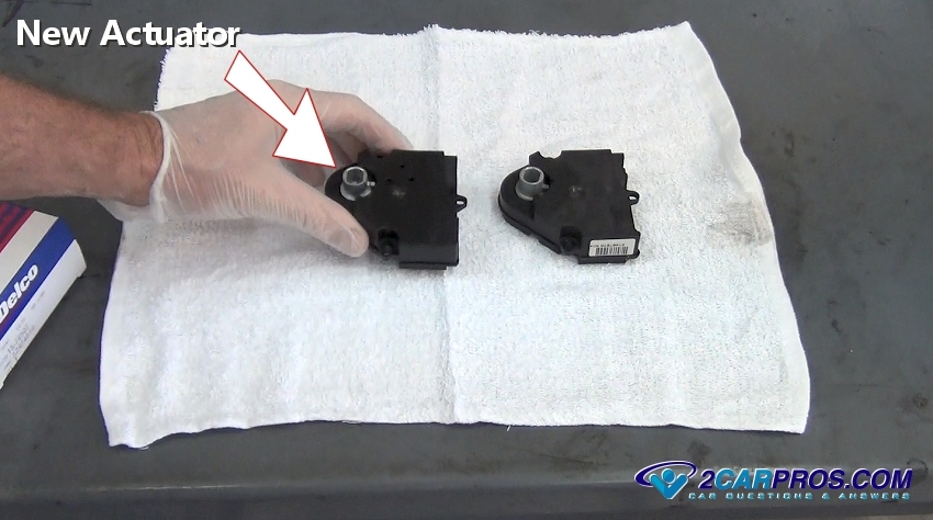

10. Compare the bad actuator to the new unit. Be sure to check the wiring harness connector terminals they should match identically. Now the new part is ready to be installed.
new blend door actuator

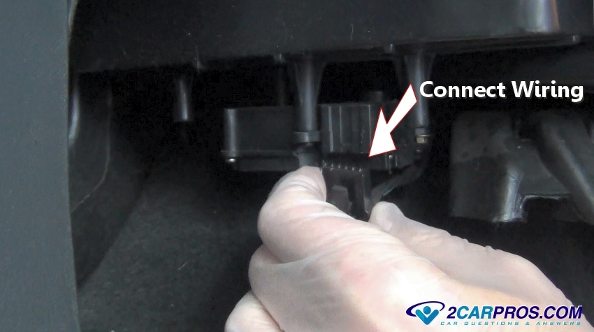

12. Once all screws are in place firmly push the wiring harness connector back into the actuator. You should hear a click signaling the correct installing of the connector.
connect blend door actuator wiring

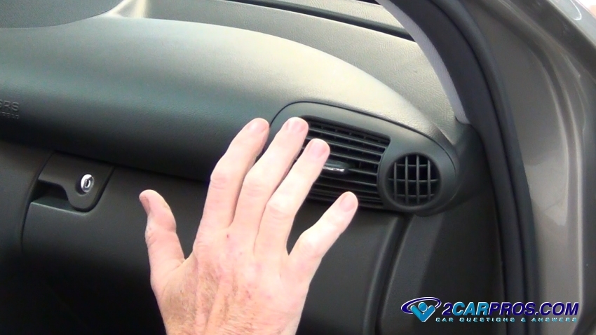

15. After cover has been re-installed start the engine to test the repair job by turning the climate control on and moving the controls from hot and cold and from defrost to the mid and floor positions to ensure the new actuator is working as it should.
vent test

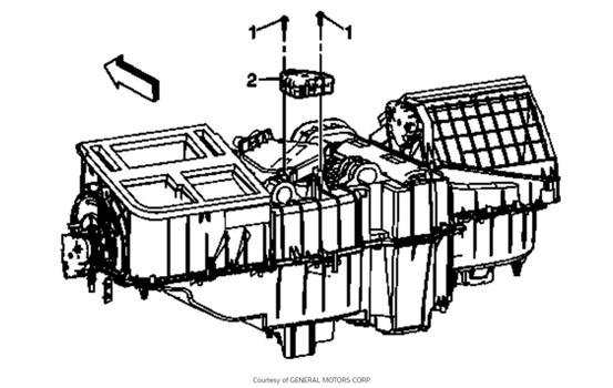

You can use a repair resource such as Mitchell1, a paper manual found on Amazon or a resource like Google images to locate the particular area in which the actuator needs to be replacement.
Here is an example of a Silverado, Suburban and Tahoe locations.
Recirculation Actuator
recirculation blend door actuator location
Mode (Defrost Mid Vent and Floor) Actuator Location
mode blend door actuator location
Left Temperature Actuator Location - Signal System Temperature Actuator
right blend door actuator location
Right Temperature Blend Door Location
left blend door actuator location
