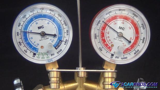

While the gauge valves are still closed, and once the refrigerant source has been opened, the gauges will respond with an equal readings on both high and low side letting you know that refrigerant is present and ready to be installed. This is static pressure which will vary depending on the outside temperature. The warmer the weather the higher the reading will be, this is normal.
Each system has a specific amount of refrigerant that it needs to operate correctly. This amount is located in the owner's manual or on the system underhood sticker/label. If you are using a keg and digital bathroom scale will help tell how much has been added. Using refrigerant cans make this measurement easier because each can will be 8 ounces etc. This guide will successfully recharge the system even if this information is not available.
static ac pressure
Reference the image below to see how refrigerant will flow (arrows) once the low side gauge is opened. Never open the high side valve while charging. The high side connection is for monitoring purposes only.
refrigerant flow

Continue adding refrigerant until the gauges start to look like this (below) and the compressor stops cycling, close the low side valve on the gauges. If both gauges are too high the system is overcharged or the cooling fan is not working. If high side pressure runs way up quickly (300+) and the low side goes into a vacuum the system has blockage such as a plugged expansion valve or orifice tube. If the compressor engages and neither gauge pressures move (stay the same) the compressor has failed and needs replacement.
close low side gauge valve
Here is a chart to help you get an idea of what the pressures should approximately be for r134a, for R-1234yf the readings will be slightly higher on both high and low sides. A general rule of thumb is, if the air becomes cold inside the car then stop added refrigerant, more will not make it even colder.
