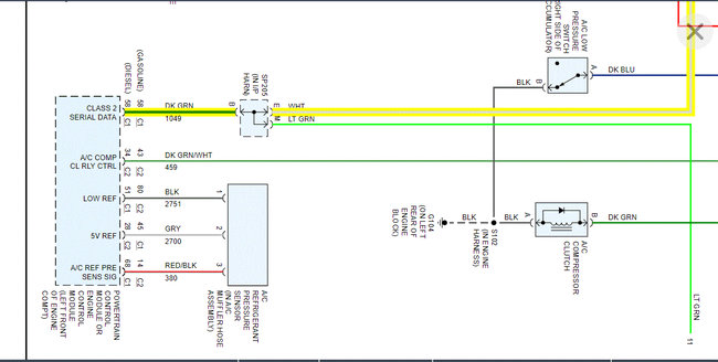

Roy,
Correct, pin 14 which has a red wire with black line.
Bret

Does not make sense. You have replaced the ECM and it still has no power to that pin. Without that power the control side of the relay will not work.

Here's a recap of my test methods, with key in on position:
When I tested the low side sensor - using a multi-meter I touched the red lead to the paperclip in connector and black lead to the battery negative post.
Same with ECM pin 14 test - inserted paperclip in back of harness, plugged harness into ECM, red to paperclip, black to battery negative post
Same process with high side sensor.
Was my test correct?
Bret
Wednesday, August 12th, 2020 AT 8:06 AM
  • 52,797 POSTS
Yes, but the issue is nothing at pin 14.
This leads me back to the ECM again. Let me look for any other information.

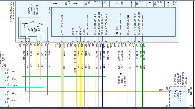

How do I test the power going into the ECM? See July 11th email with schematic. I believe that's the issue. Pin 14 is line from the ECM to the high side sensor. If you look at the schematic, I would like to test the line from the CCM to the ECM, it's the grey line. I believe I need to remove CCM and back probe the grey line.
Bret
Wednesday, August 12th, 2020 AT 8:22 AM
  • 52,797 POSTS
If there was no power to the ECM, you would have many other issues and a ton of codes.
The gray wire you told me had 5 volts as it should. Why do you want to check it again? That along with the red/black need 5 volts.
Wednesday, August 12th, 2020 AT 8:50 AM

Agree. I am referencing the white line in the schematic from 7/11 from the climate control module to the ECM. I would like to confirm that line has power with a back probe test.

For testing purposes only, what should the voltage be at the white wire exiting the climate control module connecting to SP205 then to the ECM? What is the SP205? Also, do you have a schematic of the climate control module you can send?
Thank you,
Bret
Thursday, August 13th, 2020 AT 3:09 PM
  • 52,797 POSTS
I attached the diagram with the white wire. It is serial data. There is no voltage. It is a multiplexing signal.
Thursday, August 13th, 2020 AT 3:23 PM
BWILKINSON05
  • 68 POSTS
Roy,
What should the readings be at pin #'s: 58 and 43?
Bret
Thursday, August 13th, 2020 AT 8:17 PM
  • 52,797 POSTS
58 is the serial data line I told you about.
43 is the wire from the control side of the relay. It will have 12 volts there unless the ECM grounds that wire. Then it will be 0.
