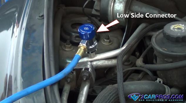

1. The number one reason for an air conditioner to stop working is lack of refrigerant. When this part liquid, part gas runs low the AC system is equipped with a pressure sensor that will shut the system down to protect the compressor. To check the refrigerant level, simply attach a recharge kit and add until the system turns back on, then top off the system according the the kit gauge and you are all set, AC recharge video. If the system works for a while but then stops working again you have a refrigerant leak that needs to be found and repaired.

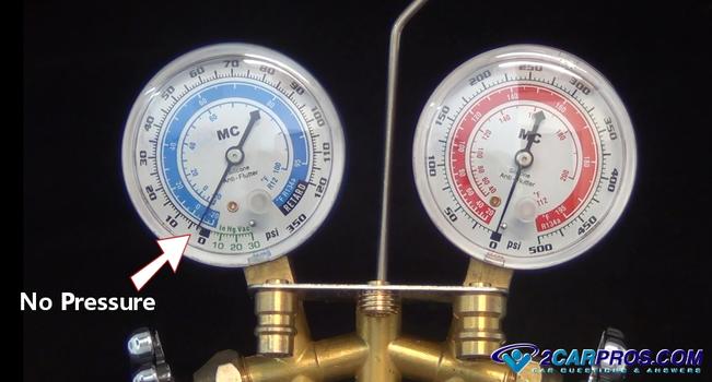

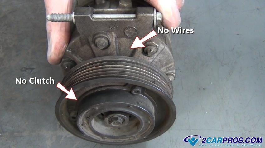

If the clutch is doing nothing then its time to connect a gauge or charge kit to see if the system is completely flat or is just so super low on charge. When the system is low or overcharged pressure sensors tell the compressor to shut down while avoiding damage. On internal valve compressors i.e. German cars you must use a test light to see if the signal wire is getting power or not. This style of system does not cycle when it's low it just shuts down so its best to check the systems charge.

As you can see on this style of compressor the pulley hub where the clutch would be located is directly bolted to the input shaft of the compressor. These compressors have an internal valve which is located at the rear of the compressor to begin the process when activated.
no clutch air conditioner compressor

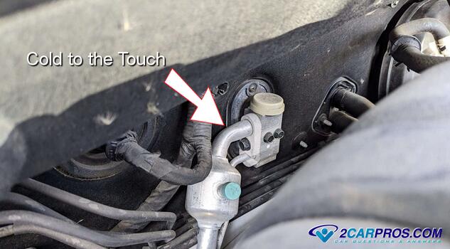

5. If the compressor is running and you still do not have cold air you need to connect an AC gauge set to check the charge and pressures to see what's going on, this is true for the style of compressor with no clutch. If the refrigerant level is okay and the compressor seems to be running the next step is to check the return hose or tube that comes out of the firewall and to the compressor.
It should be cold to the touch with the system running, if not there is a problem with the expansion valve or the orifice tube which you should be able to see with the pressure gauges. This AC recharge video can help you.

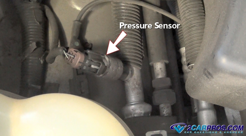

6. A pressure sensor is used to measure the amount of refrigerant is in the system. When this sensor goes bad the compressor will not turn on. To test this sensor remove the wiring connector and insert a jumper wire between the two terminals of the connector. If the compressor turns on the sensor is bad or the system is low. If nothing happens use a test light to see if there is 12 volts at one of the wires. If no power is present and the fuses are good suspect a failed climate control computer.

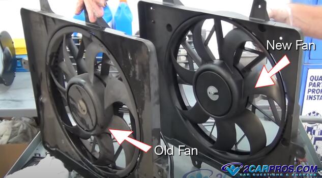

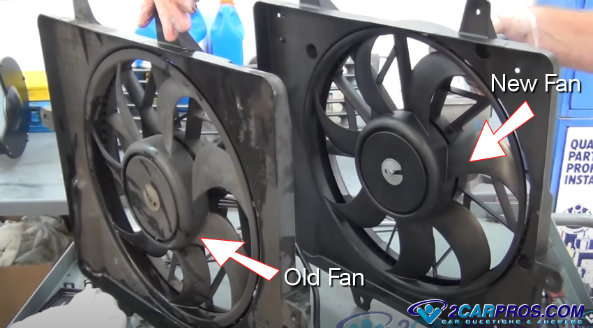

1. Anytime the air conditioner is on the radiator/condenser fan must run which pulls air over the condenser to help cool the refrigerant. This fan should turn on within a minute of the AC system being switched on. If the fan is not operating the air conditioner will not work, usually the cooling fan motor will burn out which needs to be replaced.
On some rear wheel drive vehicles a mechanical fan is used, with the AC system and engine running look to see if the fan is "freewheeling" which is an indication of the fan clutch needing replacement.

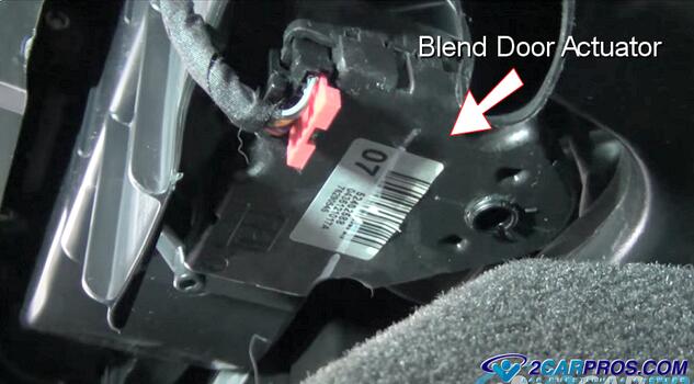

2. If the refrigerant side of the air conditioner is working but you don't feel cold air blowing out from the vents this typically means the temperature blend door actuator is bad, the location of this item will be in different locations for each manufacturer.

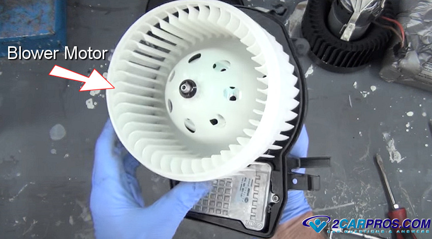

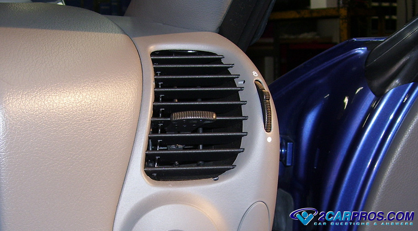

3. If air is not blowing from the vents it can be attributed to the blower motor or a mode vent control actuator. Here is how to tell which; start the engine and turn the air conditioner on. Next, move the fan setting to the highest speed setting, if you can hear nothing there is a problem with the blower fan. If you do hear the blower motor working then the mode actuator needs to be replaced.
