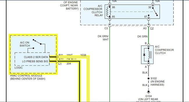

I apologize I got us on a tangent. I went through the ECM pass-lock reset process and it worked, my truck started. However, the compressor did not engage. Do you have a recommendation?
Bret
Sunday, August 9th, 2020 AT 11:56 AM
  • 52,797 POSTS
Okay, no worries.
You need to go to the relay for the clutch, which I posted way back, and let us start with powers.
Did you check Freon pressures both high and low side?
Sunday, August 9th, 2020 AT 12:03 PM

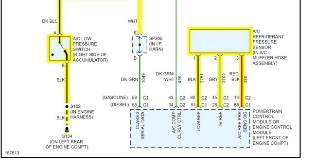

BWILKINSON05
  • 68 POSTS
Roy,
We tested the following:
low side sensor - 5v and 0V
high side sensor - first test we had 5v at one pin, 0v at two pins.
Jumped low side sensor - compressor clutch turned on.
Plugged low side sensor back in then removed.
With low side sensor jumped, tested high side sensor - 0v at all three pins.
Jumped A/C relay, ran A/C system confirmed Freon at a good level.
Jumped low side sensor, A/C clutch would not come back on and was surprised this was the case. I believe the test result initially indicated the low side sensor is bad but can't explain why we don't have 5v at two pins at the high side sensor and why the low side sensor jump won't turn the clutch back on.
Please advise.
Thank you,
Bret
Sunday, August 9th, 2020 AT 1:04 PM
  • 52,797 POSTS
What is the high and low side pressure when you jumped the low pressure sensor?
Sunday, August 9th, 2020 AT 1:14 PM
BWILKINSON05
  • 68 POSTS
Roy,
We were surprised the clutch kicked on and then could not get it to repeat which is why I jumped the relay to check the Freon level, blue and red are both at 110 psi.
Bret
Sunday, August 9th, 2020 AT 1:23 PM
  • 52,797 POSTS
Okay, the low pressure switch voltage comes from the HVAC module as in the diagram.
The pressure transducer comes from the ECM. That should have 2 5 volt signals and 1 return.
Sunday, August 9th, 2020 AT 1:29 PM
