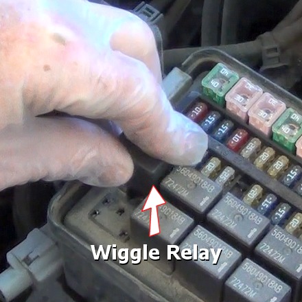

When a fuse or relay becomes warm it can disconnect the electrical supply to a vital circuit causing an engine stall. Many mechanics will employ the "wiggle test" to find such a condition, with the engine running (idle) wiggle all main fuses and relays to see if the engine stalls, if found remove the fuse or relay and look for signs of overheated or melted connections, then replace the fuse or relay and enhance and clean the electrical terminals to fix the problem.
