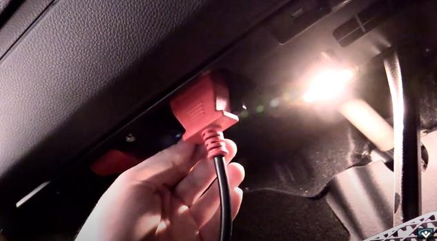

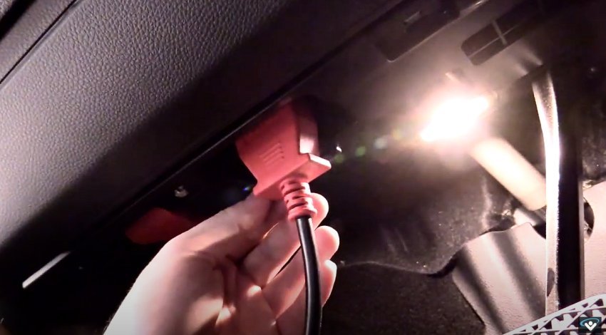

1. Much like an simple drivetrain (engine) scan the CAN scanner plugs into the same OBD2 port which is located under the dash on the drivers side in most cases.
obd2 data port connector

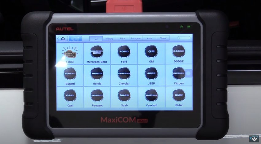

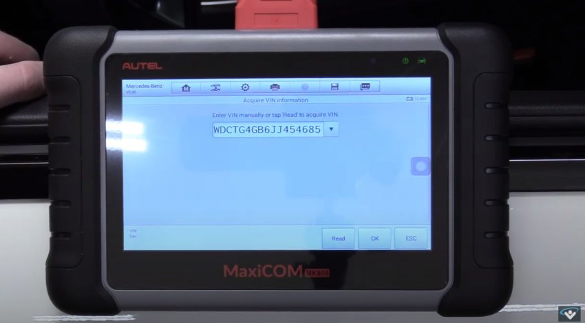

2. The screen will prompt you choose the manufacturer of the vehicle, then the VIN identification feature will "pop up" which follows this step.
CAN scan maufacturer opition
3. The VIN number id will tell the scanner exactly which car you have including the engine and transmission type, trim level and other options your car may have.
CAN scan vin id

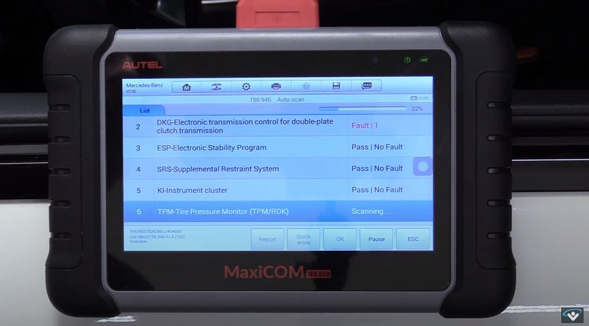

4. Once you have selected to start the scan it will begin showing each system status once the scan of a particular system is complete, the status of said system will appear while detecting communication errors.
CAN scan system detection codes

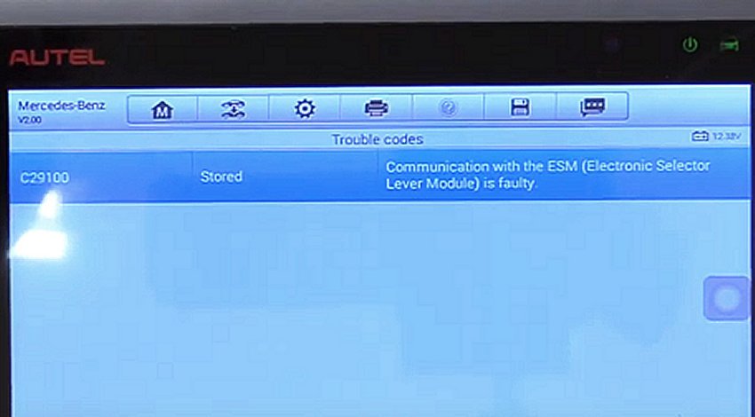

5. If a problem is detected it will allow you to select the system which will then display the error code. Once the repair is complete you can simple choose the clear codes prompt and you are done, it's that easy.
CAN codes display
