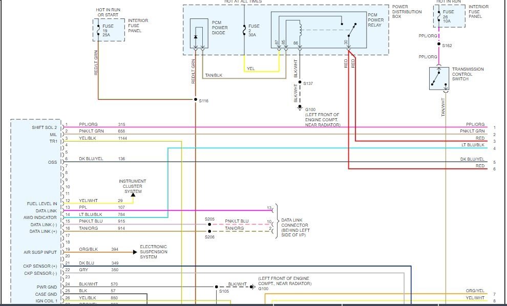

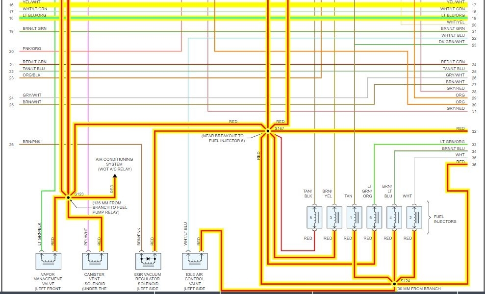

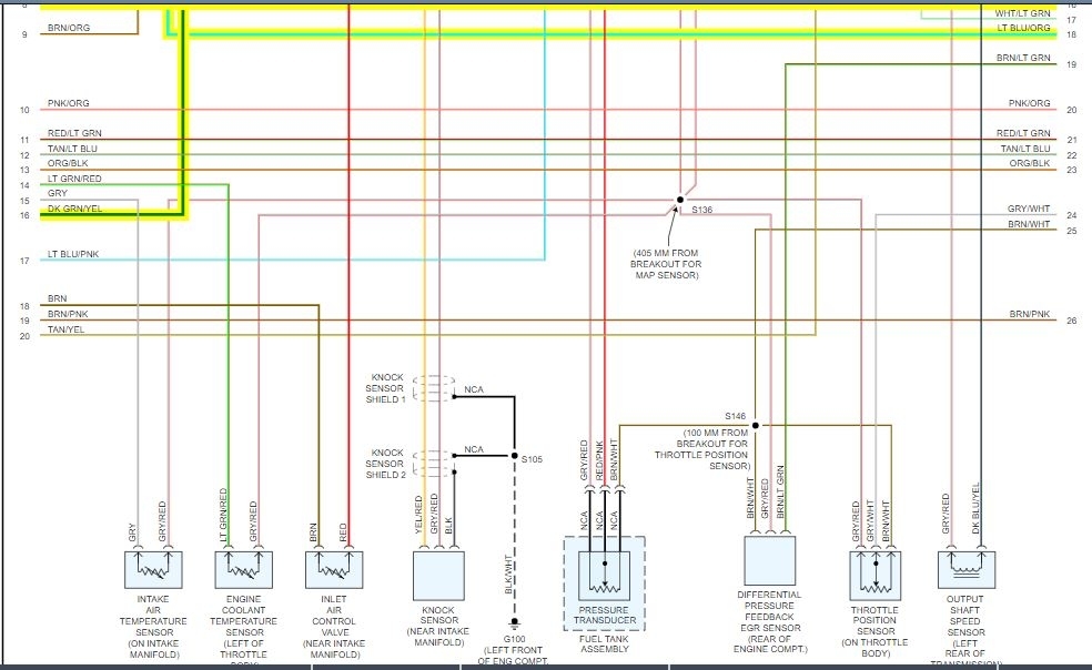

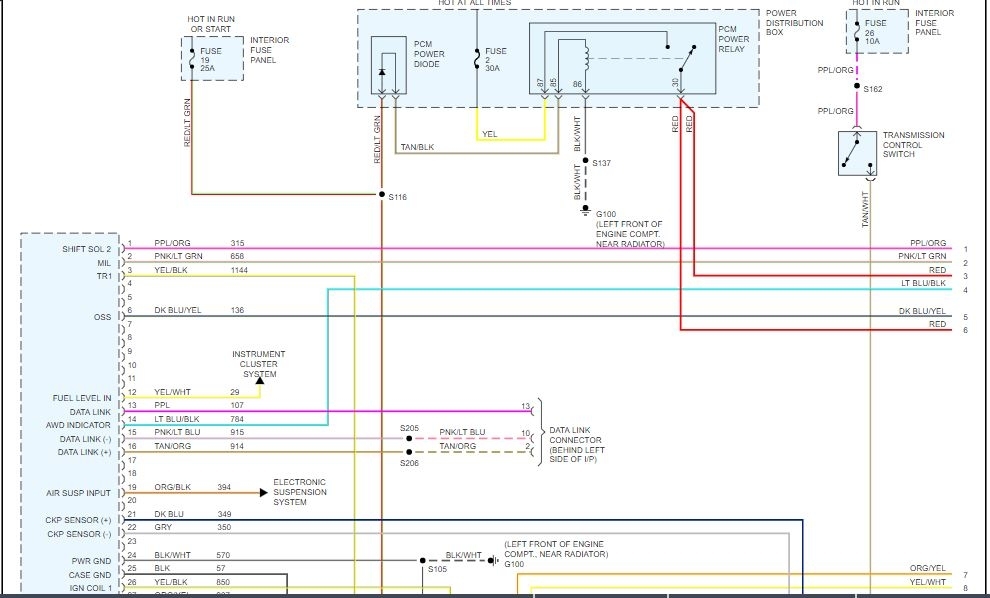

Replace spark plugs and wire and ignition coil. Put new starter and starter solenoid. Now the truck wont start and no interior light.
Monday, March 29th, 2021 AT 12:19 PM
  • 52,797 POSTS
Good afternoon,
I would start by testing the battery and cleaning the battery cables.

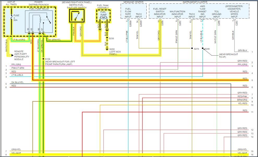

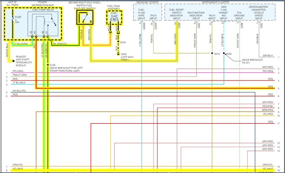

Once you get power back, see if you can hear the fuel pump run for 2 seconds when you turn on the key.
I would also check the fuel pressure and test for spark as well.

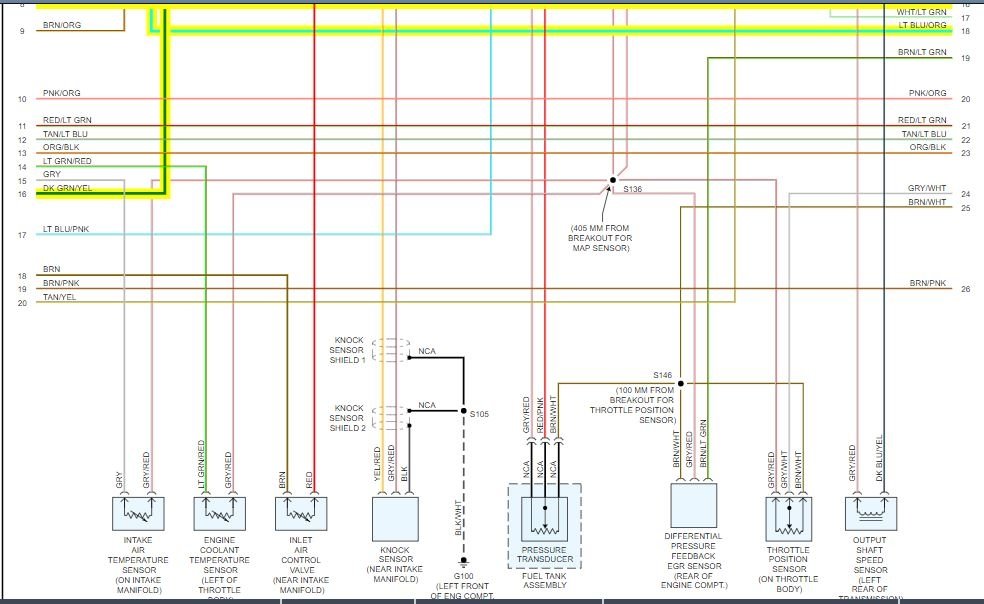

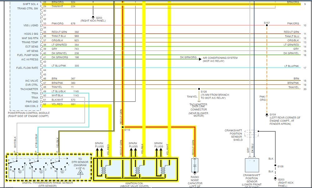

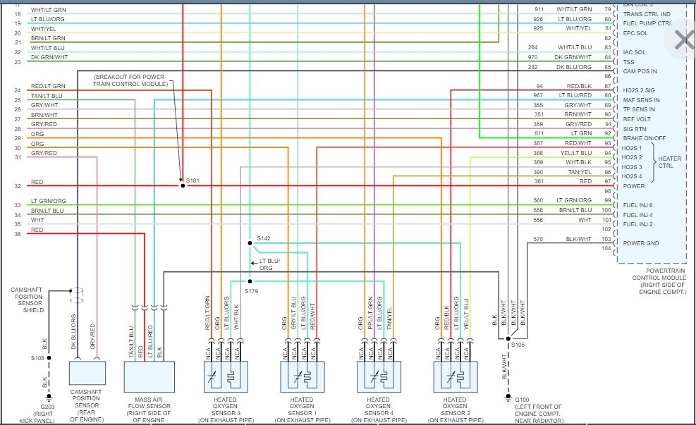

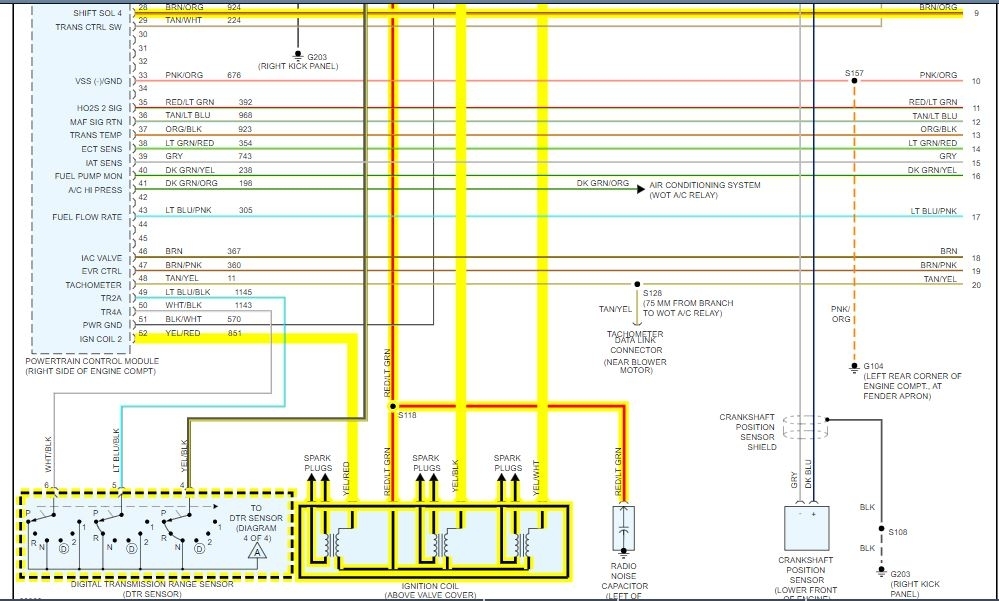

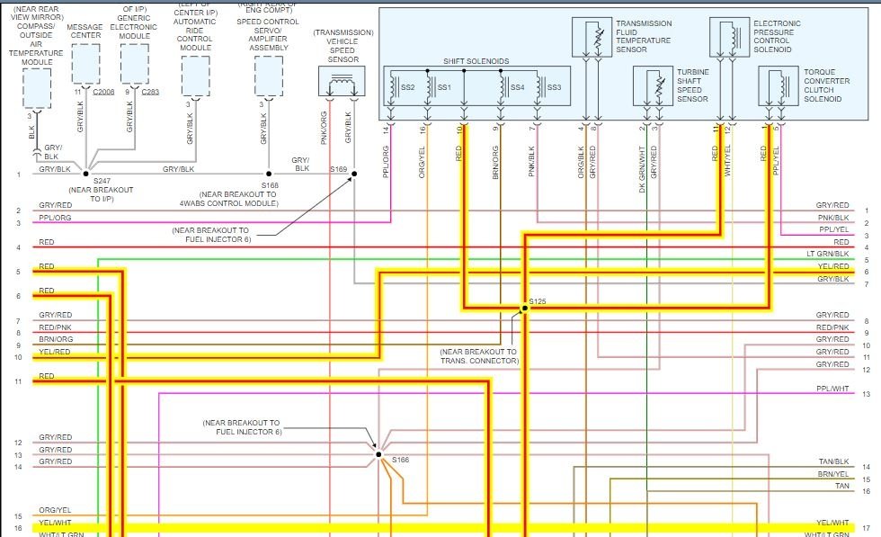

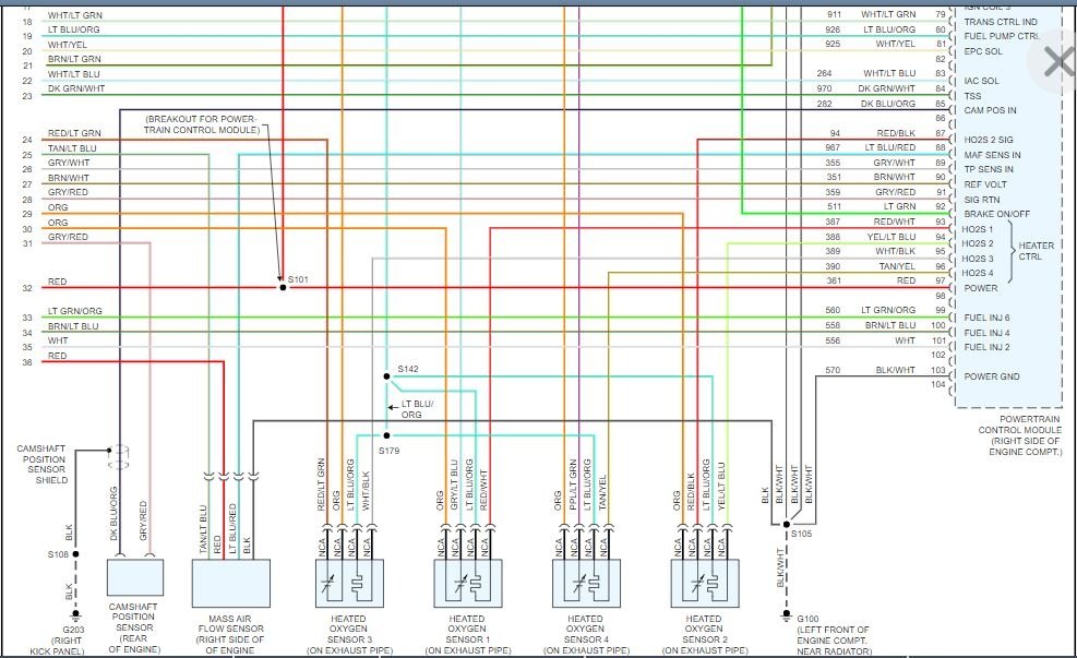

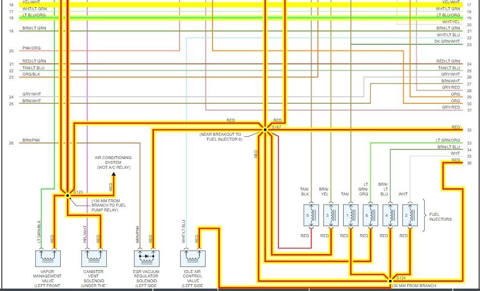

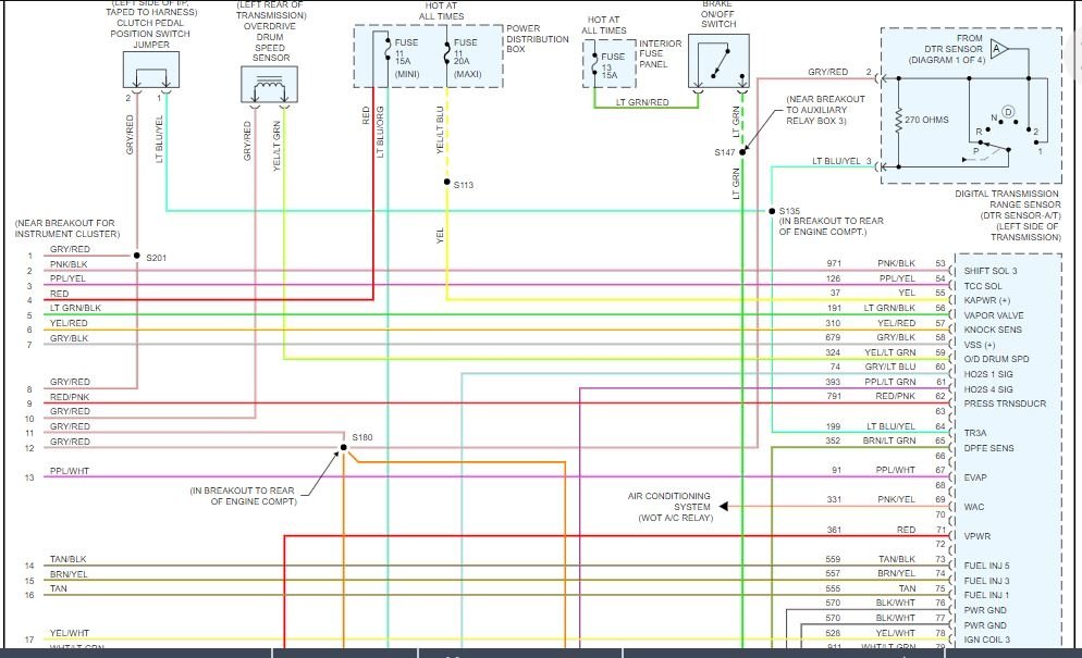

I attached the wiring diagram of the system for you.
