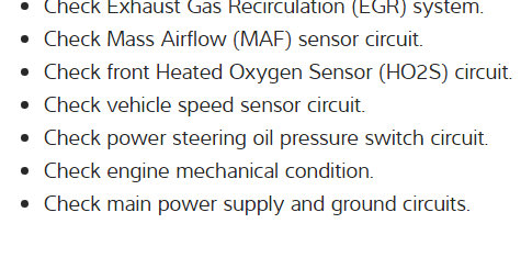

A while ago my car started running very rough upon startup and was fine after a few miles. The other day it stalled twice when I first started it in the morning. Then it almost stalled while driving without much throttle. The engine light came on so I read the codes and it is 8 long flashes and two short ones indicating a Crank Position Sensor. Reading about this sensor it says this would not cause my problem . It's purpose is to detect misfire. Does anyone have any thoughts on this?
Jun 25, 2021 at 12:49 PM (Merged)

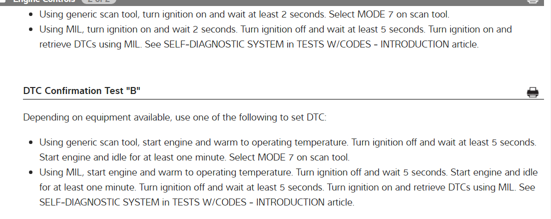

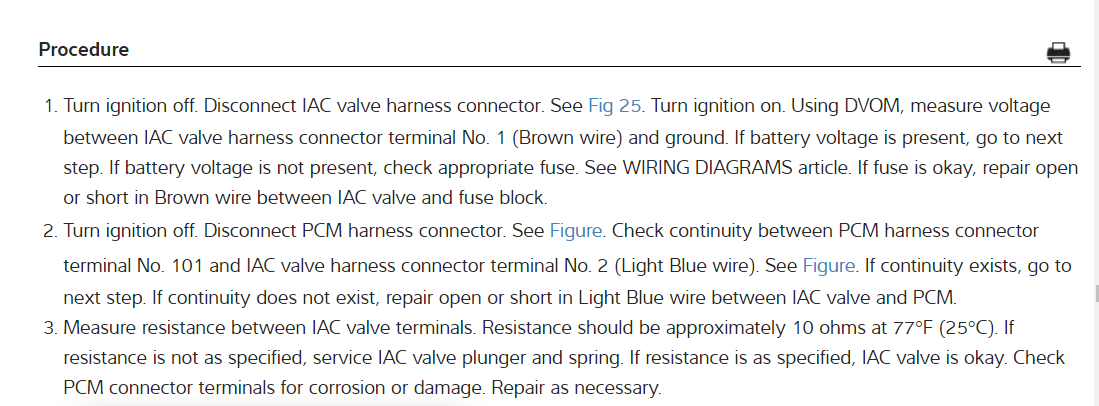

SCGRANTURISMO
  • CAR REPAIR CONTRIBUTOR
  • 4,897 POSTS

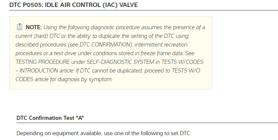

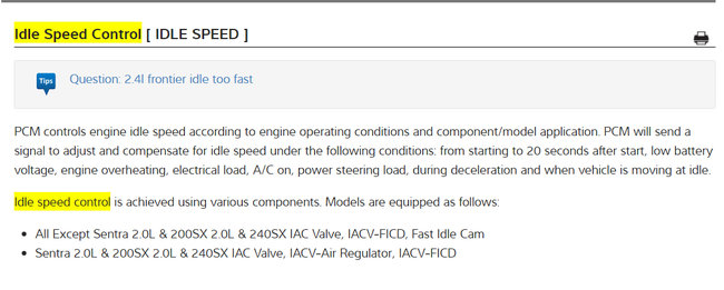

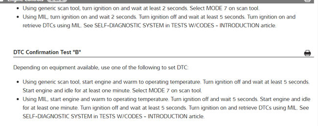

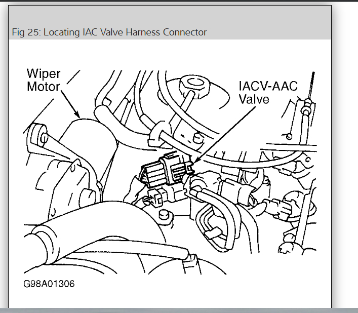

This could be a problem with your vehicle's Idle Air Control Valve (IAC). This is what your vehicle uses to get air into the engine when your throttle plate is closed. Your vehicle's Power-train Control Module (PCM) uses an electric duty cycle to open and close an internal valve that controls the amount of air going to the engine. When these valves go bad your engine will not idle and stall at idle. I have included a few links for you to go to below:
https://www.2carpros.com/articles/how-to-replace-an-idle-speed-control-motor-iac
I have also included in the diagrams down below a troubleshooting guideline as to what to check when you have this problem. I have also included factory troubleshooting chart for the Idle Air Control Valve. Please go through the guides and get back to us with what you are able to find out, please.

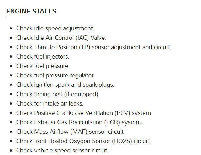

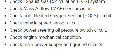

Hello again,
The misplaces hose sounds like your Positive Crankcase Ventilation hose. This is a massive vacuum leak and will cause all the symptoms you are describing. The IAC mainly deals with your vehicle at idle, controlling the air bypassing the throttle plate that is closed at idle. I have also included a few links for you to go to below as well:
https://www.2carpros.com/articles/engine-stalls
The Crankshaft Position Sensor(CKP) will also cause your engine to stall or not run, or not start as well. If your blink codes are indicating this, I would definitely change this as well. Your vehicle uses this input from the CKP to determine the rotational speed(rpm's) of the crankshaft and monitors it for engine misfires. If no signal or a break in the signal is present the engine will not run as the PCM will not relize the engine is running.
Please go through these guides and get back to us with what you are able to find out please.

SCGRANTURISMO
  • 4,897 POSTS
Hello again,
Okay, that's good. Have you checked your IAC valve yet?

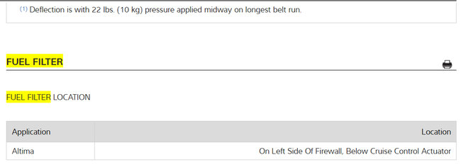

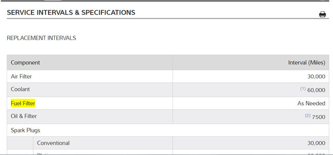

SCGRANTURISMO
  • 4,897 POSTS

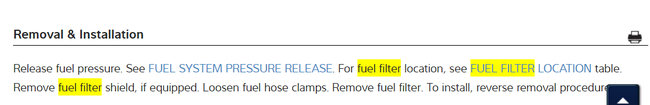

Sure. If the filter gets clocked it would definitely cause idle issues and poor, erratic acceleration until it hits a spot and will have enough fuel passing through it that will start to run fine again. I have included a link for you to go to below:
https://www.2carpros.com/articles/how-to-change-a-fuel-filter
I have also included vehicle specific information for your vehicle in the diagrams down below. Please go through these guides and get back to us with what you find out.

JEFF HERMAN
  • 486 POSTS
I could not check the IAC because I could only loosen the top screw and the bottom one feels like the head is damaged. They should have used hex head bolts instead of phillips screws. I will have to remove the throttle body to get the IAC out. Problem there is the cap screws were to tight and I didn't want to break them. What I did find was oil inside the distributor and it probably interfered with the optical pickup of the cam sensor. I sprayed it good with contact cleaner and it seems to be fine again. I'll probably have the replace the o-ring on the shaft of the distributor soon.
SCGRANTURISMO
  • 4,897 POSTS
Hello again,
Great, so you fixed the problem. That is what we want to hear. Good job! Please, if you should have any other questions, please feel free to ask. It's why we are here.
