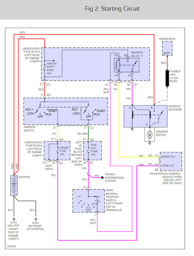

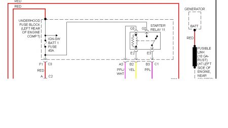

It sounds like the immobilizer is engaged. Does the security light flash when you try to crank it over? Here are the wiring diagrams for the starter motor and security system so we can see how it works. There is a starter relay that needs to be checked. Here is a guide to help us get started:

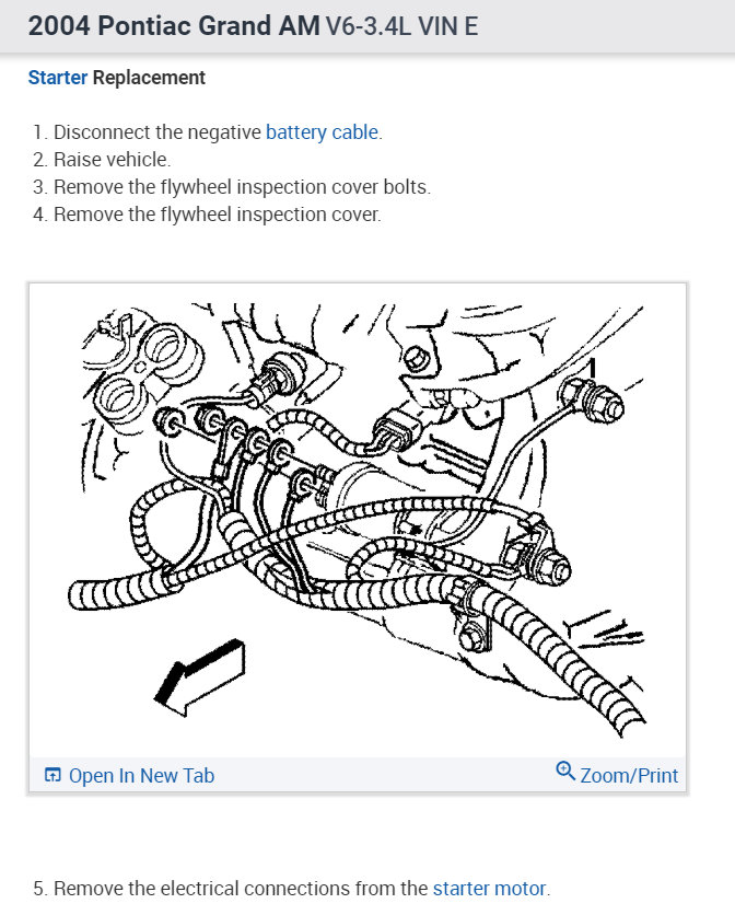

2005 Pontiac Grand AM V6-3.4L VIN E
Procedures
STARTER MOTOR REPLACEMENT
REMOVAL PROCEDURE
1. Disconnect the negative battery cable.
2. Raise vehicle. Refer to Vehicle Lifting.
3. Remove the flywheel inspection cover bolts.
4. Remove the flywheel inspection cover.

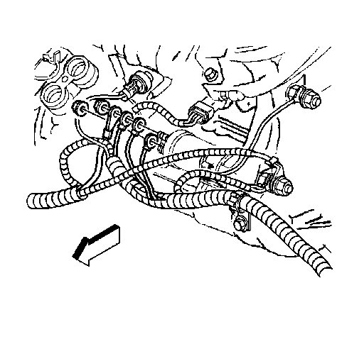

pic 1

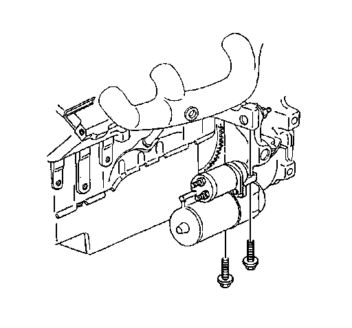

5. Remove the electrical connections from the starter motor.
pic 2

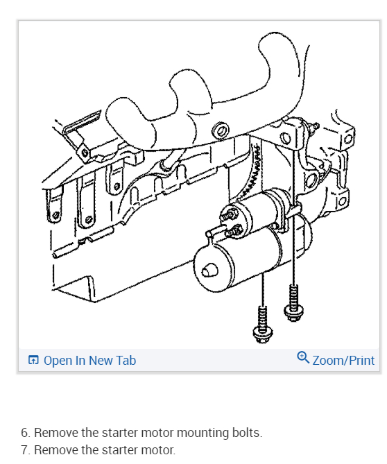

6. Remove the starter motor mounting bolts.
7. Remove the starter motor.

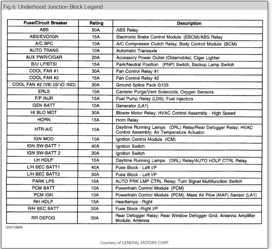

INSTALLATION PROCEDURE
pic 3
1. Install the starter motor to the engine.
NOTE:
- Before installing the starter motor to the engine, tighten the nut next to the cap on the solenoid BAT terminal. If this terminal is not tight in the solenoid cap, the cap may be damaged during installation of electrical connections and cause the starter motor to fail later.
- Refer to Fastener Notice in Service Precautions.
2. Install the starter motor mounting bolts.
Tighten the bolts to 40 Nm (30 lb ft).
pic 4
3. Install the electrical connection to the battery terminal on the solenoid.
Tighten the battery terminal nut to 17 Nm (13 lb ft).
4. Install the electrical connections to the S terminal on the solenoid.
Tighten solenoid S terminal nut to 3 Nm (27 lb in).
5. Install the flywheel inspection cover.
6. Install the flywheel inspection cover bolts.
Tighten the flywheel inspection cover bolts to 10 Nm (89 lb in).
7. Lower vehicle.
8. Connect the negative battery cable.

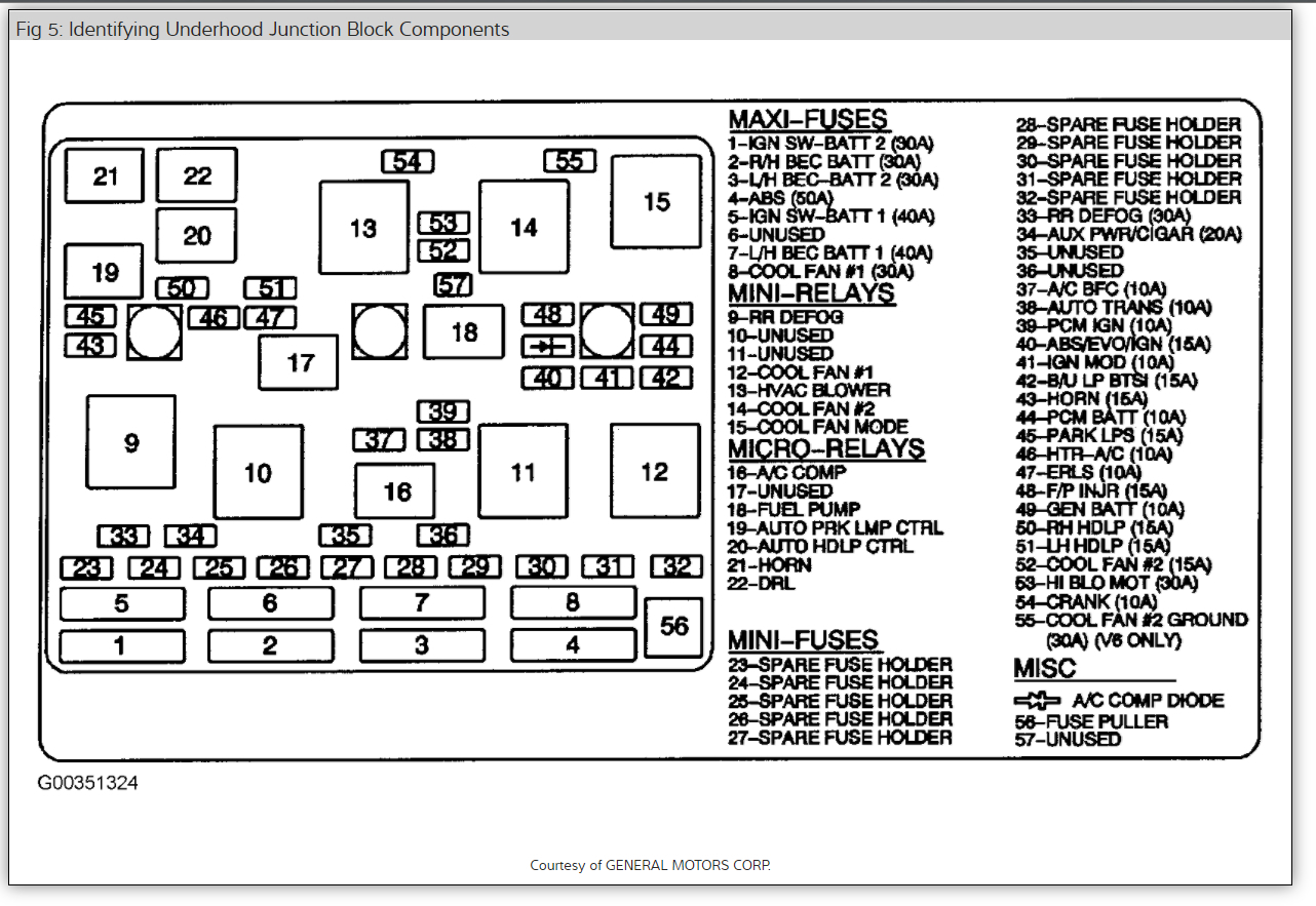

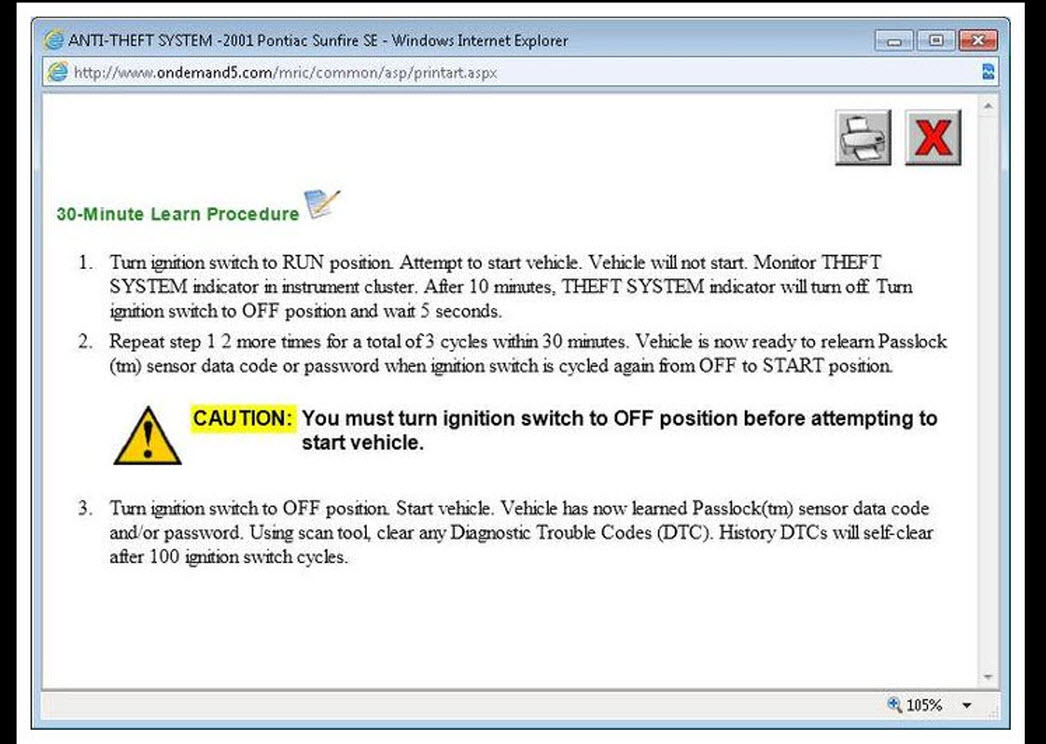

Also try resetting anti theft on this. See pic
+4
Friday, July 31st, 2020 AT 9:49 AM (Merged)

If the starter is good, you need to check to see if there is power to it in the start position. If there isn't, you need to work back to the starter relay, ignition switch. NOTE: Always make sure the battery is fully charged and all connections are clean and tight.

HMAC300
  • 48,601 POSTS
Try resetting anti theft like it shows in pic, GM changed anti theft around the age of your vehicle but this may not be correct. Ifyou have a manual check in that as well fro resetting security system. A lot of times with no starts this is the problem. If it still doesn't stat have a pro scan it as it still may be a security issue but he will need to find problem with it.
+1
JMINAUSTIN
Thanks for your quick response! The Dashboard Security light had crossed my mind as a possible cause of the starting problem. It's been ON constantly since I had some cooling system work done on this car last November. However, the car's started & run OK since then, so I've ignored the light. Anyhow, I tried your suggested fix and, WOW, it worked! My Grand Am now promptly starts & runs fine. Restarted 3-4 times. All OK. And, best of all - that pesky Security light is no longer glaring at me from the dashboard. MANY THANKS & have a great week! JM
