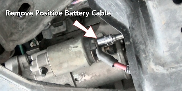

You must disconnect the negative side of the battery while making sure the cable end is clear of the battery terminal to avoid an accidental connection, also raise the car on jack stands to gain access to the starter motor. If you are having troubles locating the starter, or need specific instructions for your car please ask one of ythe 2CarPros community, it is free. The image below shows the starter motor and the removal of the positive battery cable as well using a 13mm socket.
remove positive battery cable from starter

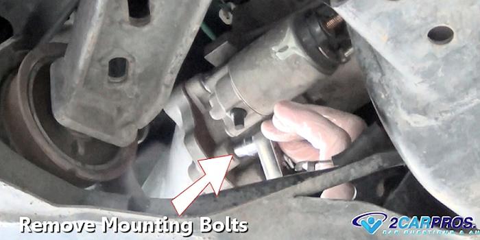

Using a flashlight, locate the starter mounting bolts, the upper bolt may be slightly hidden, also there may be two or three bolts. Use a 13mm wrench or socket to remove them, (sizes may vary).
remove starter mounting bolts

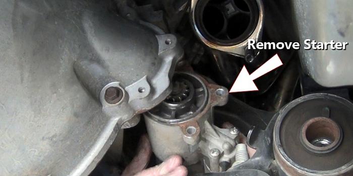

Now, the starter will become free from the bell housing or block, it weighs a few pounds so grasp the starter firmly and remove it from the engine bay area, again use a flashlight to inspect the flywheel or flex plate gear teeth condition. If wear is excessive the flywheel/flex plate will need to be replaced.
remove starter motor

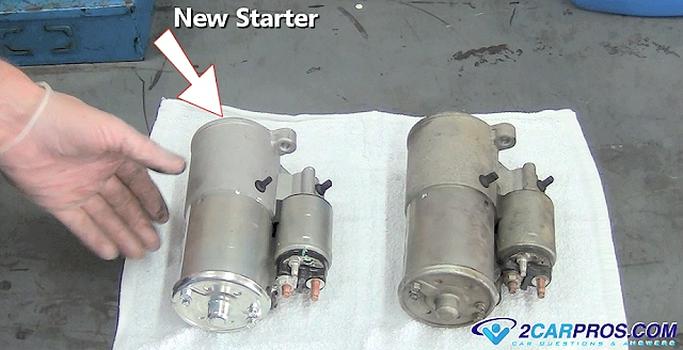

Match the old starter to the new unit to ensure a proper installation, count the teeth on the pinion gear and note the location of the mount bolts, they should be the same on both.
new starter

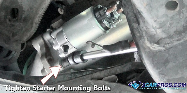

Use a socket and extension to tighten the bolts to the correct specification, which in this case is 28 foot pounds of torque, tighten evenly.
tighten starter mounting bolts
