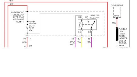

I'd have to make sure the battery has a full charge and the connections are good. Check all applicable fuse circuits for voltage. There is a starter relay in underhood fuse box, check voltage circuits. The purple wire at starter solenoid should be hot with key in the crank position. Did you try cranking in neutral? Anytime the starter wiring system, shows the pcm involved, I have to ask about the security system?

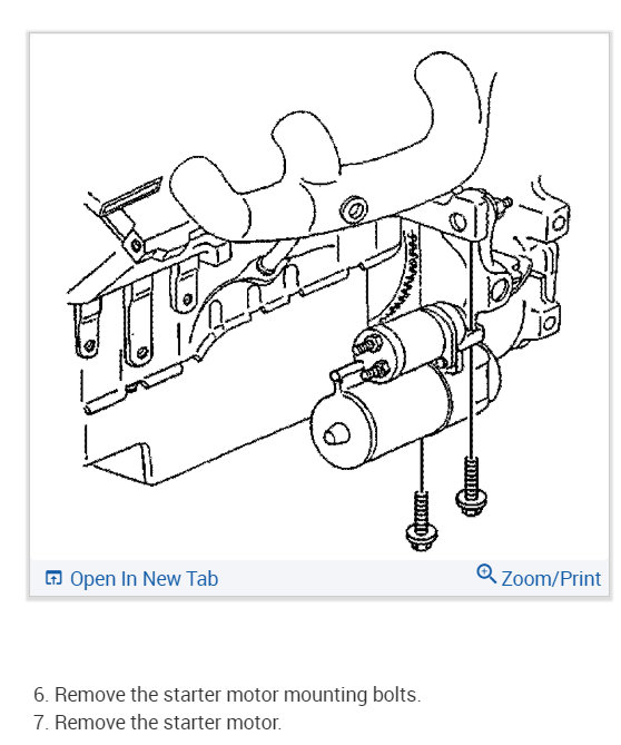

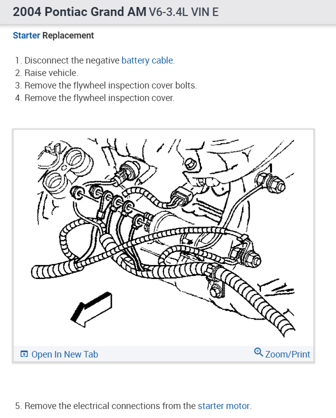

Tried to start my '03 Grand Am, and it wouldn't even attempt to turn over. All lights/dash lights are bright, heater, radio work just fine. I checked all fuses, nothing. Tightened gas cap, nothing. Checked battery cable connections, nothing still. I took a screwdriver and crossed positive & negative posts on starter and it spun but did not engage. I was thinking it was the starter, but why wouldn't it at least spin when i turned the ignition? And even if it did, it's not engaging so could there be more to it than just a faulty starter motor?

Try bench testing the starter off of the car before buying a new one.

You can do it yourself with a set of jumper cables and your car battery, but if you are not experienced in mechanics then you might want to have a local repair shop test it for your safety. If you want instructions on how to do it yourself just let me know.

Yes, similar. More detailed though. This can be done with a set of booster cables. Hook the positve to the starter solenoid, get the clamp on the main power stud to the starter and the smaller solenoid power stud. The other end of positive goes to batteries positive. The negative booster cable gets hooked to the battery negative. Be careful because you'll be making sparks so don't have any flammable substances anywhere near. Clamp down the starter. Touch the starter end of the negative cable to the body of the starter (somewhere around the bolt holes will work). You'll get some spark and the starter will give a jump. You should hear/see the starter work. What you're looking for is the starter drive to jump out to the end of the nose cone and spin. If this doesn't happen then the starter needs replacing. If this does happen then check the one way clutch on the starter drive. Pry against the starter drive gear with a screw driver. It should turn one way but not the other, there is a one way clutch in the drive. If it turns fairly freely both ways the drive is shot. Like I said, you are probably better off just taking it out and getting it tested at a local shop. Sorry I can't be of more help.
