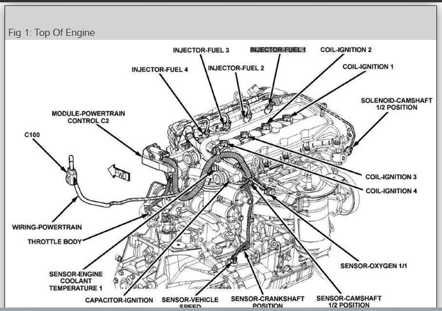

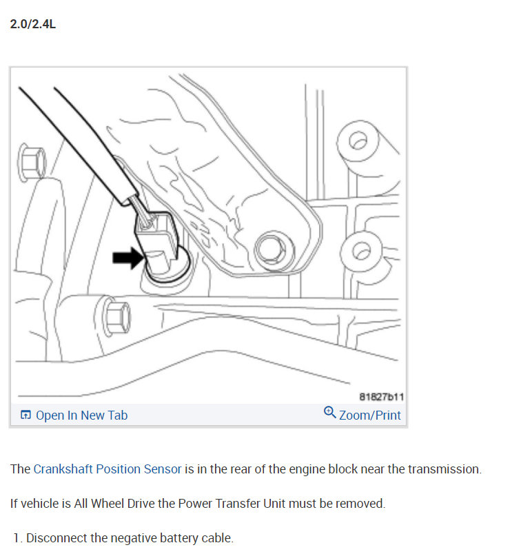

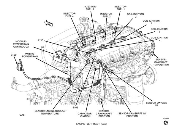

This could be a problem with your vehicle's Crankshaft Position Sensor (CKP). It keeps track of the crankshaft and your vehicle's Power-train Control Module (PCM) uses this information for crankshaft speed, location in four stroke cycle, and misfire monitor. Your vehicle's engine needs this information to start. I have included a few links down below for you to go to:
https://www.2carpros.com/articles/how-a-crank-shaft-angle-sensor-works
I have also included the location of your vehicle's CKP in the diagrams down below. Please go through these guides and get back to us with what you find out please.

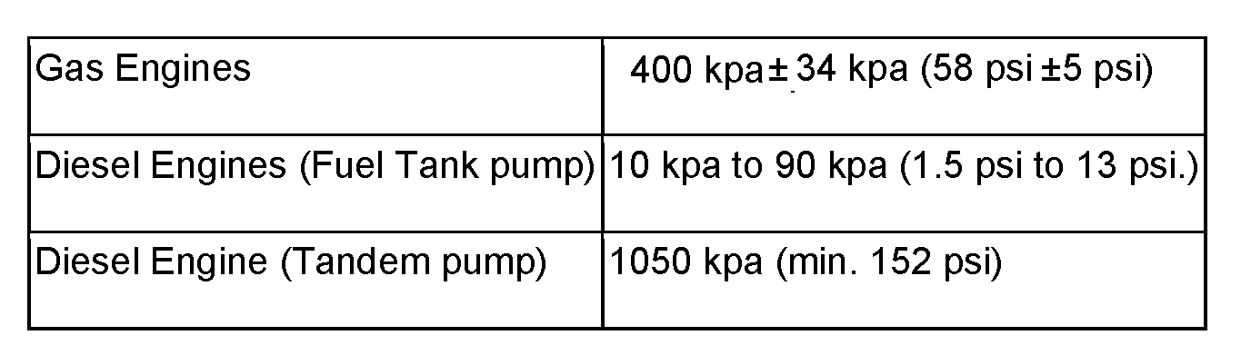

__________________________________________

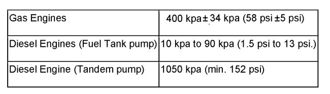

Picture 1 are the fuel pressure specs.

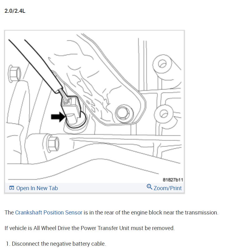

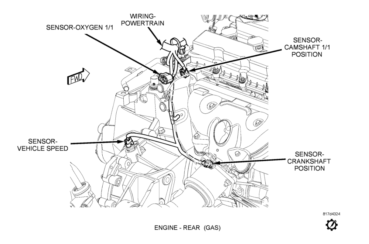

It sounds like you have a main relay or crankshaft angle sensor that is out but to be sure lets run down this guide. When you turn the key to the on position without cranking the engine over can you hear the fuel pump run in the tank for 5 seconds?
here is the crankshaft position sensor just in case. Check out the diagrams (Below). Let us know what happens and please upload pictures or videos of the problem.

REMCCK
Checked codes found the crankshaft sensor was not working I got a new one and it fired up! thanks for your help this is a great site I cant believe it is free :)

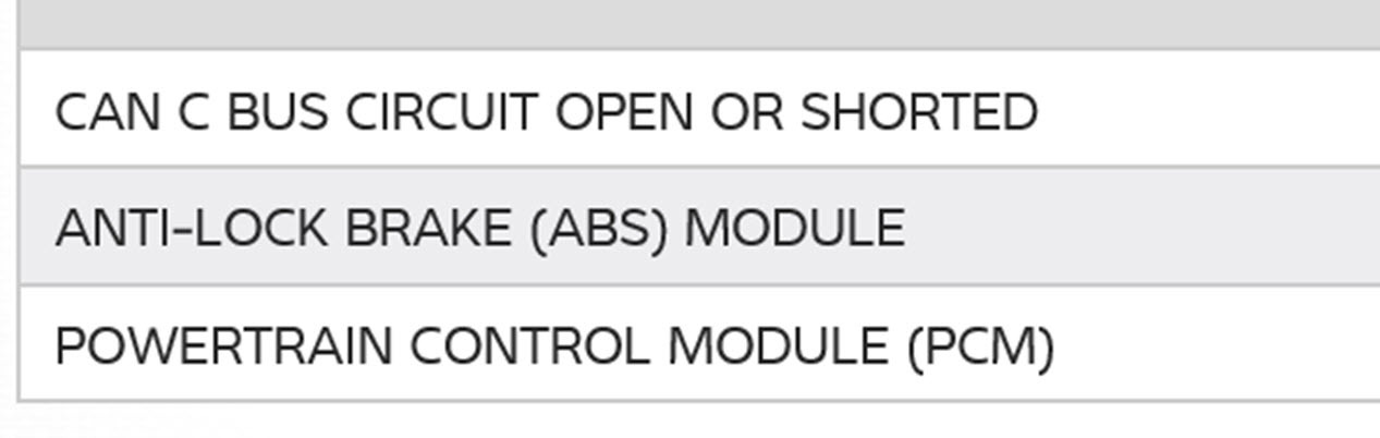

Hello. I have a 2007 Dodge Caliber SXT. About two months ago I went to Jiffy Lube for an oil change service and to have new front brakes installed on my vehicle. Two weeks later, I also replaced all four tires. The day that I replaced the tires, my check engine light came on. Later that day, I ran a few errands and, after my final errand, as I attempted to start the car to head home, the engine would not start. It was turning over, but the car itself would not start. A friend gave me a jump and the next day I headed to AutoZone for a diagnostic check.
The check came up with the following codes: U1110, U1120, U1412. They also checked my battery and said that it was fine and did not need to be replaced. I drove the car for a few weeks after that and had no problems.
A couple of days ago, I tried to start the car and again, the engine would not start. Would you be able to give me an idea of what the problem may be, before I go to a lot of expense and head to a mechanic? I have never had any sort of engine trouble with the car before and the timing of all of this is making me wonder if the recent work that I’ve had done on the car was faulty and may be the root of the problem?
Dec 31, 2020 at 9:49 AM (Merged)
HMAC300
  • CAR REPAIR CONTRIBUTOR
  • 48,601 POSTS
this is a toughy because your can bus has lost communication for a speed sensor. all of t hese codes relate to what is in the pic. which i'd kind of believe it may be a shorted wire. This can be caused by nearly anything even a poor connection. A mechanic will definitely h ave to look at this and can't really give you a price because they vary all over and this may be a easy job or hard which involves time. I doubt it is from changing oil but tell the mechanic about the brakes job as well as something may have been damaged there. also nothing more than changing oil and filter should ever be done at one of these places. nothing more most are not qualified to do this type of work.
