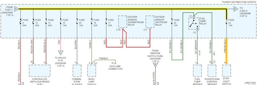

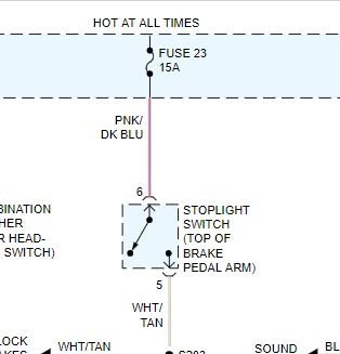

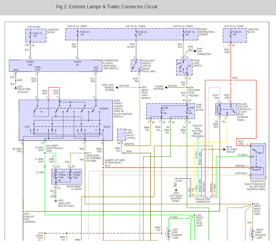

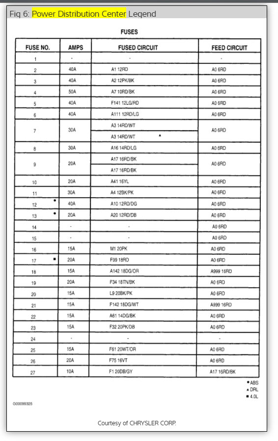

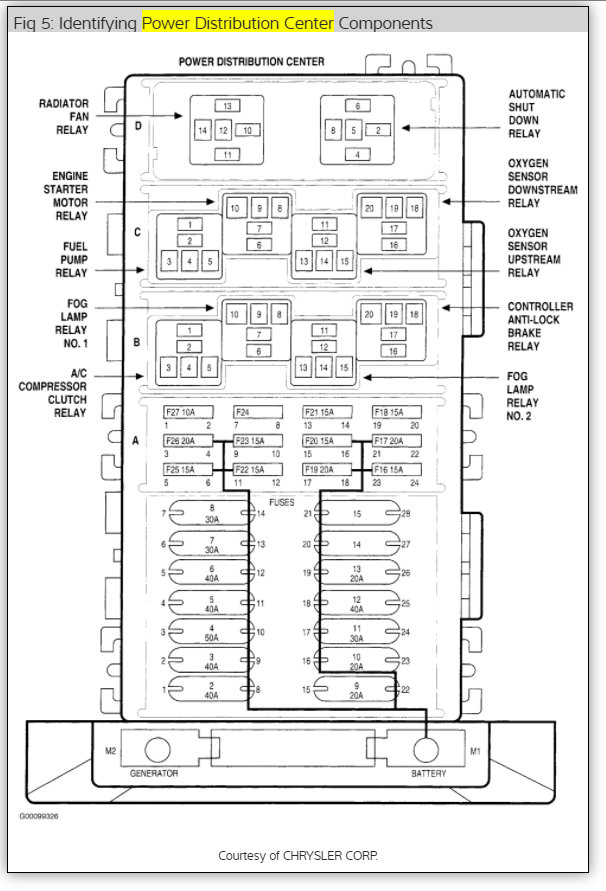

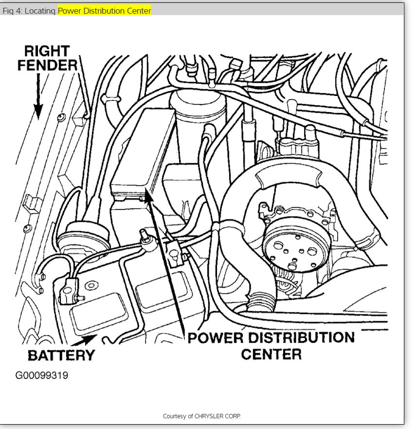

What type of Cherokee is this?
You have a fuse in the power distribution box that powers the brake switch. It is number 23 15 amp.
The wire colors at the brake switch is tan/white and pink/dark blue confirm this. You should have power at pink/dark blue at all times.
When you depress the brake both should have power.
This is the best I could do with EWD image you need to blow it up, need more help comeback.
https://www.2carpros.com/forum/automotive_pictures/12900_cherokee_EWD_1.jpg
+9
Monday, March 10th, 2008 AT 5:04 PM

  • 75,992 POSTS
The pink/white wire should always have power-depressing the plunger should open the circuit and depressing it should transfer power to the white/tan wire.
+1
Tuesday, March 11th, 2008 AT 3:47 PM
  • 75,992 POSTS
Thanks for all your help. Under hood fuse 23 was the problem.

PLGXX
Hi rasmataz,

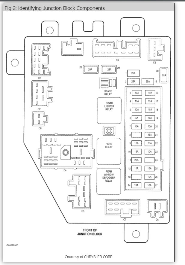

Fuse number 23 under the hood fixed Dave's 2000 Jeep Sport. I do not have a number 23 on my 1999 Grand Cherokee Laredo. (The slot is empty). Would you know which fuse/plug thing might help my brake light problem?
Monday, April 14th, 2008 AT 10:51 PM
  • 75,992 POSTS
I do not. what is going on? I came up for yours the same fuse at number 23 see below.
https://www.2carpros.com/forum/automotive_pictures/12900_brake_3.jpg
+8
Tuesday, April 15th, 2008 AT 2:50 AM
PLGXX
Okay got it. That one is under the driver side dash. I thought maybe you were referring to the fuses in the black box under the hood.
Number 23 under the dash is my problem. It keeps blowing. I read about changing the the turn signal switch so I changed it and bam! All fixed.

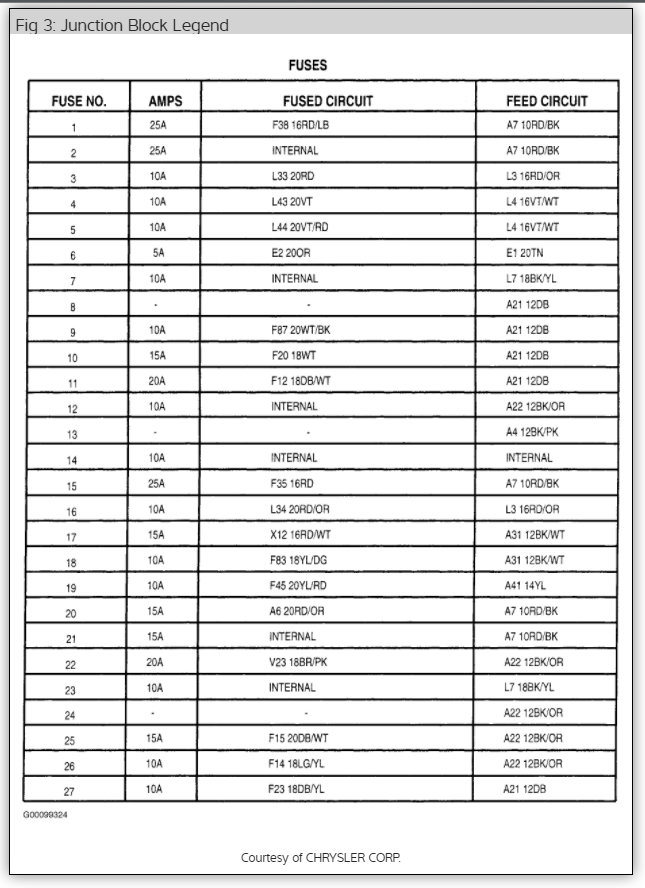

I have no brake lights at all on my vehicle listed above Sport. I have no power to the brake switch on the lower column (pink wire), but I have power to and through fuse 22, which by the wiring schematic I have is supposed to supply power to that switch.
+1
Thursday, November 12th, 2020 AT 12:23 PM (Merged)
  • 108,269 POSTS
Welcome to 2CarPros.

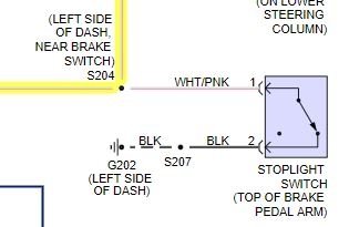

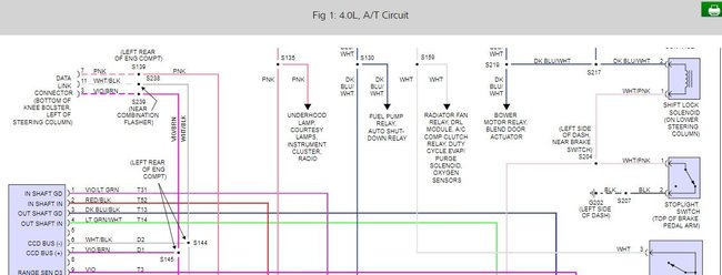

If there is power at the fuse, does it exit the fuse box? You could have power available that goes nowhere because of a bad fuse, pushed out pin in the box, or a bad connection. If the power does leave the fuse box to the switch, there has to be a break in the wiring at some point preventing the power from reaching the switch.
I cut a portion of my schematic for you to compare to what you have. See if it is the same. If it is and the power leaves the fuse box but is lost at some point between the box and the switch, the only thing you can do is start tracing that wire and determine where it is broken.

Well that is interesting. The schematic that I am using (Haynes manual, Cherokee 84-01 copyright date 2005) designates the fuse as #22 and I see that your schematic designates #23. Although they (the schematics) are identical otherwise. Guess I'll be checking #23 in the morning. And yes the fuse in 22 is good and lights at both test posts.
+1
  • 108,269 POSTS
Welcome back:
Let me know what you find. If the fuse is good and lights on both sides, we have an open circuit between the fuse box and the switch.
I just doubled checked on another schematic and the fuses are correct that I said, but I found one thing of interest. There is a splice to power the switch. Take a look at the schematic I added. I just cut out the section I am referring to. You may want to also check that splice to make sure it isn't corroded or damaged. That will cause the issue for sure.

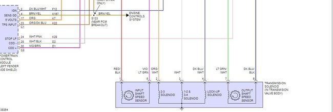

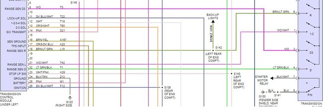

BOB 1950
  • 7 POSTS

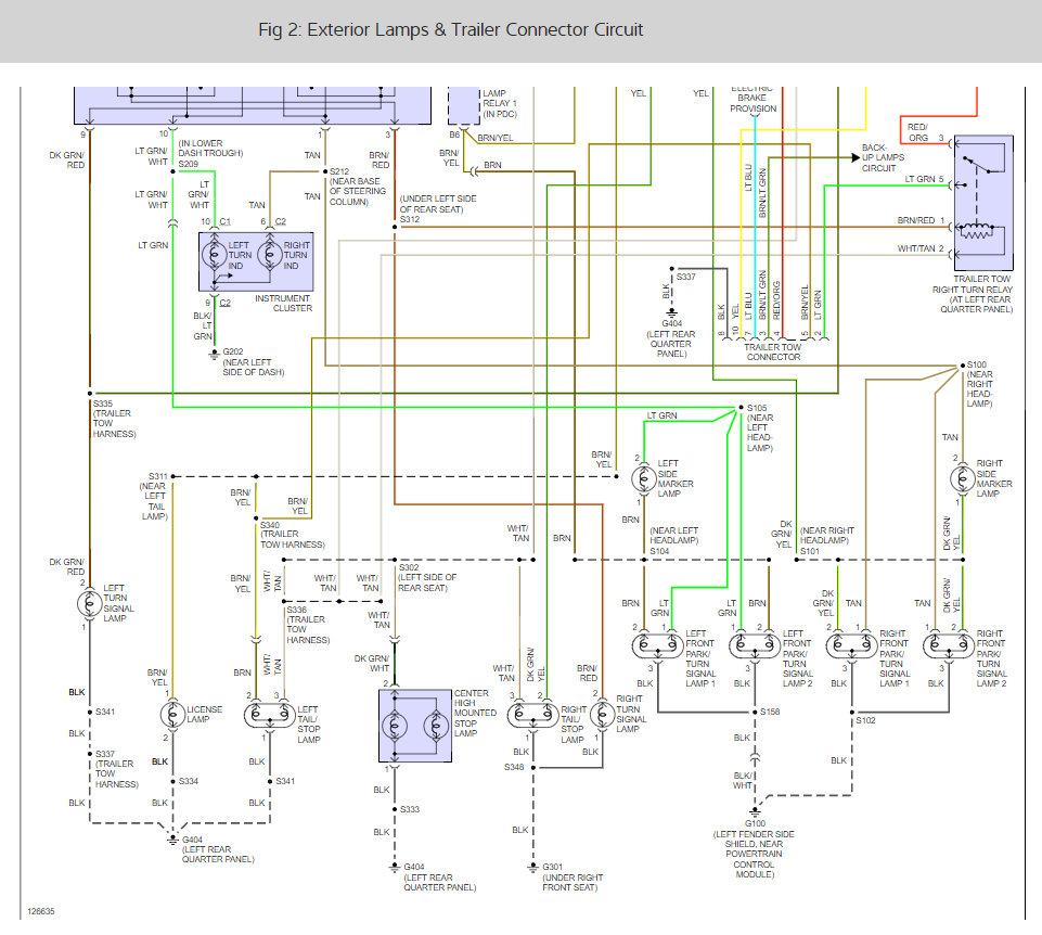

Hello. Hmm, okay, thanks. Any chance that I could get an expanded shot of that splice specifically? Wondering what the yellow-outlined unit is. I have a white/pink line going to the brake switch, and there was power there. I'll be diving back in later today.
  • 108,269 POSTS
Welcome back:
I highlighted the white/pink wire so you could easily see what I was talking about. That's why it looks yellow.
I attached the entire schematic for you, I had to break it into a few pictures because of its size. The pictures are in order and I overlapped them so you could follow from one to the next.
Let me know if this helps.

Whew. Dayum long week, lots of late nights working. I took a second and found that I had no power going to fuse location #23. And the Haynes wiring schematic is not good! I'm not discerning where the power comes from, and don't look forward to a major tear-apart to trace it back. Any knowledge? Thanks.
