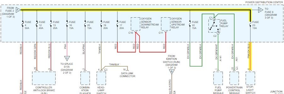

No. My taillights are both working, and the directional's, even though fuse #23 has no power to it. Still no brake lights. I'm needing to know where is the source of power to 23 supposed to be.
Thursday, November 12th, 2020 AT 12:23 PM (Merged)
  • 110,194 POSTS
According to the schematic, it comes from fuse 2 of the junction box. However, take a look at the picture. If there was not power from fuse 2 (40 amp) many other things would not work. I highlighted the supply. I have a feeling the box itself has failed or melted internally for fuse 23. Take a look at the pic and let me know your thoughts. You may have to disconnect the battery and remove this fuse box to inspect it from the underside.
