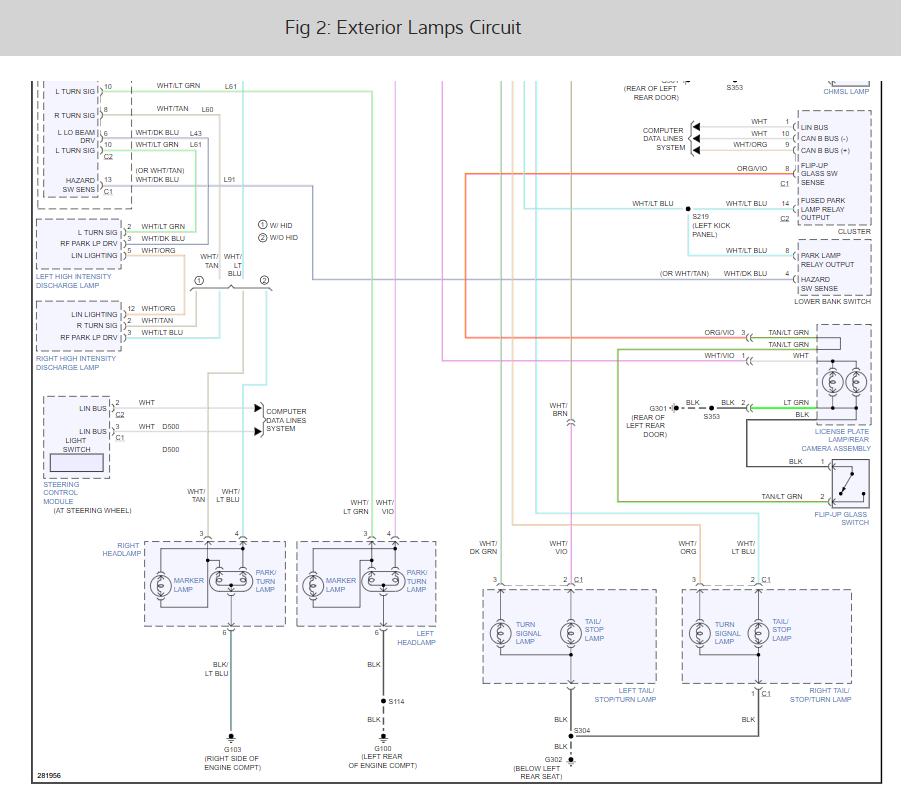

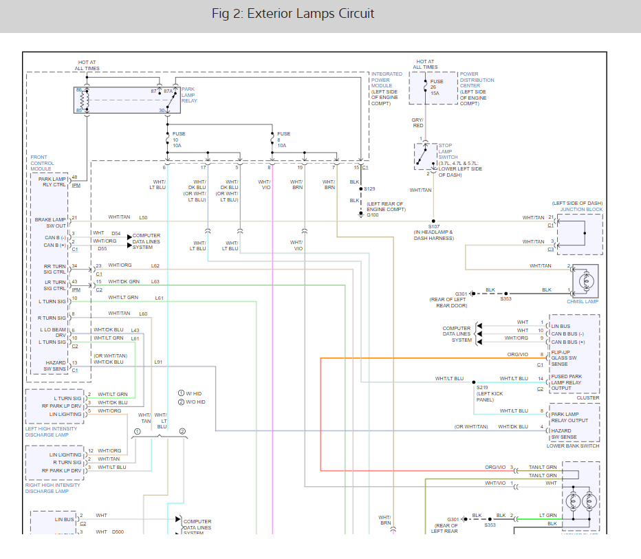

When I press the brake, all three brake lights come on. When I turn on the headlights, the left rear taillight does not come on and if I press the brake with headlights on, the left rear brake light does not work. If I am pressing the brake, the light is on, but if, while pressing the brake, I turn the headlights on, the light goes out?
Tuesday, March 23rd, 2010 AT 6:39 PM
18 Replies
MERLIN2021
  • 17,250 POSTS

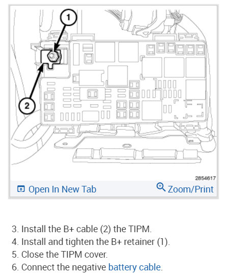

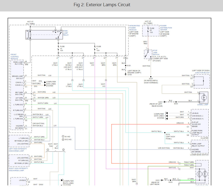

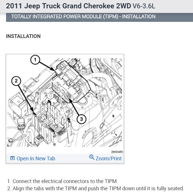

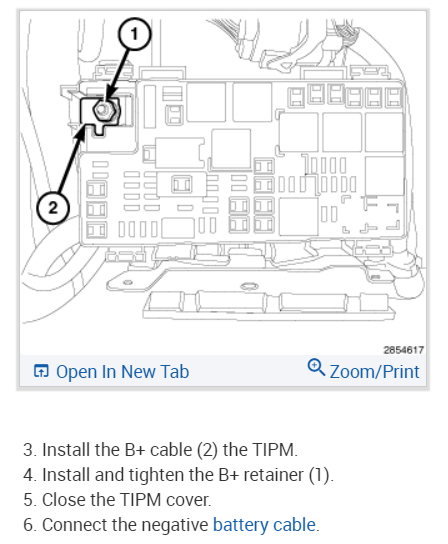

It sounds like the front control module is out which is common here is the brake light wiring diagrams so you can see how the stem works with the instructions on how to change out the front control module which is easy because it self initializes. Check out the diagrams (below). Please let us know what you find.
Thursday, March 25th, 2010 AT 2:21 PM

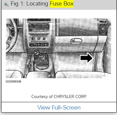

I have the Sport model. I recently found out that my brake lights are not working. All of the running lights/parking lights work on the front and rear but nothing happens when I push the brake pedal. My turn signals also work. I have checked all the fuses and bulbs. They all seem to be okay. All other lights are in working order. What components could be at fault and is this something I can fix myself? The brakes themselves work fine. It is just the brake lights that are not working.
+1
Thursday, November 12th, 2020 AT 12:16 PM (Merged)
BMRFIXIT
  • 19,053 POSTS

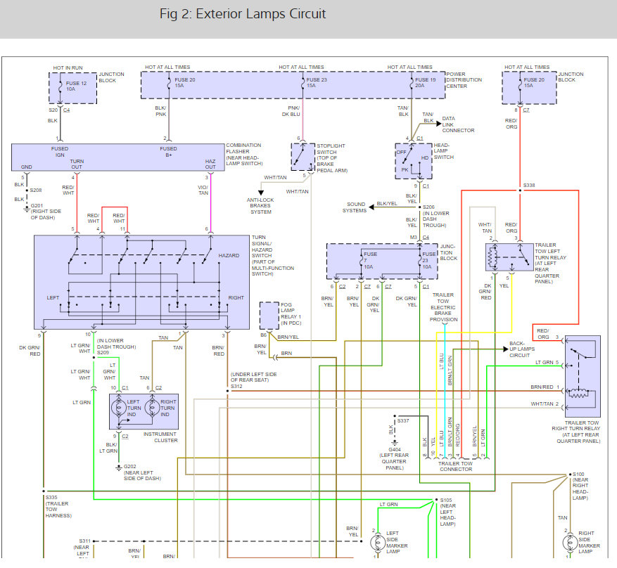

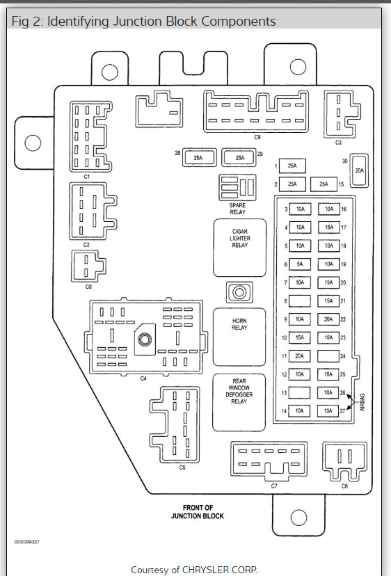

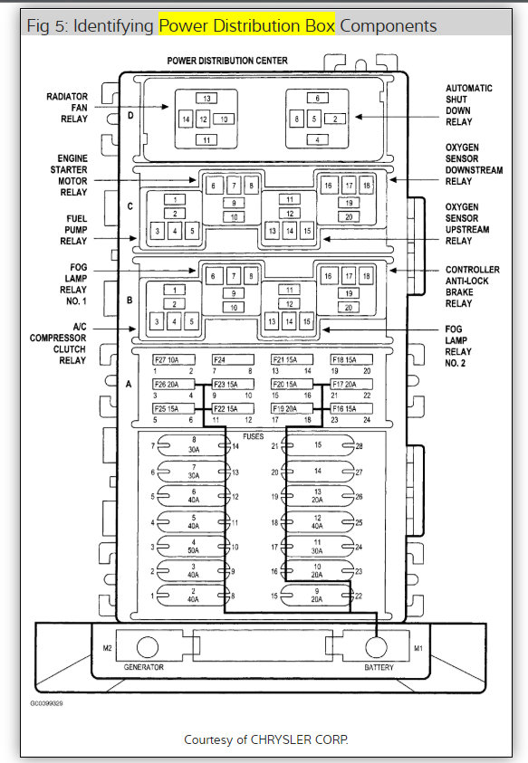

This sounds like the fuse#12, 20, 23 and 19 or the brake light switch is out. Here is a guide to help you test for power through the switch and fuse with the wiring and fuse diagrams to help you with the test:
This brake light wiring diagrams will show you which ones to check
Cheers
JEEP001
Thanks for the guides. I did some testing and It was the switch I got a new one for $43.00 and all set! I love this site btw.

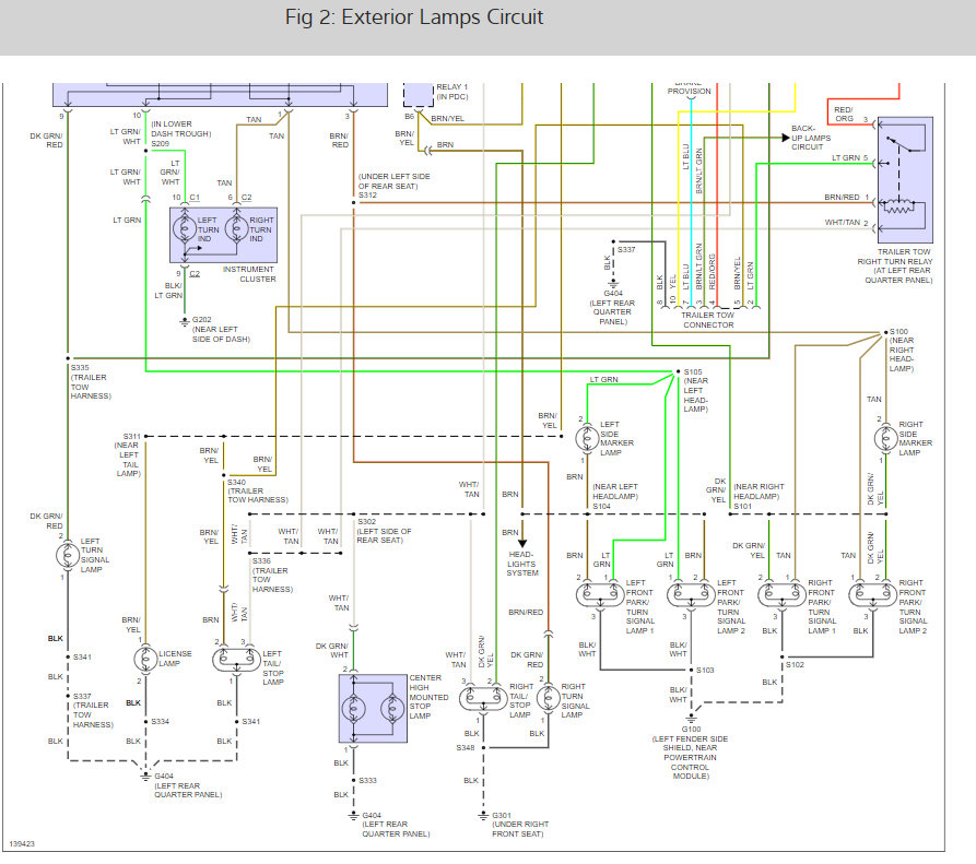

As your stop light circuit, turn signal, hazard, and trailer tow circuits all use the same filament of the tail/stop/turn combination light bulb, you have to check EVERY single bulb that you have on the truck front and back, to make sure that they are all operational.

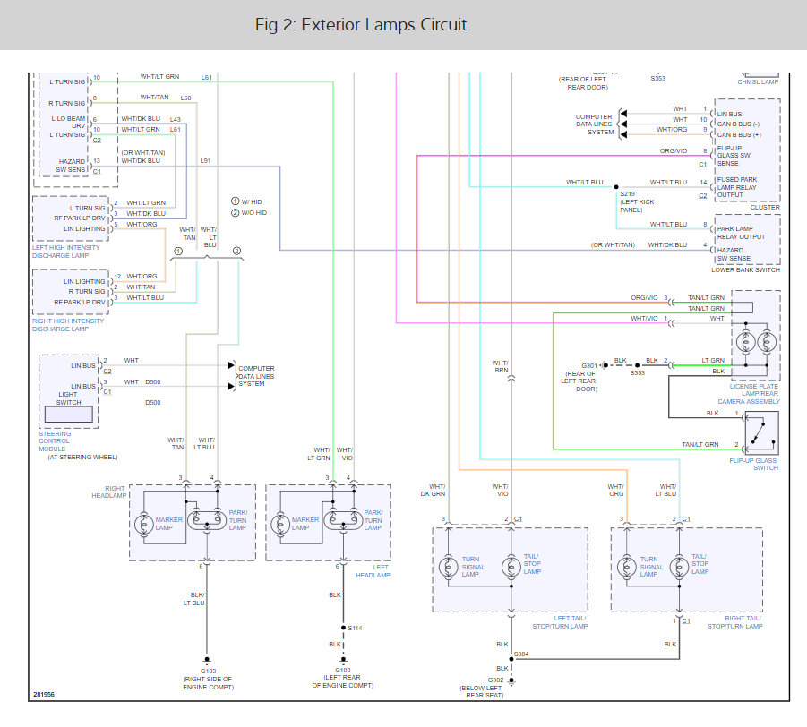

Driver side rear lights - when I turn on the lights, all tail lights are okay but when I press the brake pedal all lights go out on the rear driver side. Without lights on the brake light on the left side doesn't work. Turn signal, tail light, and backup lights work until you step on the brake. Every thing works on the passenger side. I changed the brake light bulb, no help. I switched the passenger side and the driver side taillight assembly and the driver's side unit will not work on the passenger side but the passenger side unit will work on the driver's side. Suggestions?
Thursday, November 12th, 2020 AT 12:17 PM (Merged)
  • 75,992 POSTS
I switched the passenger side and the driver side taillight assembly and the driver's side unit will not work on the passenger side but the passenger side unit will work on the driver's side. Do a continuity test the left assembly if it is a wiring problem it will do it with the right side.
MERLIN2021
  • 17,250 POSTS
If the unit works on the opposite side, you have to trace the wires.

I have a Jeep Grand Cherokee 2000 that had the same problem. I did not notice it until a kind soul shouted at an intersection that my brake lights were off! In New York City, it is illegal to have non-functional head-beams and brake lights. Luckily, searching Google, I found a fix that worked for me. Here is a copy of the procedure:
1. Remove the tail light assembly. Most of you know how to remove the light assembly if you have changed bulbs, so I will not cover that.
2. Disconnect the wiring harness by sliding the red locking clip to the side in order to press the side of the male connector and pull apart.
3. Once you have got the tail assembly away from the vehicle and on a bench, remove the light socket for the tail/brake light. You will see three silver contact points inside the black plastic ring. Two are grouped together and there is one that is opposite of the two. The one by itself is the ground; the other two are the contacts for the tail light and brake light. The problem lies with the ground connector. (By the way, I tested continuity with all lights and contacts including the turn signal and the reverse light to verify that the circuit board itself was good, and it was).
4. Clean all contacts with a Q-Tip and some sort of contact cleaner - rubbing alcohol will work.
5. You should notice that the ground contact is depressed into the plastic and the plastic itself is slightly warped down. I was able to use a small pair of needle nose pliers that have a forty five degree angle to press up on the contact from underneath using the opposite lip of the hole as leverage (very carefully). Once it had moved up a bit, I was able to wedge a mini-flat head screwdriver in between the metal contact and the plastic to force the contact up even further (again, very carefully). Once it looked even with the rest, gently reinsert the connector and test.
Good Luck!
