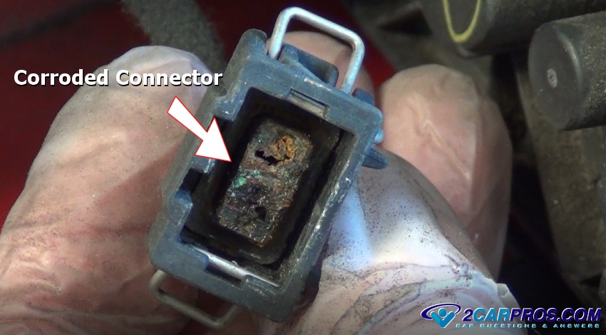

Sometimes the bulb can be good and electrical corrosion is the problem. When the bulb is removed, inspect the electrical connector terminal condition, if a slight amount of corrosion is present it can be repaired using electrical connector cleaner and a small wire brush or Exacto knife. If excessive corrosion is present the connector must be replaced as in the example below.
corroded blinker connector
