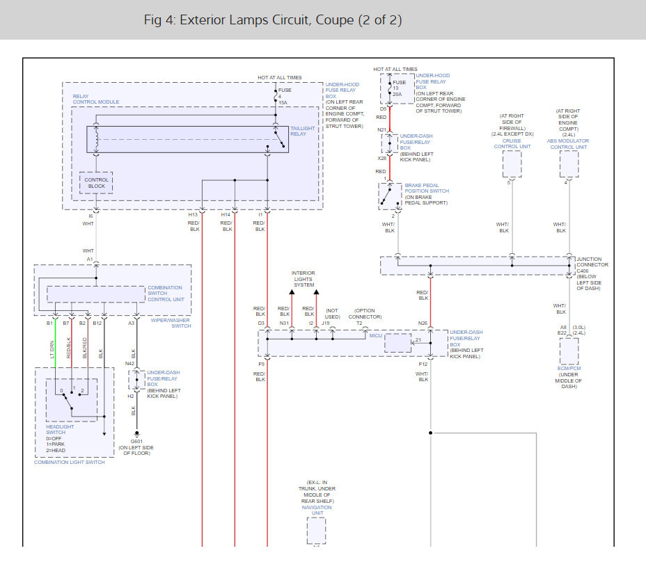

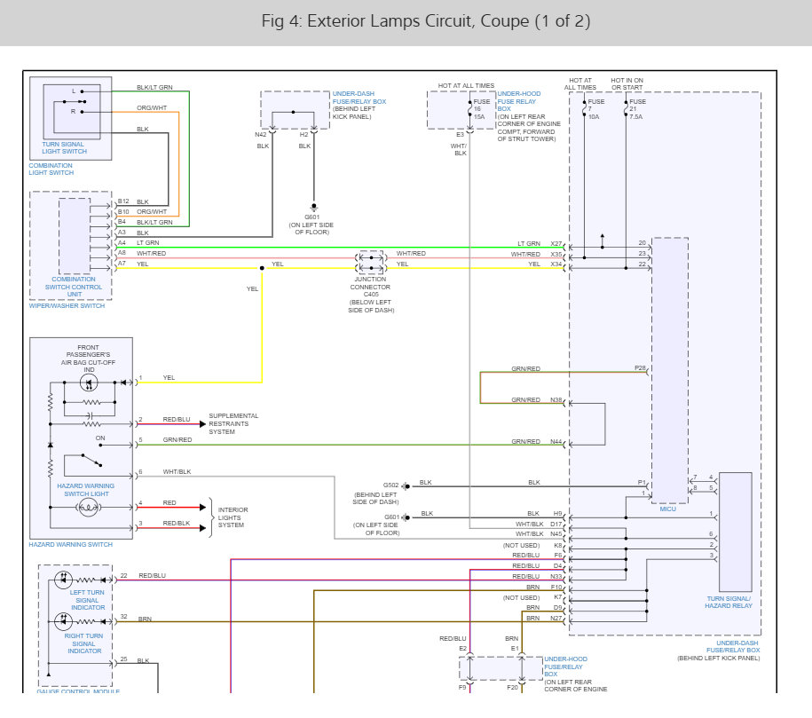

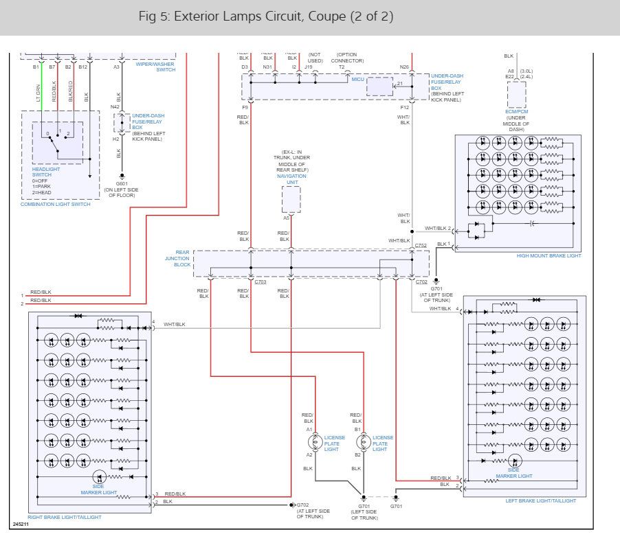

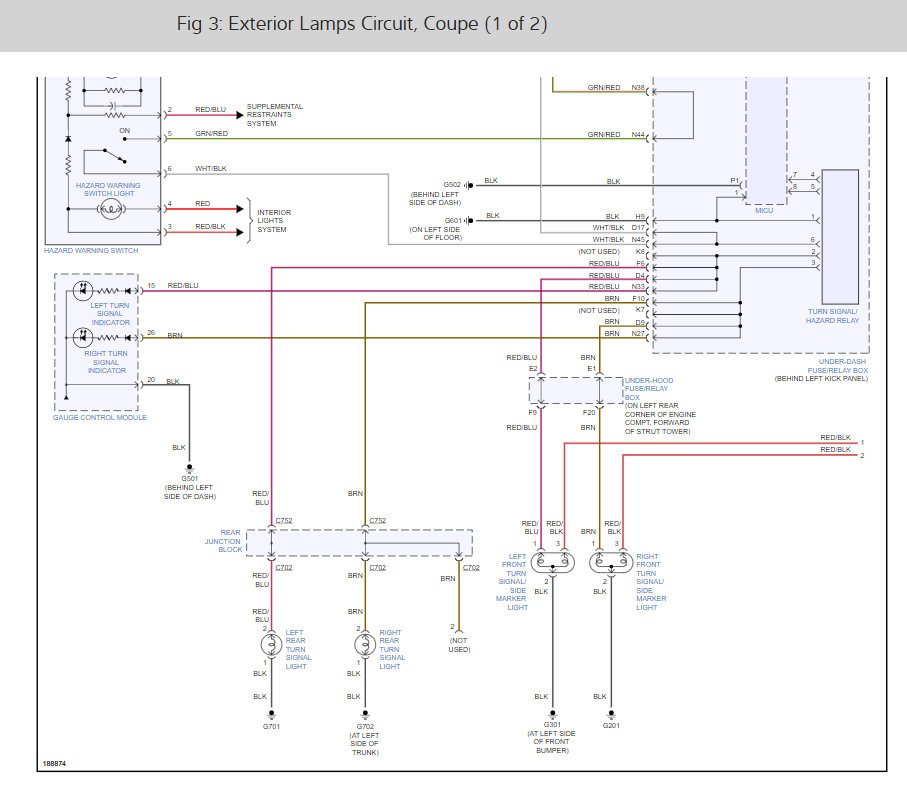

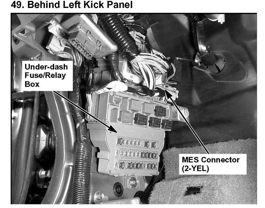

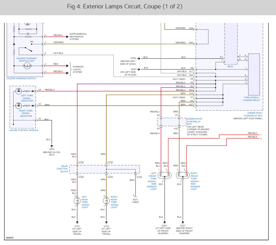

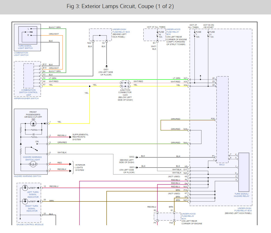

There is a light out module and a flasher that need to see if they are getting power and connecting to the remainder of the system. It sounds like the flasher has gone bad.
Here is a guide to help you see how to test the system
Here are the wiring diagrams for the blinkers etc. (below)

Something is obviously shorting out the circuit. It may be a shorted out bulb socket, or a switch such as the multi-function switch or hazard switch. It's going to take some time and a schematic to help pinpoint the problem.

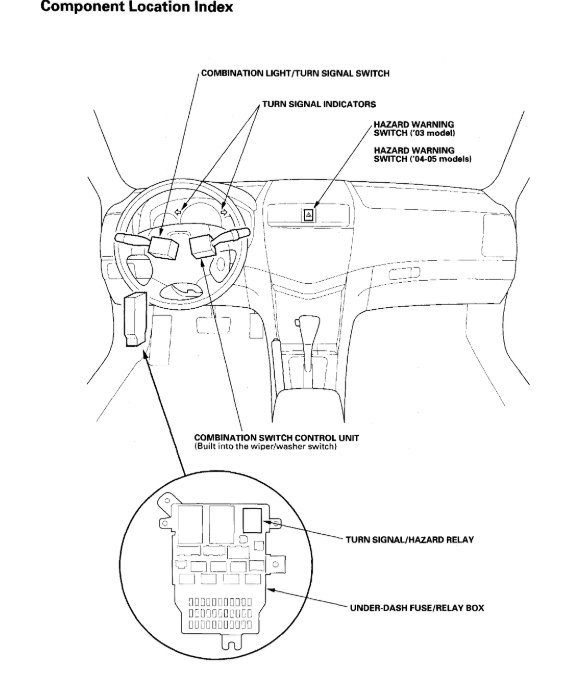

My signal lights do not work. I checked the signal fuse in the under dash fuse box and that is ok.
I asked the guy at the auto store and he sold me a flasher plug saying it goes under the dash, but is not a fuse.
I checked it out and am pretty sure I found it, but cannot remove. Small space, locked in somehow.
Is there something I need to use to remove it?
And,
Once it is replaced, will that possibly fix my signal light problem, or am I wasting my time and effort.
Thanks
Audrey
Wednesday, November 29th, 2017 AT 4:29 PM (Merged)
DAVE H
  • EXPERT

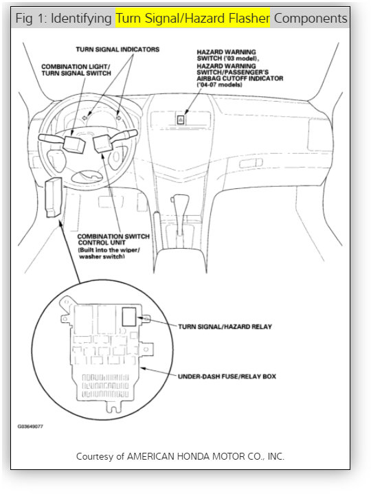

The part you have bought is the flasher relay. Yes it will probably repair your flasher's.
Turn Signal/Hazard Relay. In underdash fuse/relay box.
It just pulls out. And the new one pushes back in.
