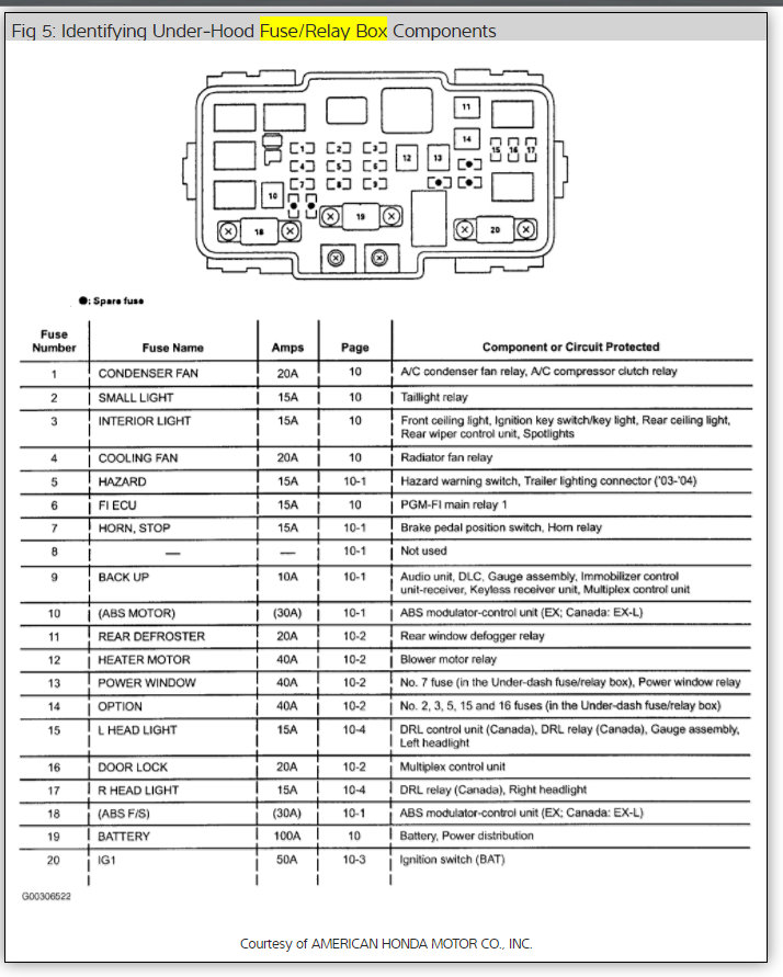

Check fuse number 2 (15 amp) in the fuse box under the hood. It powers the dash lights. It also powers the taillights and markers. If those are working the it is likely to be a bad dimmer control.

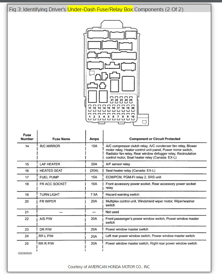

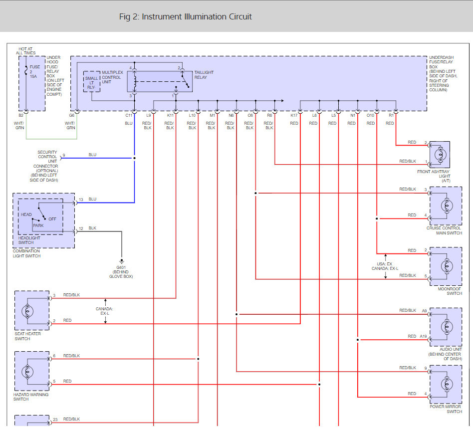

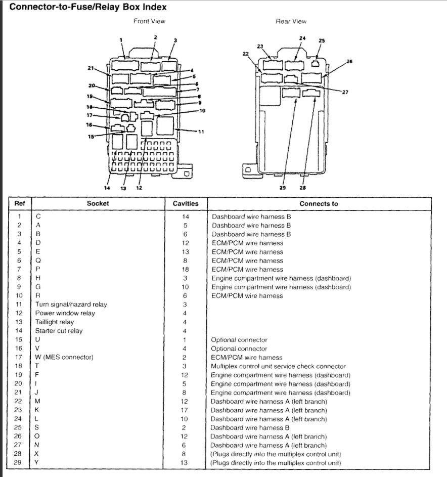

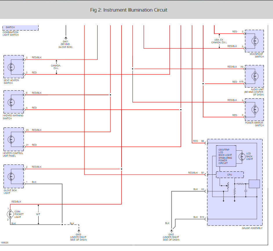

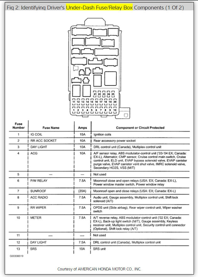

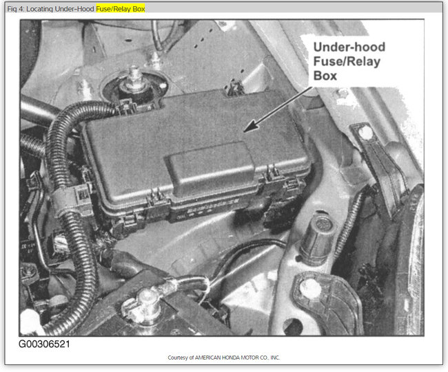

O good thanks for the extra information :) there is a taillight relay that sounds like it is out which controls the lighting system. Here is a wiring diagram and the location of the relay with a guide to help confirm the problem.
and
The relay is #13 in the under hood fuse panel
Here it is for $9.00 on Amazon
https://www.amazon.com/gp/product/B001UEHMCO/ref=as_li_qf_sp_asin_il_tl?ie=UTF8&tag=2carprcom-20&camp=1789&creative=9325&linkCode=as2&creativeASIN=B001UEHMCO&linkId=55d2082e0ad49a5b70e114a16bfa936a
Here are some diagrams so you can fix it. You can do it.

Finally had long enough with the car. The tail lights do not come on when turning on the headlights so I'm fairly confident that the issue is the relay. The brake lights and signals do come on though. Do you still recommend replacing the relay? Or should I check that fuse as well? If replacing the relay I assume I'd just jump to step 14 of the how to you linked?
Thank you, Ken and Steve!
Sunday, August 27th, 2017 AT 9:04 AM
WHITNEY ROYSTER
  • 16 POSTS
And just to confirm, that is relay #13 under the HOOD? Bc the diagram looks like it's under the dash.
Sunday, August 27th, 2017 AT 9:05 AM
WHITNEY ROYSTER
  • 16 POSTS
Started with the fuse and this seems to have fixed the problem. Thanks guys!

The fuse that keeps blowing powers more than just the dash lights. It powers the marker lights, tail lights and pretty much all the interior lamps used for the dash and control switches.
BUT the good news is that with a hard fail like you now have a signal tracer or short finder will now work to help you find the issue.

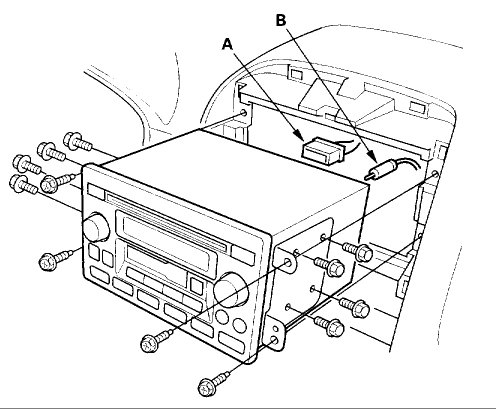

It's very possible that there is a short in the dash near the radio. Vibration could have worked the wiring harness on a sharp edge and ground through the insulation on the wires. Pull the radio out and look for bare wires.
Friday, October 6th, 2017 AT 7:14 PM
WHITNEY ROYSTER
  • 16 POSTS
Any diagram or directions on how to do that? I am such a novice. I suppose I could YouTube it. If bad wires, would I be able to replace/fix them?
Saturday, October 7th, 2017 AT 4:10 AM
STEVE W.
  • 15,111 POSTS

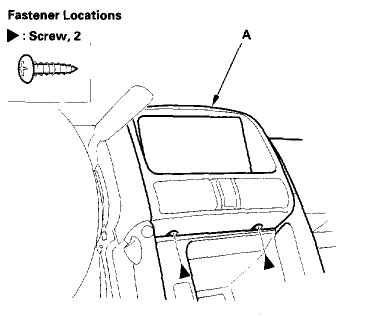

Got a saw? OH you want to do it without damage.
First make 100 percent sure you have the unlock code for the stereo. You will need it to make the stereo work when you put it back in. It will also wipe out the channel memory.
Once you have that you remove the center dash trim panel 2 screws and gently pull it away to free the connectors and remove the hazard switch connector. Then 4 screws let the stereo come out of the dash.
