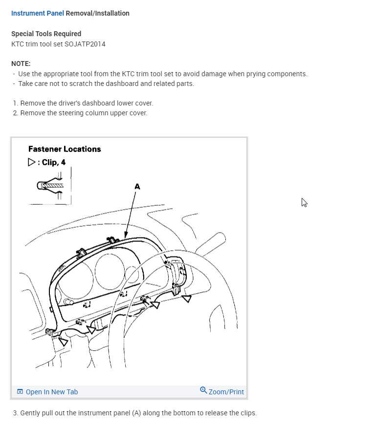

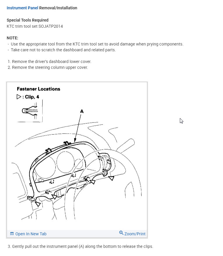

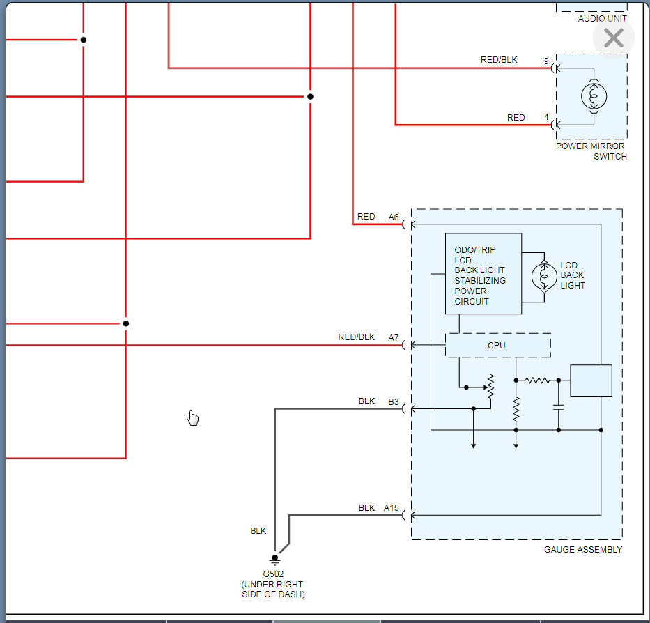

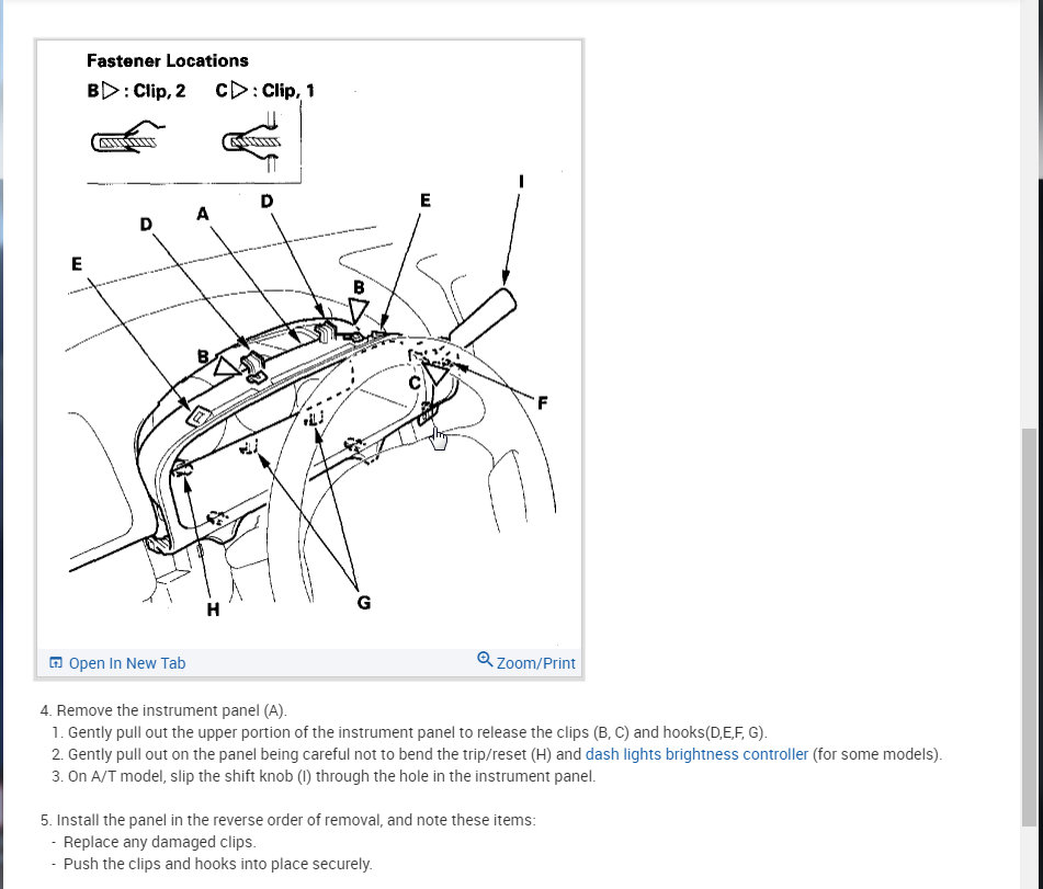

The only issue is it looks like the cluster is an LCD back light. I am not able to find if this is replaceable. If not then you will need to replace the cluster to fix it. However, I would pull the cluster out and see if you can access the bulb from behind it.

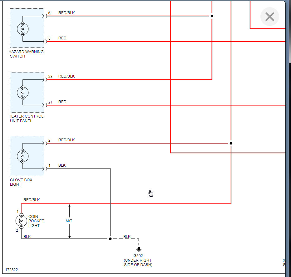

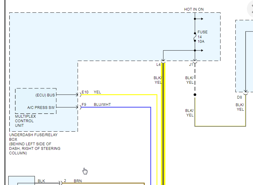

That's crazy how one low voltage LED short can screw up so many things. So testing these components individually, I should see if power's even getting there right? So for the climate control for example, I need to find a wiring diagram to see which terminal is power, then can I just hook up the car battery to the power terminal? I'm assuming no due to fuses and such.
Monday, August 3rd, 2020 AT 3:16 PM (Merged)

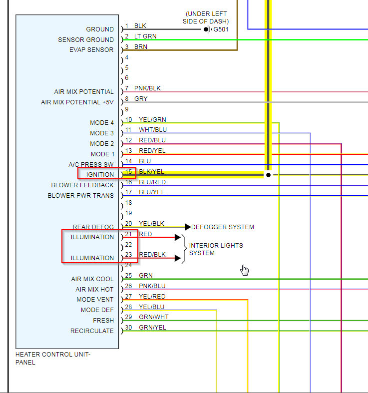

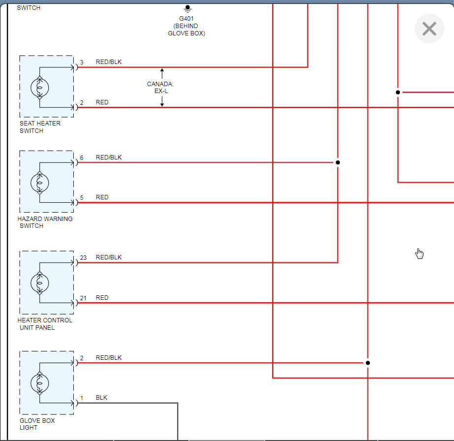

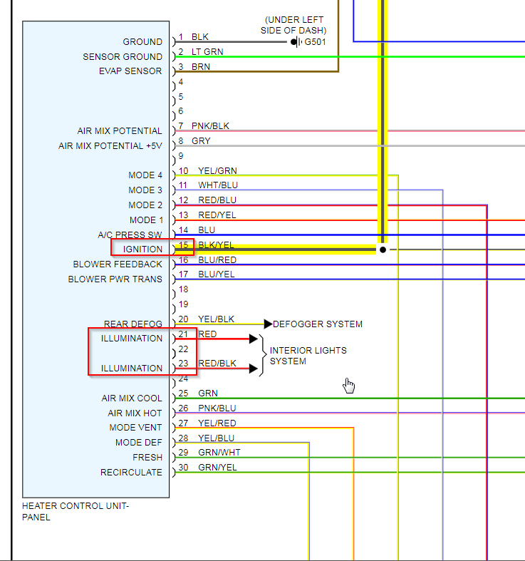

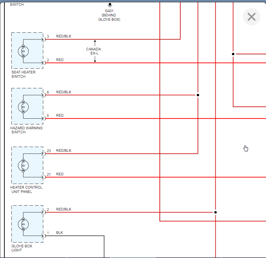

Yes. I included the diagram for the HVAC control panel. You want to see if you have 12 volts on the black/yellow wire. Do I understand correctly that the controls don't work or just the back lighting? If it is just the illumination doesn't work then check power on the Illumination circuits shown. If no power then we need to chase those. If you have power, then it is the unit.

Sorry for the delay I was out of town. Were you able to check the power on those illumination circuits that I supplied on the wiring diagram?
KYLE MENDES
  • 19 POSTS
So wherever there is a wire harness check to see if 12 volts is at the black and yellow port?

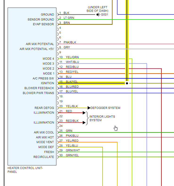

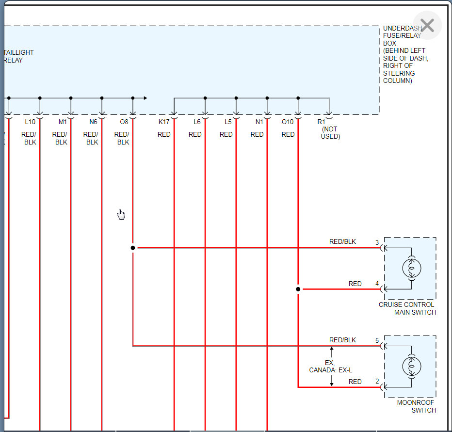

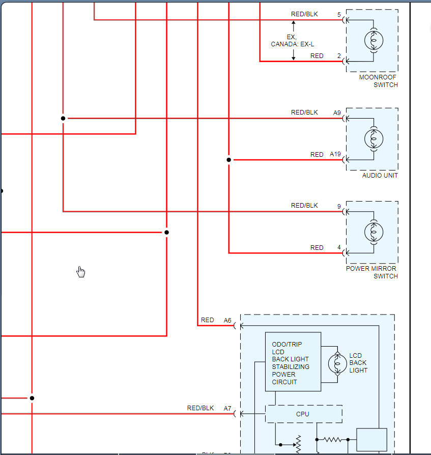

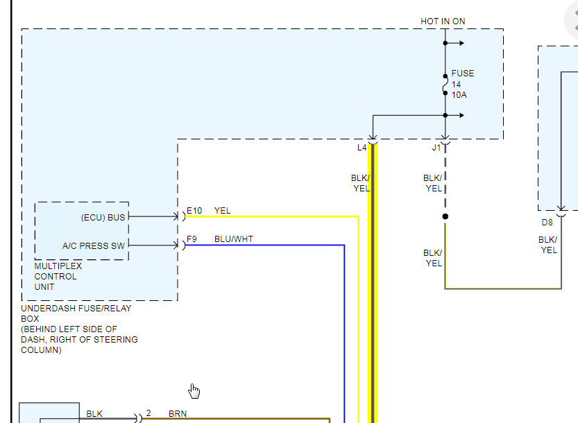

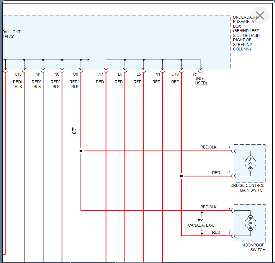

Well. The black and yellow wire is the ignition feed for the heater control which is what power the back lighting.
So if your issue is that the backlighting does not come on when the headlights are on then we need to check the ignition feed for power. If you have it then we need to test for power on the illumination circuits which for the HVAC control head are the Red and Red/Black wires.
Unfortunately these wire colors are probably going to be different for each module unless they share a splice.
Let's just turn the headlights on so that the backlighting should be on and test for voltage on these three wires. Let me know what it is and we can go from there. Thanks
KYLE MENDES
  • 19 POSTS

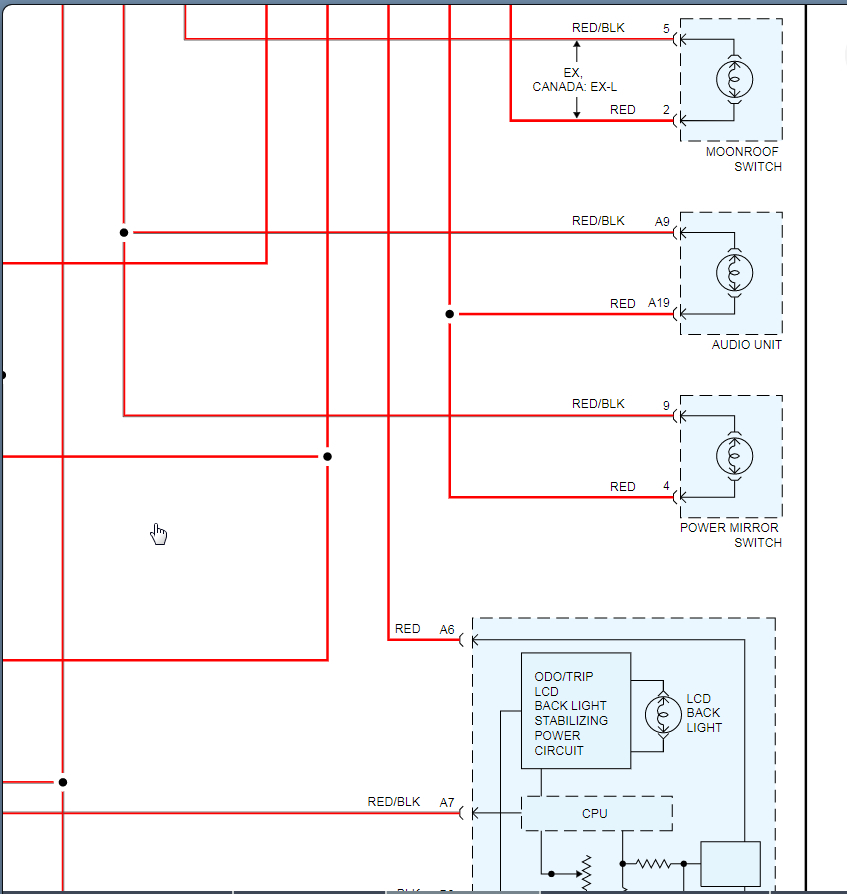

Finally got around to this. Been busy at work. So black/yellow, red, and red/black all have power. I had one terminal at the clip and the other on ground to measure.
KYLE MENDES
  • 19 POSTS

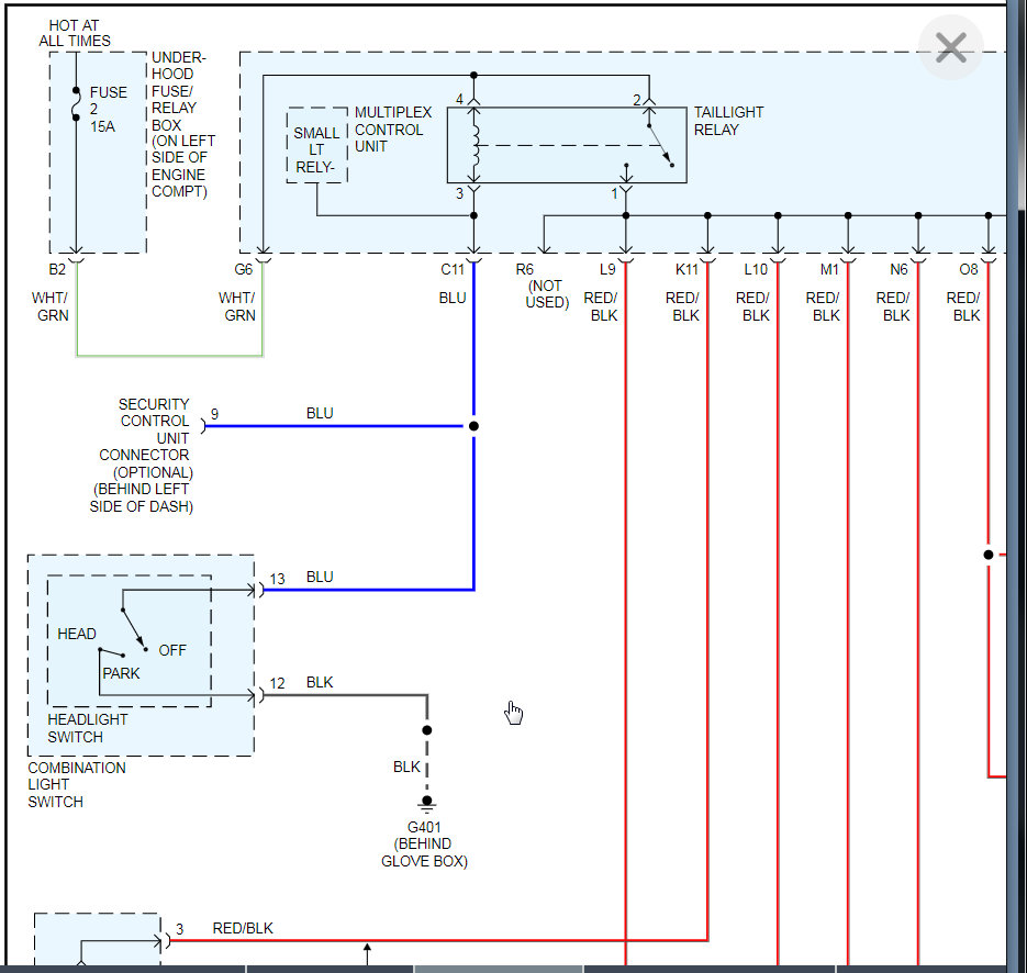

Okay, did more testing. On the dash clusters (two harnesses of A and B) B2 had only 6 volts, B1 had nothing. A6 had 4 volts, A7 was normal. Those were the only ones that seemed pertinent due to lighting circuits. These are on the chart listed a few posts up by me.
