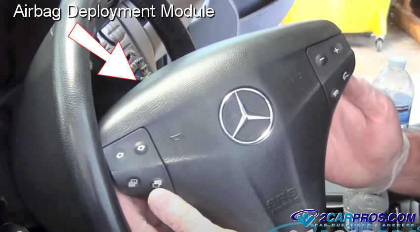

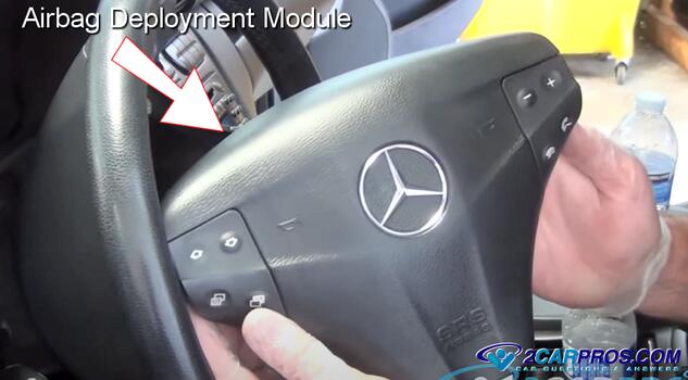

An airbag inflation module is located at the center of the steering wheel which contains the nylon style airbag and inflation capsule. The steering wheel airbag is contained within a trim cover which is designed with a molded seam which tears open as the airbag deploys.
driver side air bag
There are four or more impact sensors around the vehicle which send a signal to the main SRS (safety restraint system) computer in case of an accident. An electrical signal is then sent to discharge rapidly expanding gases through an orifice located at the rear of the airbag which immediately fills to instantly cushion the impact of the head and torso to prevent injury.

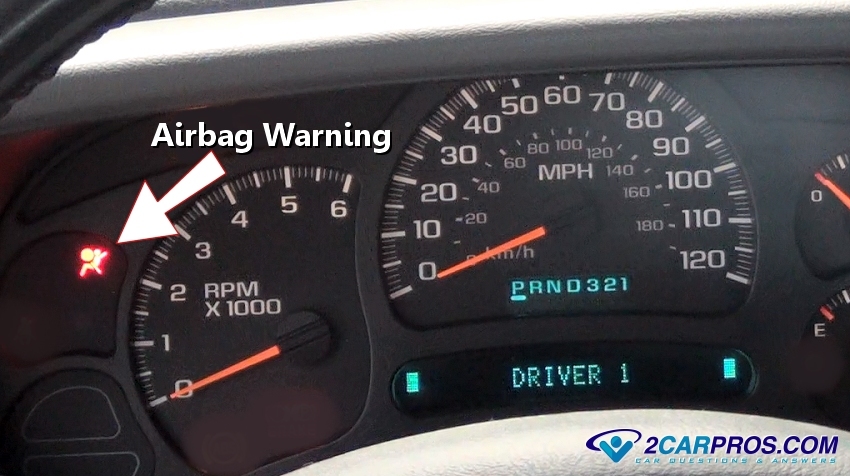

What Goes Wrong?
If an airbag warning light is on while driving the airbag safety system has been disabled and will not activate in the event of an accident which is dangerous. Your vehicle goes through a diagnostic check when the ignition key is turned on to ensure the system is operational. If the computer detects a problem it will shut down the system while illuminating the airbag warning light. This warning light will illuminate when:
  • The fuse is blown
  • One of the air bag connectors is still disconnected after a repair
  • The airbag safety module has detected a problem
  • An airbag has deployed
  • A sensor wring is damaged
  • Short in the wiring harness

Step 1: Remove the Airbag Mounting Bolts

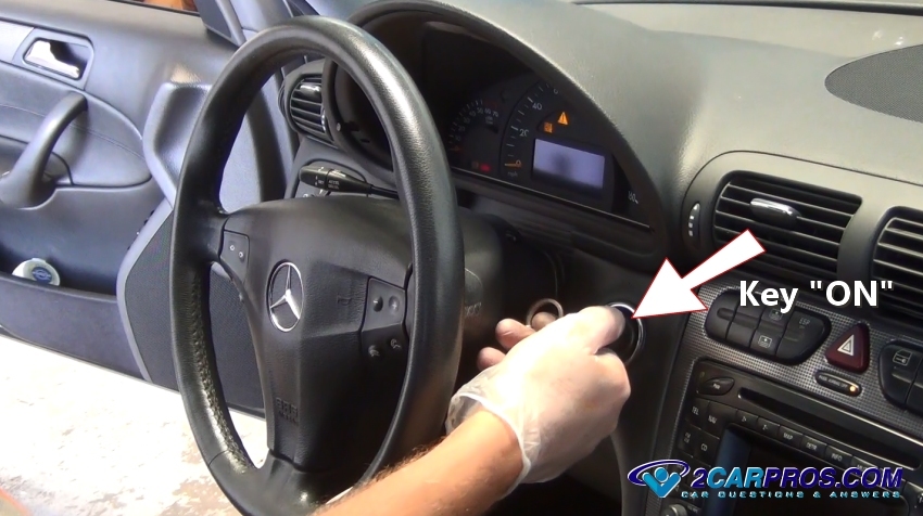

While the battery is disconnected turn the ignition switch to the on position. This will unlock the wheel and allow you to move it in either direction and help you access the mounting bolts or release clips (On Gm vehicles) which are located on the backside of the steering wheel cover.
turn ignition switch on

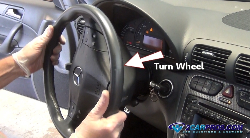

Now grasp the steering wheel and turn it 90° locating the first mounting bolt or clip upward.
turn steering wheel

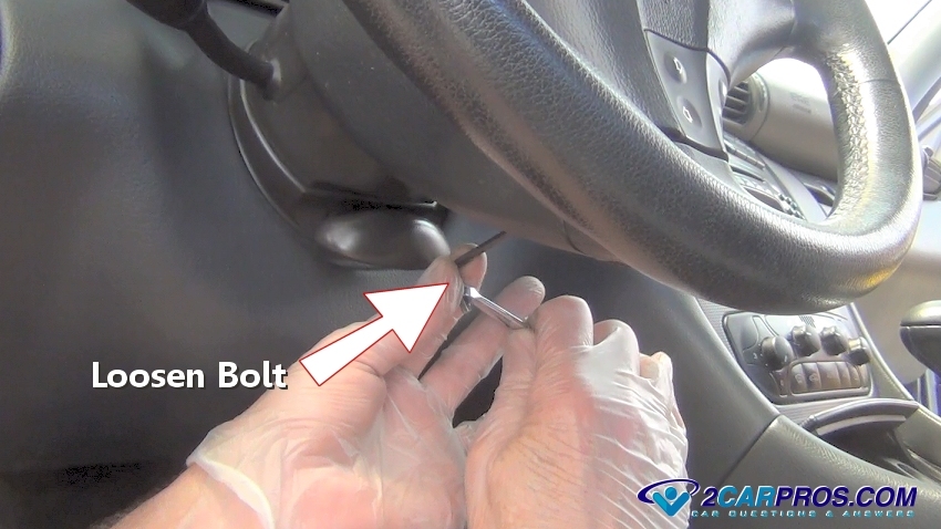

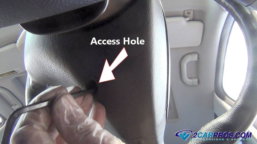

Look behind the steering wheel to find the access holes where the bolts are located. Some manufacturer's have slots which give access to a retainer clip or ring which requires a screwdriver to release.
steering wheel access hole

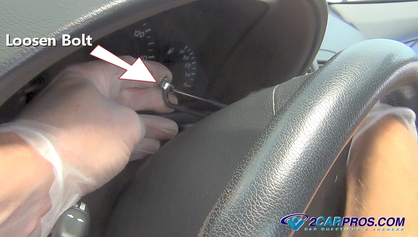

After locating the access hole loosen the mounting bolts or clips which will release one side of the airbag. For some applications the bolts will be retained in the wheel and will not come out which is normal.
remove air bag mounting bolt

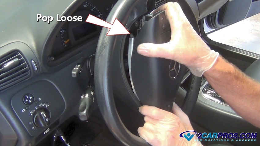

Once one side has been removed or released turn the steering wheel in the opposite direction 180°. Then locate and loosen or remove the opposing mounting bolt or retainer clip.
Gently grasp the assembly while pulling it away from the steering wheel. Be careful to not pull it out quickly because the wiring harness connector for the horn and deployment controls will still be attached to the backside which you don't want to damage.
pop airbag loose

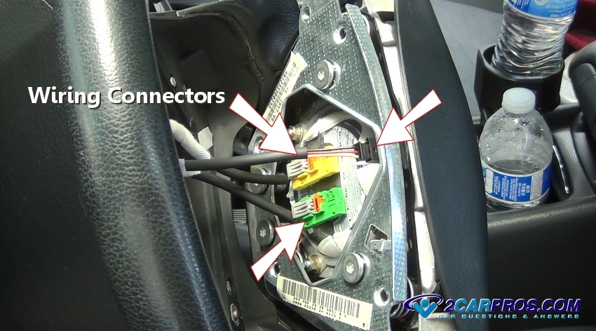

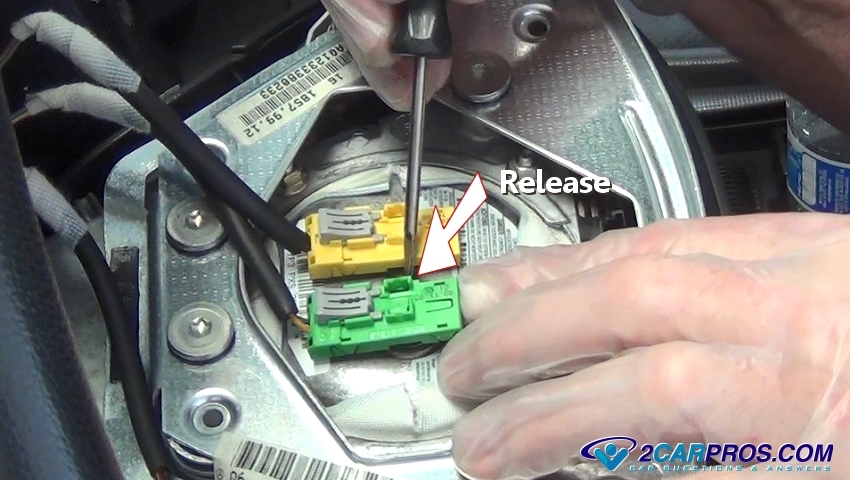

Step 2: Disconnect Wiring Connectors

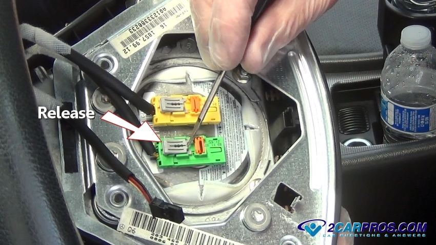

On the backside of the airbag will be the wiring connectors. These connectors are for the first and second stage deployment and are color coded one green and one yellow, the horn connector is black.
airbag wiring connectors

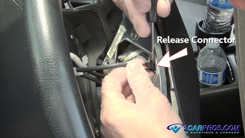

Using a small pick or screwdriver carefully release the horn pad connector and pull it away from the airbag. This safety clip is made of plastic so be gently as not to break it.
release horn pad connector

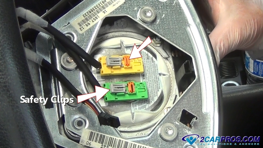

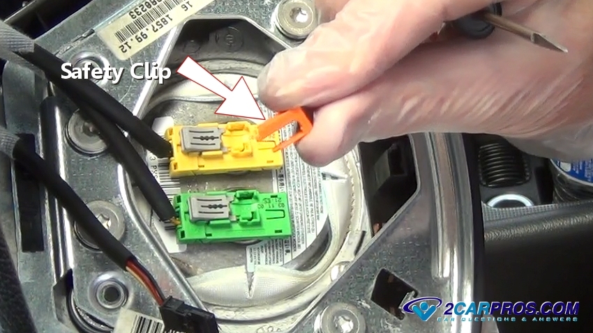

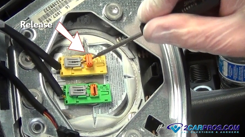

Wiring connectors can have one or more safety clips or operations to remove the connector. This connector has two separate devices one orange and one grey on each connector.
airbag safety clips
Use a small pick or screwdriver to release the primary safety clip by pushing it downward. Each manufacturer has a different method of release so push in all directions until it unlocks.
release aribag safety clip
Once the primary safety clip has been released gently pull up on the secondary clip. This will help you remove the clip from the connector.
release secondary airbag safety clip
After the clip has been released grasp it and remove it from the connector.

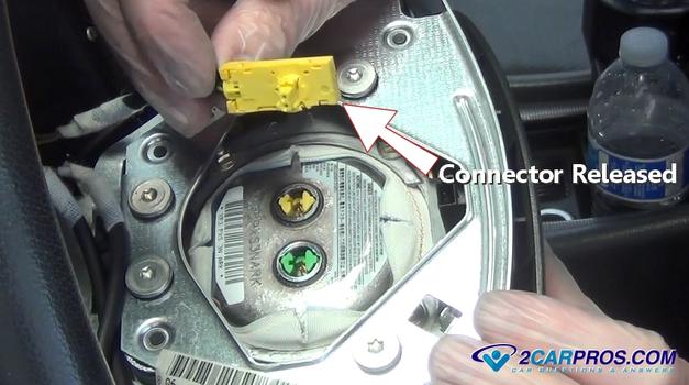

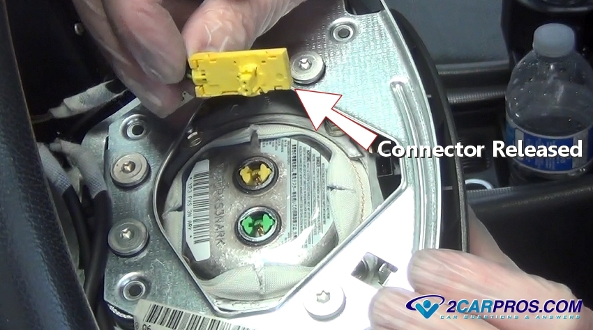

Now the connector is ready to be removed. While pulling up slightly use a small pick to release the tang (barb) on each side of the connector while gently pulling upward. You may need to gently rock the connector back and fourth a little to aid in its disconnection.
release airbag mounting clip
The connector will now be removed, inspect it for damage or corrosion.
airbag-electrical-connector-released

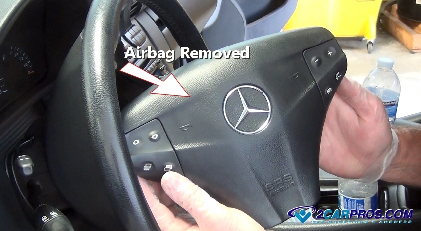

Step 3: Removing the Airbag
After removing the electrical connectors inspect the control switches and horn pad for damage. If replacing the unit because of deployment inspect and match the electrical connectors, they should be identical. Once repairs are completed such as removing the steering wheel to replace the turn signal switch, cruise control or ignition switch simply reinstall the airbag by reversing these steps. Most electrical connectors produce an audible click to confirm their proper installation.
After the repair is complete turn the ignition key to the on position and start the engine to straighten the steering wheel, the airbag warning light should be off. If when the repair is complete and the light is on disassemble to check the connections.
airbag removed
