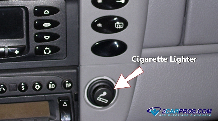

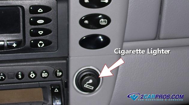

3. Check the cigarette lighters in both front and rear passenger compartments to see if the lighter itself is stuck down which is usually accompanied by a fair amount of heat, pull the lighter upward to stop the electrical draw, in this case the lighter has gone bad and needs replacement.

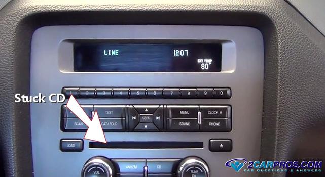

4. When you shut the ignition key off the radio turns off as well, this is not true for the CD player and changer. If a CD gets stuck in the load or eject position it will continue to work the small motor inside the player while draining the electrical system. With the key off listen closely to the player, if you hear a motor running a CD is stuck. Try to work the CD either in or out using a small tweezers or flat blade screwdriver. If you cannot retrieve the CD, pull out the radio fuse until you can replace the unit or have it repaired, this will stop the battery draw.

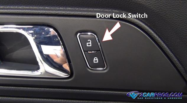

5. The door lock switch is constantly hot or live with electrical power. Sometimes the control switch will get gummed up with dirt or soda which makes the switch stick in the lock or unlock position. This will force the lock actuator in the door to stay on which will draw the battery down. Inspect the lock switch to make sure it returns to its neutral position. If this switch is broken or permanently stuck, replacement is required.

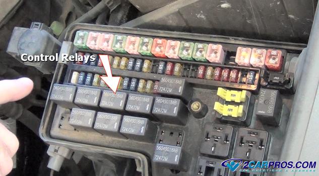

9. A control relay is a small electrical component that turns on and off larger items such as a fuel pump or an air conditioning compressor. When a relay goes bad they can "stick" causing the component to stay on even when the key is off. Locate the under hood and interior fuse and relay panels and remove their covers. Next, touch each relay to check for heat, if a relay is found remove and replace it with a new relay.

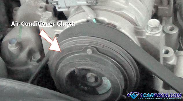

11. An air conditioner clutch is common to create a battery draw due to a stuck relay, to see if this is your problem place your hand on the front of the compressor to check for heat.

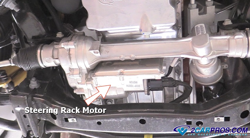

12. A steering rack is powered by an electric motor which is controlled by a relay or module, either should be cool to the touch.
