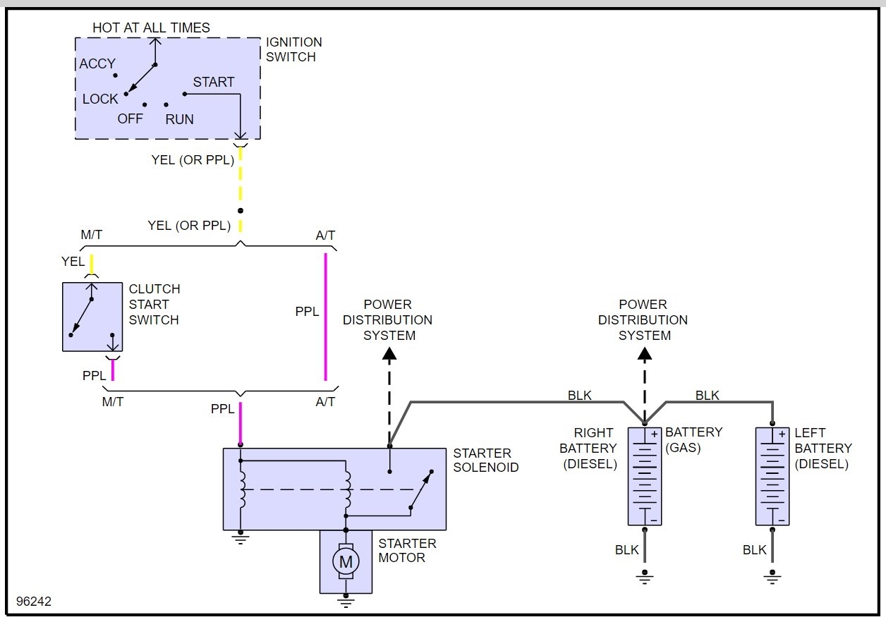

The original diagram is almost impossible to interpret due to the bizarre way the ignition switch is drawn. I cannot find any reference to the neutral safety switch on the wiring diagram, but it is listed as being in one of two locations, either at the base of the steering column, or on the side of the transmission.
As best I can tell, if you go to the ignition switch, you should see a purple wire and two red wires. The purple goes to the starter solenoid. One of the red wires comes from or goes to the fuse box. Check if you have twelve volts on those red wires. I am still looking for where the neutral safety switch is in the circuit.

You do have an automatic transmission, right? I will be back tomorrow to see how you are doing. I am going to try to find a different diagram. I do not see this on the diagram I have now, but from memory, a lot of wiring harnesses are made for use with an automatic or manual transmission. When a manual is used, there is usually a clutch switch so that pedal has to be pressed before the starter will work. When an automatic is used, a short jumper harness is plugged in, in place of that switch. Look in front of where the clutch pedal would be and see if there is a two-wire connector with a short loop of wire in it. If you see that, tell me the colors of the wires going to it.

I found this wiring diagram for you, please use a test light to see if you are losing power somewhere.

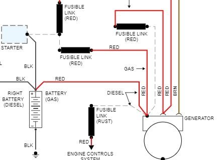

So I did quite a bit of work to my Chevrolet c20 because it blew a head gasket. So I replaced a bunch of stuff on it since I had it torn apart. It has new spark plugs, new spark plug wires, new exhaust, new head and a new intake and a new starter. Whenever I went to go hook up my starter hooked it up to the alternator and tried turning it over and it just clicked once. So one up online and was like well maybe I connected it wrong. So I saw that the positive cable supposed to run to the starter so I ran it through the starter tried cranking it and no crank no start not even a click. So I have two questions, one is does the positive cable from the battery go to the alternator or to the starter? Second question is, what else can cause it to not turn over?
Thursday, September 3rd, 2020 AT 5:30 PM (Merged)
  • 110,192 POSTS
Welcome to 2CarPros.

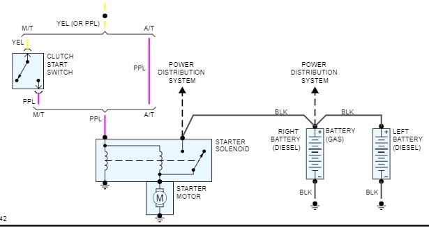

The positive on the battery runs to the starter (The larger bolt). From there, power is run via a fusible link to the alternator. There should be another smaller wire running to the starter solenoid which only gets power when the key is in the start position.
First, the schematics I have attached are for both a gas and diesel model and show variations based on what you have. However, if you look at picture 1, it shows power going from the battery to the starter and then there is a broken line that takes it to the alternator. Follow the black wire from battery to the starter and then the dash line to a red fusible link which goes to the alternator.
The second picture shows the starter. Power goes to the larger bolt from the battery. It is hot at all times. The small purple wire goes to the solenoid also, but to the smaller bolt. That is hot only when the key is in the start position.
With all of that in mind, if you ran power only to the alternator, power would have gone through a fusible link between the starter and alternator. I can almost guarantee that is fried, so you will have to check it for continuity. If there isn't continuity, replace it with another fusible link of the same gauge.
Here are a few links you may find helpful. One discusses how to replace a starter. I realize you have already done that, but it shows how the wires are installed. The next discusses if the starter won't engage. It shows how to check it. The remaining are related to electrical testing.
Let me know if this helps. Also, if you have questions about the pics, let me know. The one showing the alternator is confusing because it shows both set ups.
