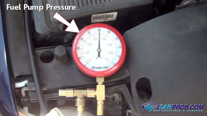

2. The #1 reason for an engine backfire through the intake manifold will happen under load or acceleration. The engine needs fuel to burn along with the air the engine is processing. Internal combustion engines run on a mixture of 14 to 1 which is fourteen parts air to one part fuel and when this is not correct (not enough fuel) the result will be a backfire. The most common cause for this problem is a weak fuel pump or clogged fuel filters which will cause a lack of fuel being delivered to the engine.
If you suspect this might be the problem test the fuel pump pressure which you can rent a gauge from the auto parts store for cheap. Also, if your car has a fuel filter change it out first.
fuel pressure gauge

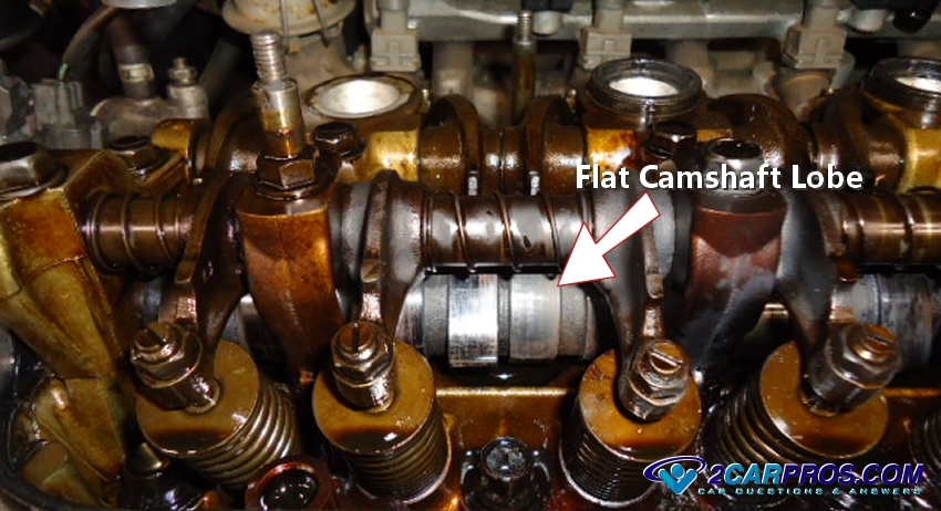

2. A camshaft is used to open the intake and exhaust valves of the combustion chamber to allow intake air in and the spent exhaust gases out. If the exhaust valve lobe becomes worn and loses its lift, the fire from the exhaust gases are still left inside the cylinder which is then released into the intake manifold once the intake valve reopens. To check for this condition you must first remove the valve cover(s).
After the valve covers have been removed, and with the ignition disabled (coils off) crank the engine over and observe the intake and exhaust valve operation, opening and closing. Also, if the intake or exhaust valves are not closing completely due to a broken valve spring it will allow the combustion gases to enter the intake manifold much like a flat camshaft lobe. Use a flashlight in carefully check the valve spring windings, these springs can break either at the top middle or bottom of the spring which can be sometimes be difficult to see.
A bent push rod can also cause the valve not to work properly by restricting the movement of the valve. While the valve cover is still removed look at each of the pushrods to see if there is an obvious bend to them. This also can be done by detecting poor rocker arm movement while the engine is being cranked over.
flat camshaft lobe
